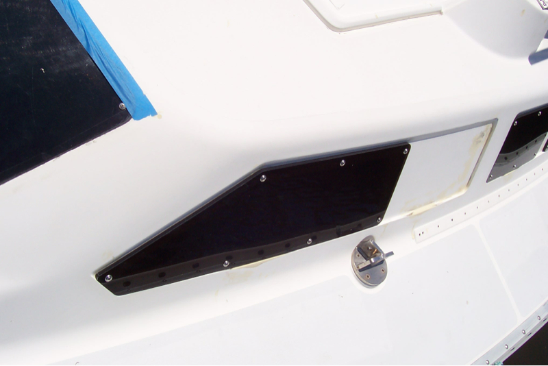

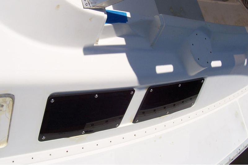

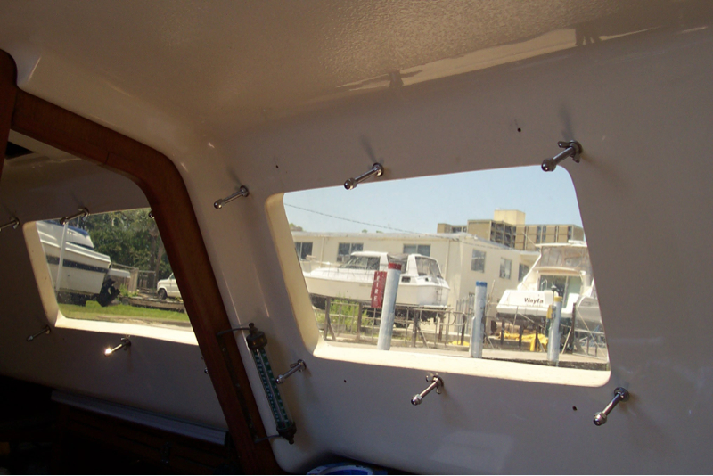

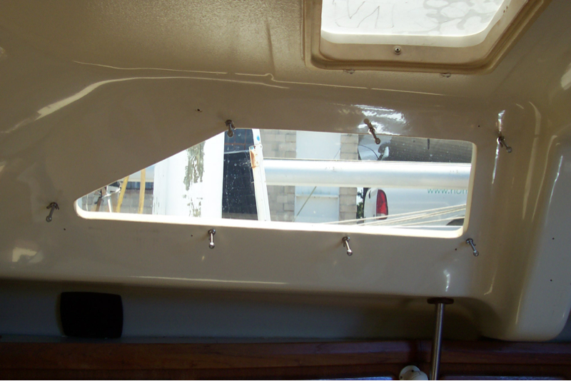

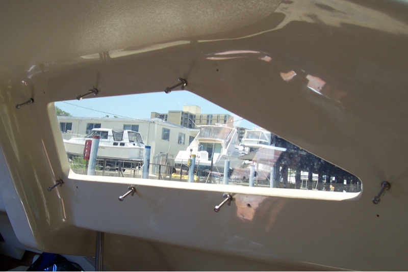

Hey Tom, I replaced all my windows three years ago and did it a little differently. I noticed that all the screws holding in the bronze plexi were stripped out and really holding nothing. The windows had been caulked too many times to count and being a southern boat the sun had really crazed the plastic. So, I dug out the windows, because the dark plexi gets too hot and has a horrible expansion rate, I split the main windshield into two parts and made the side windows shorter where possible. This relieves some of the stress, but the other thing I did was drill the screws through into the interior and used wing nuts to secure them. I used gasket material instead of caulking because the caulk obviously wasn't working very well. So far I'm very happy with the decision. All the main windows can be popped out easily and removed. I didn't pre-curve the main wind screen or any other parts, just bolted them down tight after letting them get hot with the sun and they take up the curve of the hull nicely. Being from Ann Arbor originally I know getting hot by the sun is only available in July so better hurry. If you have any Questions, be glad to answer them. I cut out the side windows with a computerized router but did the main wind screen by hand using the original as a pattern which was actually easier than I thought it would be. I will try to include some pics. I'll get pics of main screen when I get back to the boat.

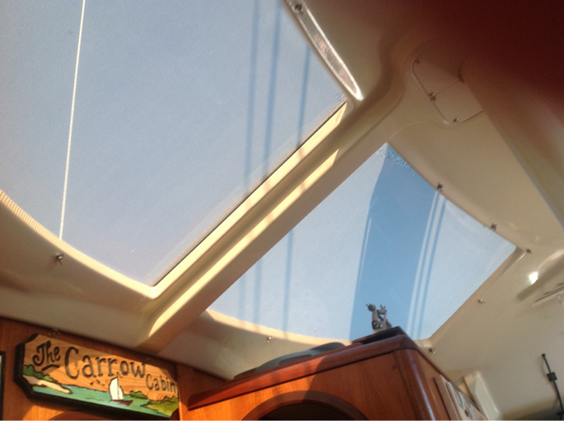

Tom, found a couple more pics on my Ipad. This shows the center piece that I put to protect the area between the newly two piece main windscreen. The white coating is perforated vinyl like they print on for the windows of a wrapped vehicle, keeps the windows nice and cool and as you can see you can see out unimpeded but not in during the day. At night you can only see in if the lights are on inside and you are looking straight in not at an angle. Jim Becker
