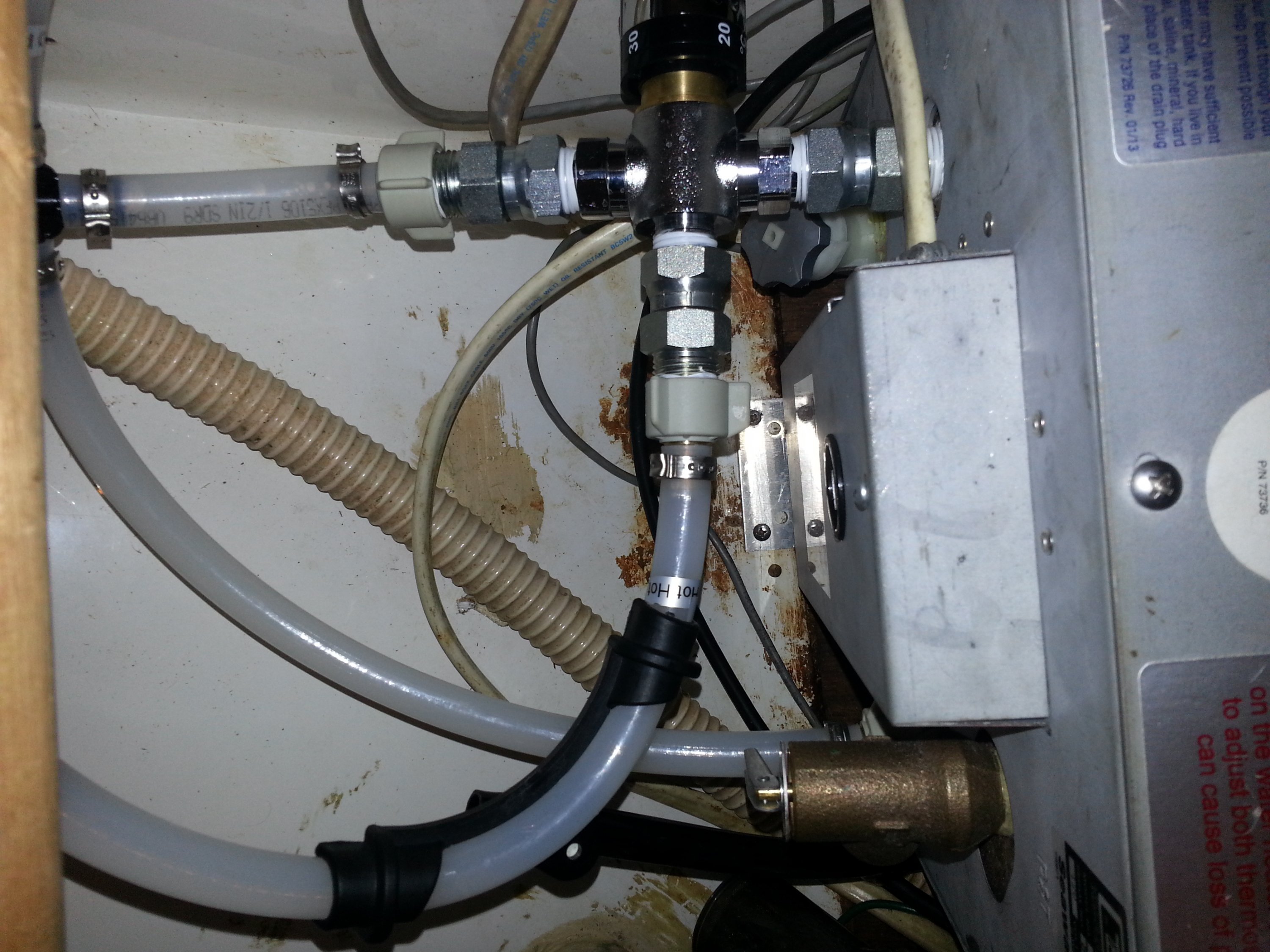

I finally upgraded my water heater after reading the posts from Mainsail, Stu, et. al. to a safer system. As you all have no doubt discovered the hard way, the water that comes out of the tap after using the engine to heat it is really HOT. I find this out every time I leave the handle set from when the water was heated using the electric option and then turn it on at the same setting after motoring.
I found my mixing valve on Amazon here:
https://www.amazon.com/gp/product/B00SYC1IV6/ref=oh_aui_detailpage_o03_s00?ie=UTF8&psc=1

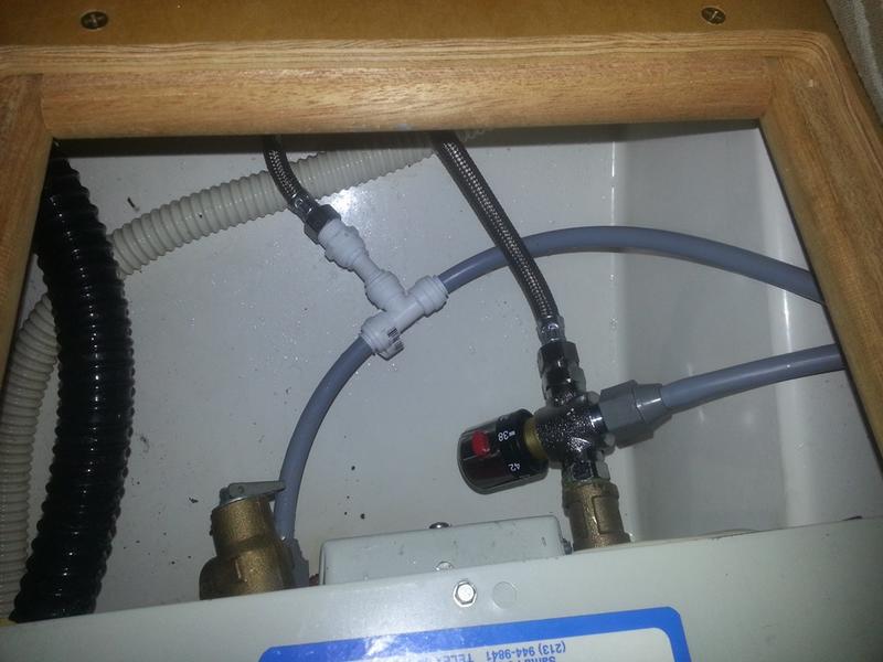

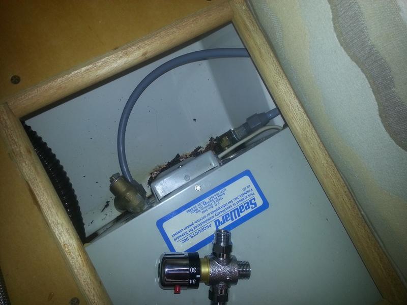

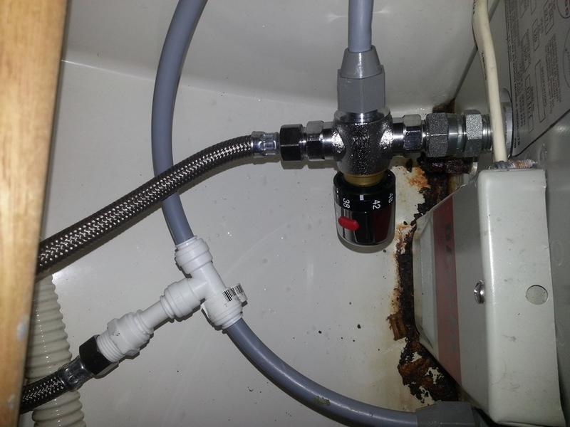

It was pretty easy to install, although it is all 1/2" NPS (straight threads), so you get the classic thread mismatch we are all familiar with when an improper seacock valve is mated with the through hull. In my first attempt I removed the hot water output line and fittings to be replaced with a short brass nipple and coupling. The junction of the new valve and the coupling leaked even with some pipe dope, so I went with plan B. I found at the local plumbing supply house an adapter that is 1/2" NPT (tapered) for the water heater side and a 1/2" female for the mixing valve ($4.25). Voila, no more leaks. I relocated the hot line to the mix junction and installed a push on Tee with male adapter cut into the existing cold water feed line with a braided supply line to the cold input of the new valve.
The test was to set the valve at 40 C (110 F) and heat the contents with shore power. Sure enough, with the galley faucet set at max hot, I got 110 F water. Then we motored for a couple of hours knowing the water in the tank would be scalding. I turned it on full hot and it was exactly 110 F. Just like it was supposed to be.
This was an easy project if you don't mind some water running down into the bilge while swapping and cutting lines. The pictures show the first attempt with the leaking coupling, then the final installation with the adapter.
And I have cleaned up the rust flakes that occurred from a previously unnoticed leak that ate up the mounting foot. :redface:

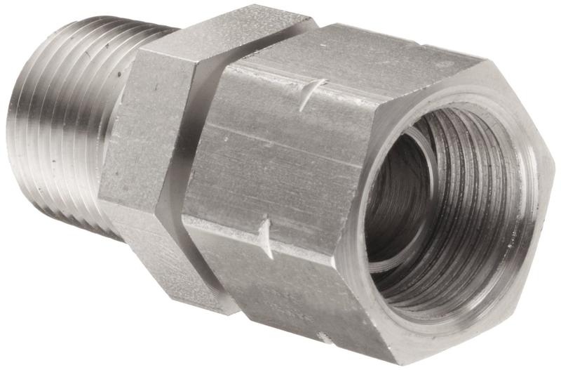

Hi Allan... I am unable to find the adapter for the Mixing Valve anywhere. Could you please let me know where you obtained them. Thanks -Jon
1,715
Hunter 34 Alameda CA
Jon,
Well I guess when we trade houses and boats you will have to go down to Royal Brass here in San Jose and pick one up. Or better, I'll have to bring it with me. :D:D
This is a part that should be available at hydraulic line supply outfits. Its actually quite common I believe once you know where to look. And believe me it took a while for me to figure out where to look.
There is a place in Cape Coral (is that near you?) called West Coast Hydraulic (239-634-3953) that might have what you need, but they don't seem to be open on weekends.
Here is a link that you can use when you shop around for the part.
http://www.royalsupply.com/store/pc/Hydraulic-Fitting-1404-08-08-1-2-MP-1-2-FPS-Straight-p54351.htm
I hope this helps.
Allan

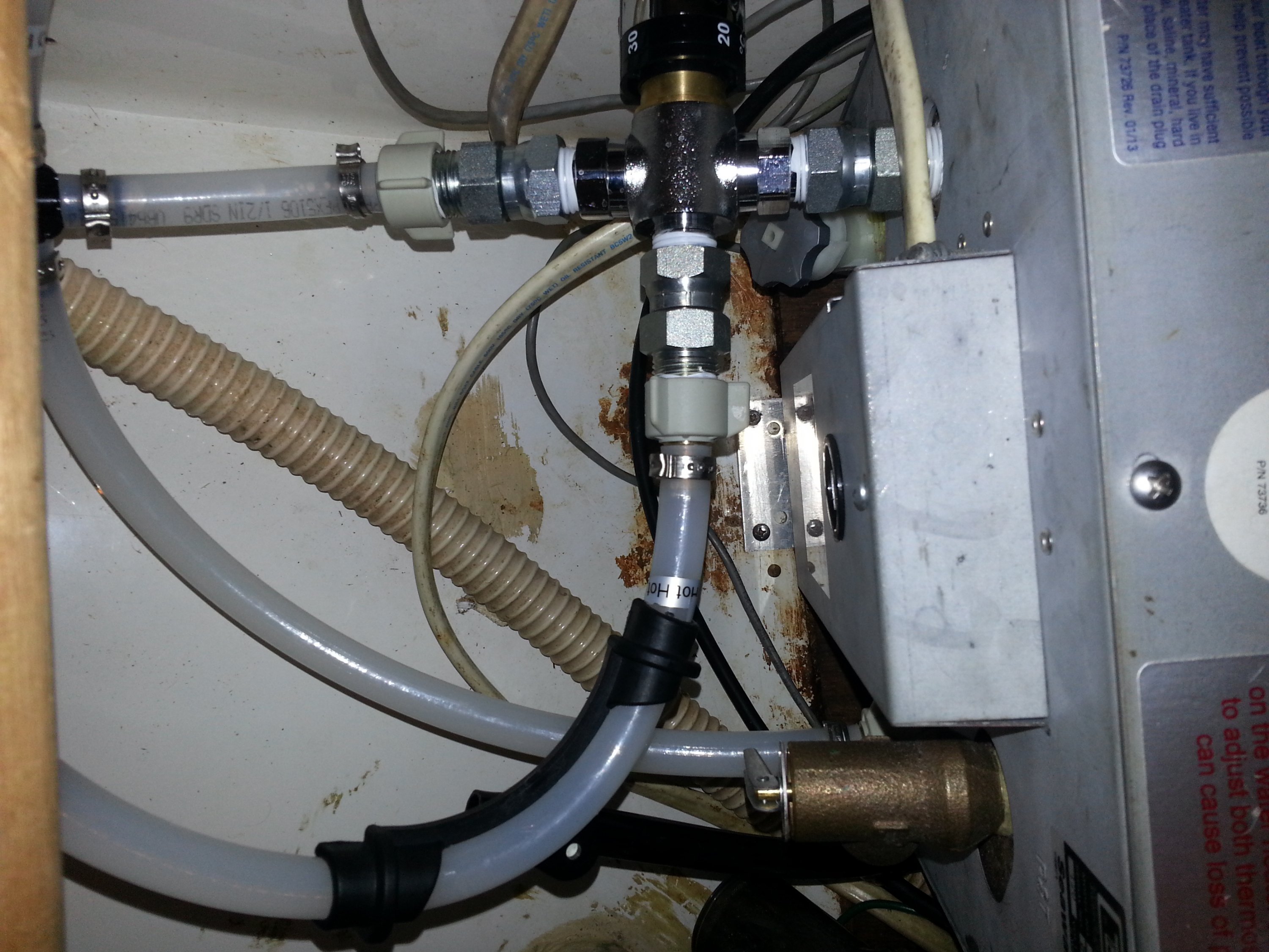

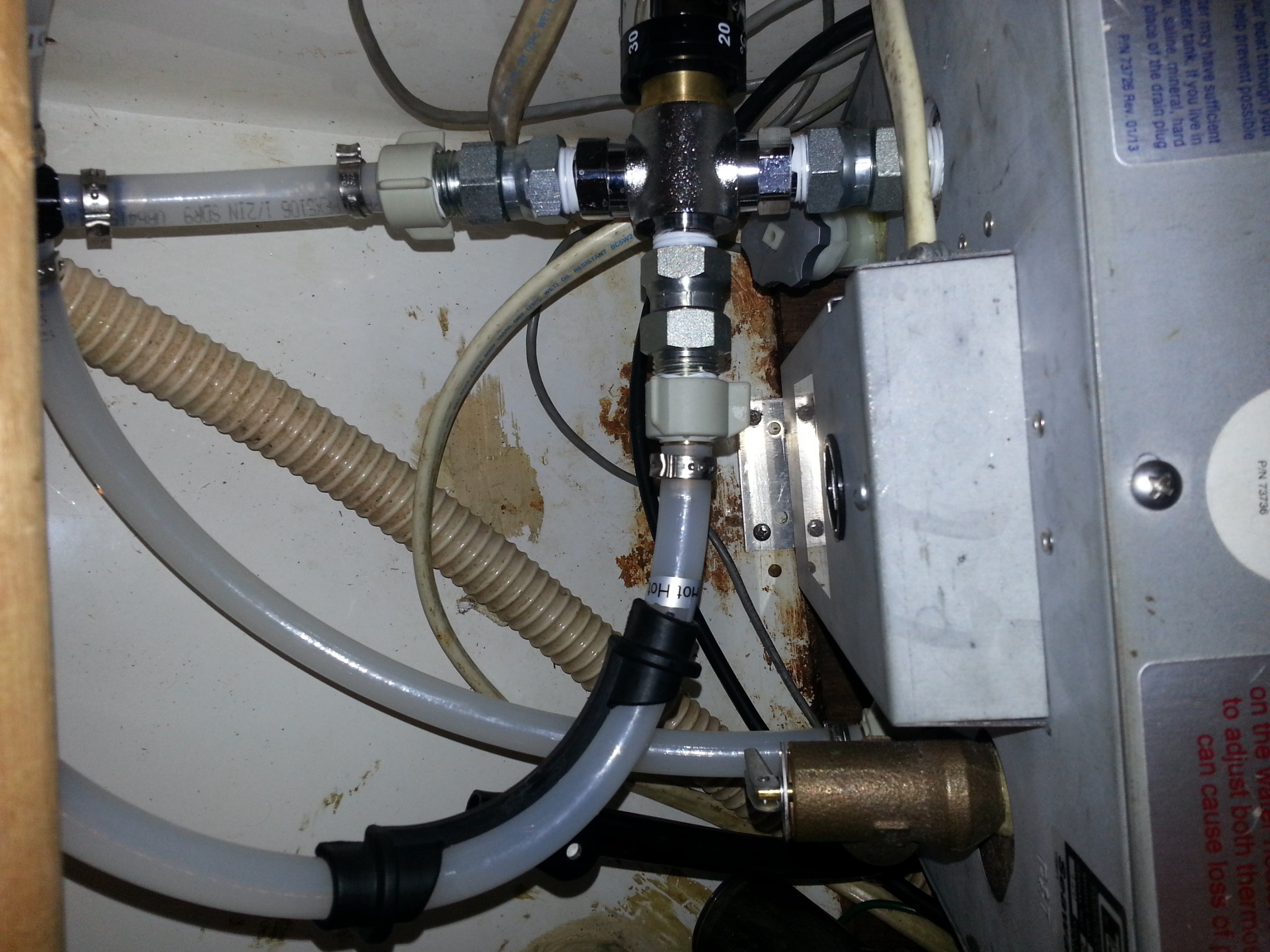

PS Here is a picture of it... Note I needed additional fittings to match the threads...... -Jon
Aug 17, 2010
208
Hunter 410 Dover NH
Thanks Jon I was wondering about the adapter to go from the tank to the mix valve.
Thanks
PGIJon
Mar 3, 2012
856
Hunter 34 Punta Gorda
About 2 years... No issues yet, I did use teflon tape to try and isolate the metals... but I'm sure they must be touching somewhere unseeable....
