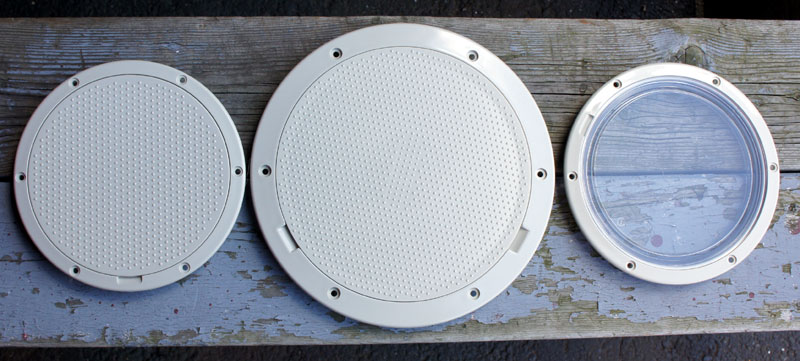

1,090
How about something like this (on the right) mounted in the cockpit floor above the fuel tank gauge?
Likes: BlowMeAway

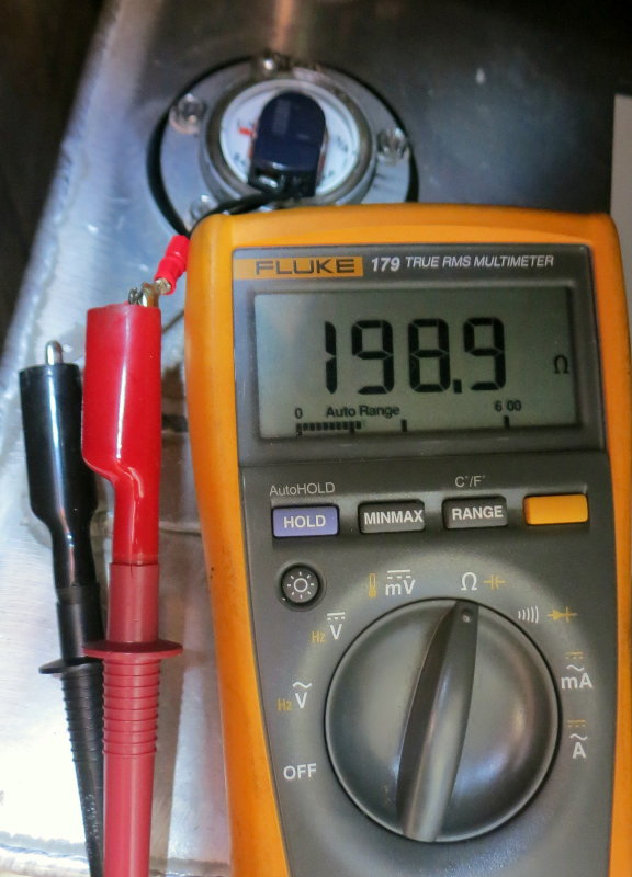

If the fuel gauge is a mechanical one similar to the one in the back ground of this photo simply purchase the "Electronic Conversion Capsule" and add a remote 12V fuel gauge....
This converts most mechanical senders into mechanical and electronic.
Likes: BlowMeAway
