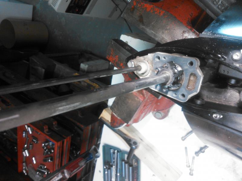

Project is done, about 2 hours, not at all quick and easy.
The shift linkage clamp was different from the video and a real pita to get reassembled with the bottom unit pushed back up. I am also glad I photographed the old impellor as soon as it was revealed so I could remember how to bend the vanes.
Having to do that surprised me, I thought bent vanes just a result of wear, not fitting tightly in the cup. I ended up putting the impellor in the chrome cup (vanes bent around) then sliding the cup into the pump housing , then onto the shaft. Held the pin with needlenose pliers while I slid the impeller down home.
the most aggravation was getting the bottom back in and dealing with clamp that wanted to fall down into the bottom while I`m trying to get it over both rods and tightened down.
Did rope pull tests when assemble all appears ok, I`ll know for sure when it go`s in the water barrel in the backyard in March
