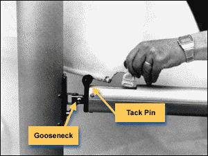

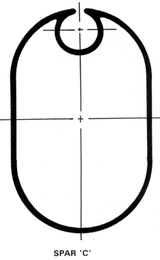

It almost certainly does, and definitely should. There should be a track that runs along the top of the boom (a slit really). The sail will (should) have a rope sewn into the foot (bottom) of the sail. This feeds into the track. There may also be a little plastic slug that also feeds into that track.

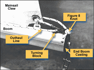

The attachment point at the clew (the back corner) is really just for the outhaul. It's not meant to hold the sail onto the boom really. It is more to stretch the sail out along the boom. (You can adjust this tension according to conditions for performance reasons.)

Are you sure? If the sail has a bolt rope sewn into the foot of the sail and the boom has a groove, the bolt rope probably feeds into the groove.
You attach it by feeding the clew (back corner) of the sail into the groove starting at the end of the boom closest to the mast. You then continue feeding the bolt rope into the groove as you pull the clew toward the end of the boom. Is there some reason it won't do this?

If your sail has a 'bolt rope' at the bottom and your boom has a 'groove' along the top edge, thread the bolt rope through the groove. It works just like the bolt rope in the 'luff' (the leading edge of the mainsail) that slides into the groove in the mast.
