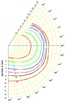

Franklin .... simply look at your (or any) boat's 'polar diagram'. You can sit there with your boat's centerline pointing directly into the true wind, and with the sail 'stalled'/not working except for the leech giving a wee bit of drive .... doesnt prove anything. There's a very fine line between 'pointing' and pinching.

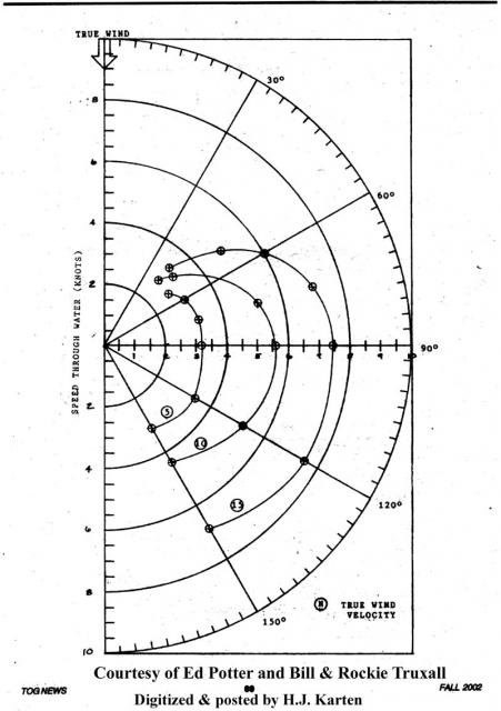

And if you want to use polar diagrams, then look at the one I posted for the HannaMaria in the link. The diagram says it can do 5 knots just 30 degrees off true wind with a wind in the range of 13 knots to 17 knots of wind. The diagram also says that the boat can only get to about 40 degrees off of true wind and reach 5 knots with winds between 6 knots and 10 knots.
So, the polars say it and the true wind calculator says it. What more facts do you need?
