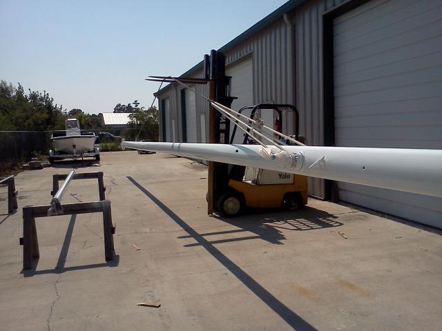

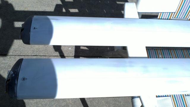

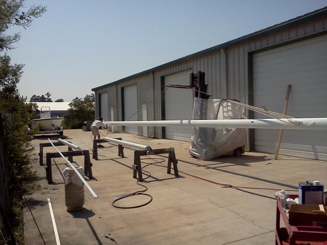

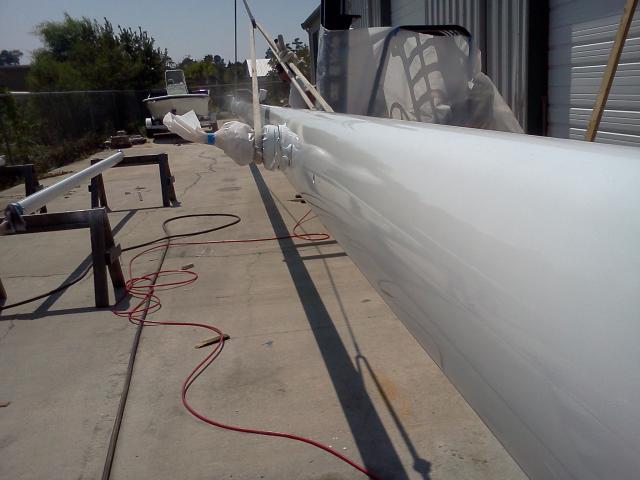

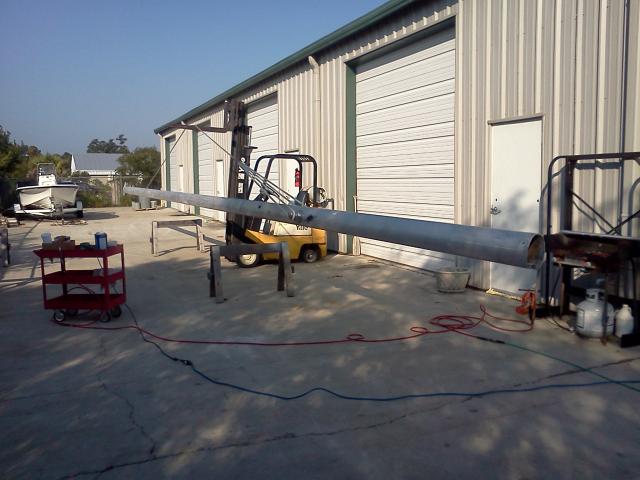

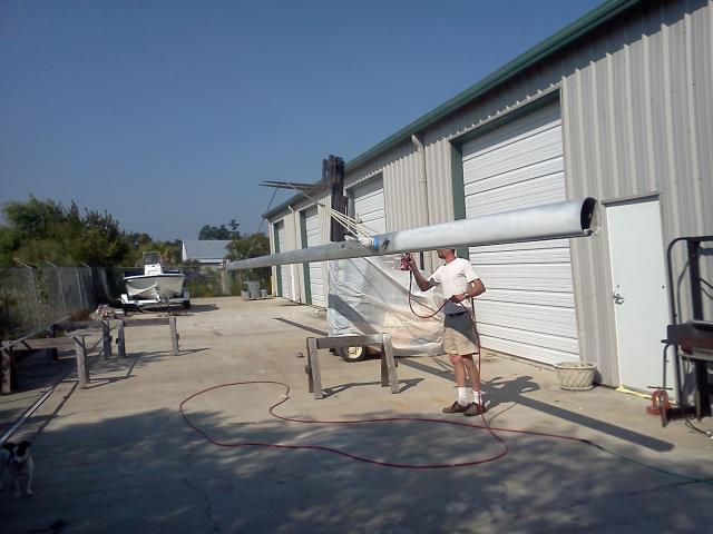

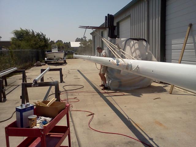

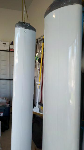

Finally a nice day without scorching heat or buckets of rain. Goodby Irene. After moving the paint day several times, the forecast was for a clear Sunday in the aftermath of Hurican Irene. By Friday it was clear it was not going to land in S.C. so we made plans for Sunday morning. Busy, busy day. First a good scuff all over, then aluminum primer, then filler touch ups, a wipe and a blow, then primer tinted white, then lunch. A good wet sand with 400, a wipe and a blow. Then 2 coats of white Dupont 2 K Urethane, wet on wet. Finished about 4, just in time to let it dry before the night dew gets on it. Looks great. Now it is time to get it all back together. If I could only remember where I stored all the parts!
