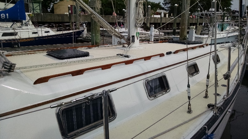

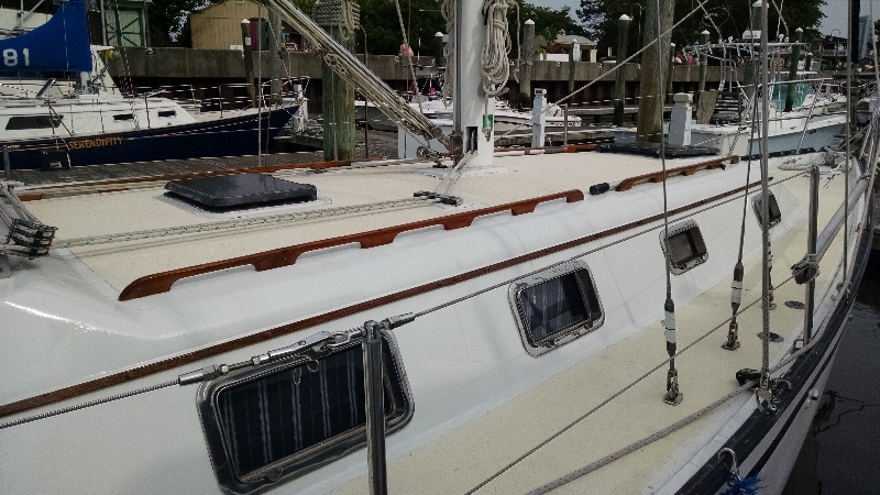

Just removed Trinity's cabin top rails and eyebrow trims.
Refinished rails (sanded and varnished) reinstalled same.
Discarded eyebrow rims, yes they were worn out.
Made new mahogany trims in my shop, full 3/4" wide by light 5/8" thick
varnished and sanded, re-bed and screwed to cabin side. Going to boat today to set mahogany plugs, will trim and varnish same tomorrow if the weather is right. Trinity looks beautiful with new trims. Will send a picture next week.
Trinity Molding work, plugs not trimmed yet but set

Every boat owner has their own preferences. Mine when I bought my 1980 Cherubini Hunter 36 was not to disturb the wonderfully classic Cherbuni lines. But I would modify (where easy) to a more modern appearance that would also minimize the chore of doing the brightwork every year or two. In my case, the smooth gel coat on the cabin top of my "new" boat had oxidized in places to reveal the FRP layup base. So a repaint was in order. (My choice was Interlux Perfection 2- part polyurethane.) The eyebrows needed to be removed in the process. Standing back, I realized that I liked the lines better without them. Less clutter and more open. Reinstalling them added nothing for me but more annual chores to maintain. I've attached a picture or two of the current appearance.
If your cabin top smooth gelcoat is still good, my suggestion would be remove the teak eyebrows. Scrape any remaining caulk away from the gelcoat. Use oxcylic acid to remove the years of tannin stains underneath. Do the "Maine Sail" compound thing to restore the smooth gelcoat to a clean luster. Wad up some white paper towels to shove into the screw holes to temporarily camouflage them. Stand back and look. If you like the look of no eyebrows, then using a syringe (to keep it neat), fill the holes with thickened epoxy, or thinned white epoxy putty. Fair flush with the gelcoat with a razor blade once the epoxy sets, but is still flexible. Hand sand/fair again after fully cured. Then just dab on some polyurethane white paint over the filled holes tinted to match the color of the gelcoat.
No one but you will ever notice that the eyebrow was ever there!
