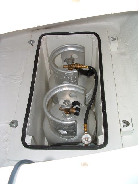

We did it. $1000 is probably realistic. I don't remember what ours was but that's probably close. I built my own vented boxes that used dead space but we splurged for aluminum tanks. The conversion wasn't difficult but it was tedious.
Our old Seaward stove didn't have thermocouples on the stovetop burners to begin with so we rely on common sense and a hope that we're on the right side of the Darwin curve. Seaward provided a kit with all the parts for the conversion for the stove. They were pretty helpful on the phone.
