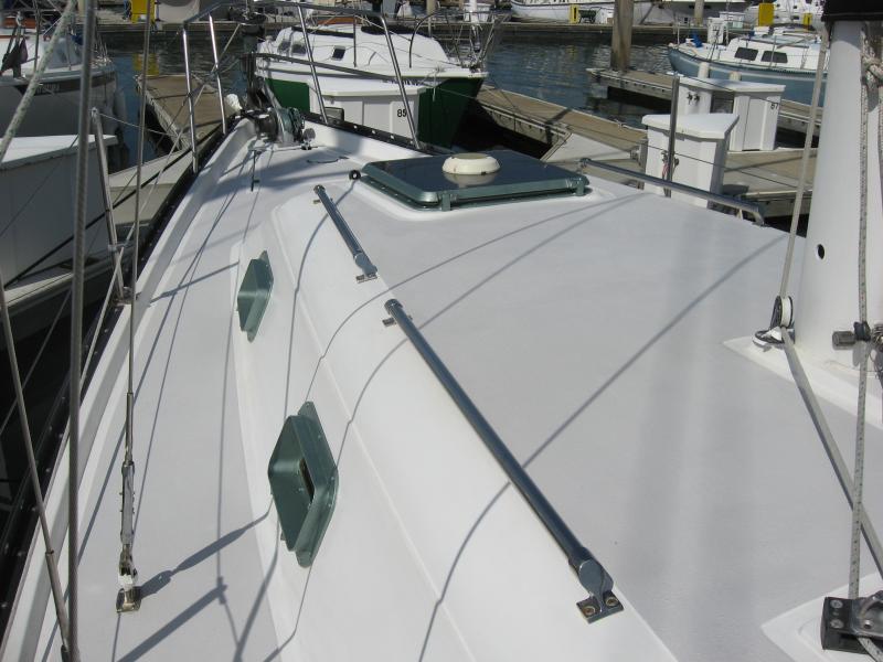

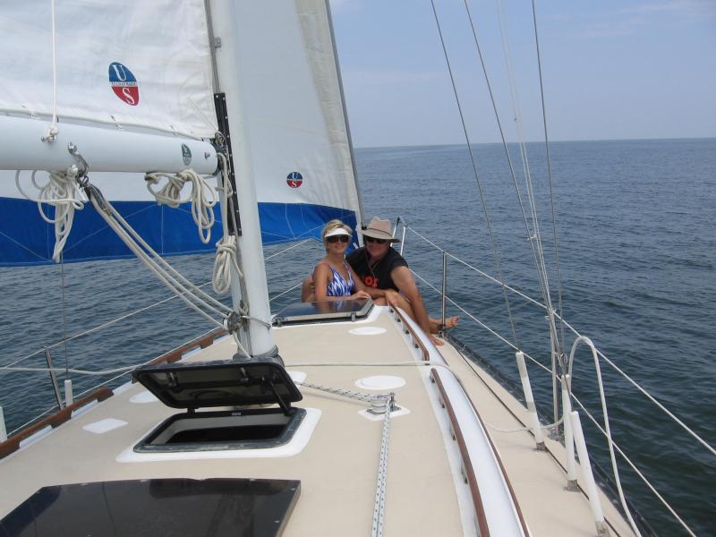

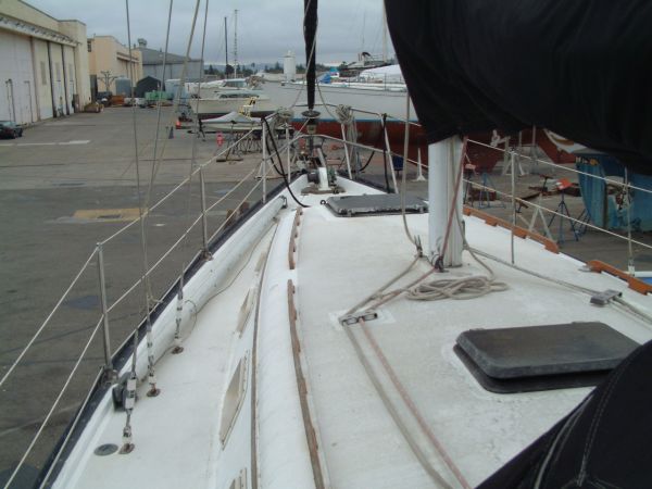

While looking for a picture on my hard drive to include on a "All Sailors" post about chain plate caulk, I stumbled across a picture I took of my foredeck right after I bought my boat. Whereas I saw the potential (or maybe it was wishful thinking), I can now see why friends and relatives gave me the "are you nuts?" look when I gave them the grand tour of my new yacht.
Just thought I'd post the then and now pictures. I had forgotten how tired the boat looked. Its a transformation!

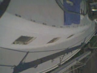

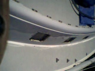

I looked for before/after pictures. What I found reminds me of the state of digital cameras back in 2000. I think the camera was free from AOL when I joined. These are before/after pics when I painted the cabin trunk. :neutral:

When I bought the boat, the gelcoat on the deck and around the cabin top was oxidized, but I had expected that fine wet sanding and polish/wax would get it back to acceptable. However it was too far gone. Even aggressive rubbing with a terry cloth rag exposed the underlying FRP is a few spots. I restored with Interlux 2-part perfection. The exception is in the cockpit. The smooth gelcoat was not seriously oxidized in there. I still haven't restored. Just wax once per year and it looks OK.
The non-skid on the deck looked bad with lots of staining over the 27 years. But otherwise it was in very good mechanical shape and still had all of the original non-skid relief. I also used Perfection on it, mixed with Interlux's non-skid granules/powder. But I also added to the Perfection the max allowable percentage of "flattening agent" so that the non-skid wouldn't be glossy. The non-skid repaint has been on now for about 2.5 years. Aside from the occassional dropped tool, the surface still looks much as the day painted.
Hi Ed:
Undoubtedly your much improved cabin top is due to your good workmanship and not the better quality of the digital camera!

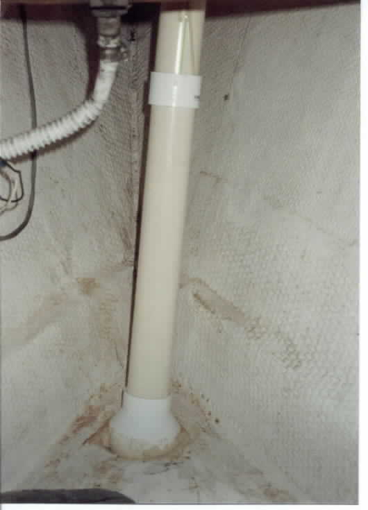

Jim and Ed, thanks. I think the 36 must be quite a bit different. Here is a pic of the v-berth, showing the bottom of the anchor locker. I can mount the windlass in the locker, no problem, but it is just hull below the locker. Would you just drop the chain in there?

Hey, thanks. Does the chain just go into the existing locker then? Sorry to derail the thread, but have been trying to figure the best way to install a windlass on my boat.
Ralph
1,066
Windlasses and chain lockers
RTB, The 37 has an open space under the anchor locker similar to the one in your picture. Originally I had my chain just drop there (150' - all chain rode) but I did install a little 'dam' to keep water and mud from migrating to the forepeak cushions. A couple of years later I installed a chain pipe to take the chain down to the locker below the berth, much as in Ed's picture. I am not entirely happy with this solution - the wet chain is out of sight and further aft, but sometimes it does not flake proberly and jams up in the pipe, necessitating a quick dash below decks!
