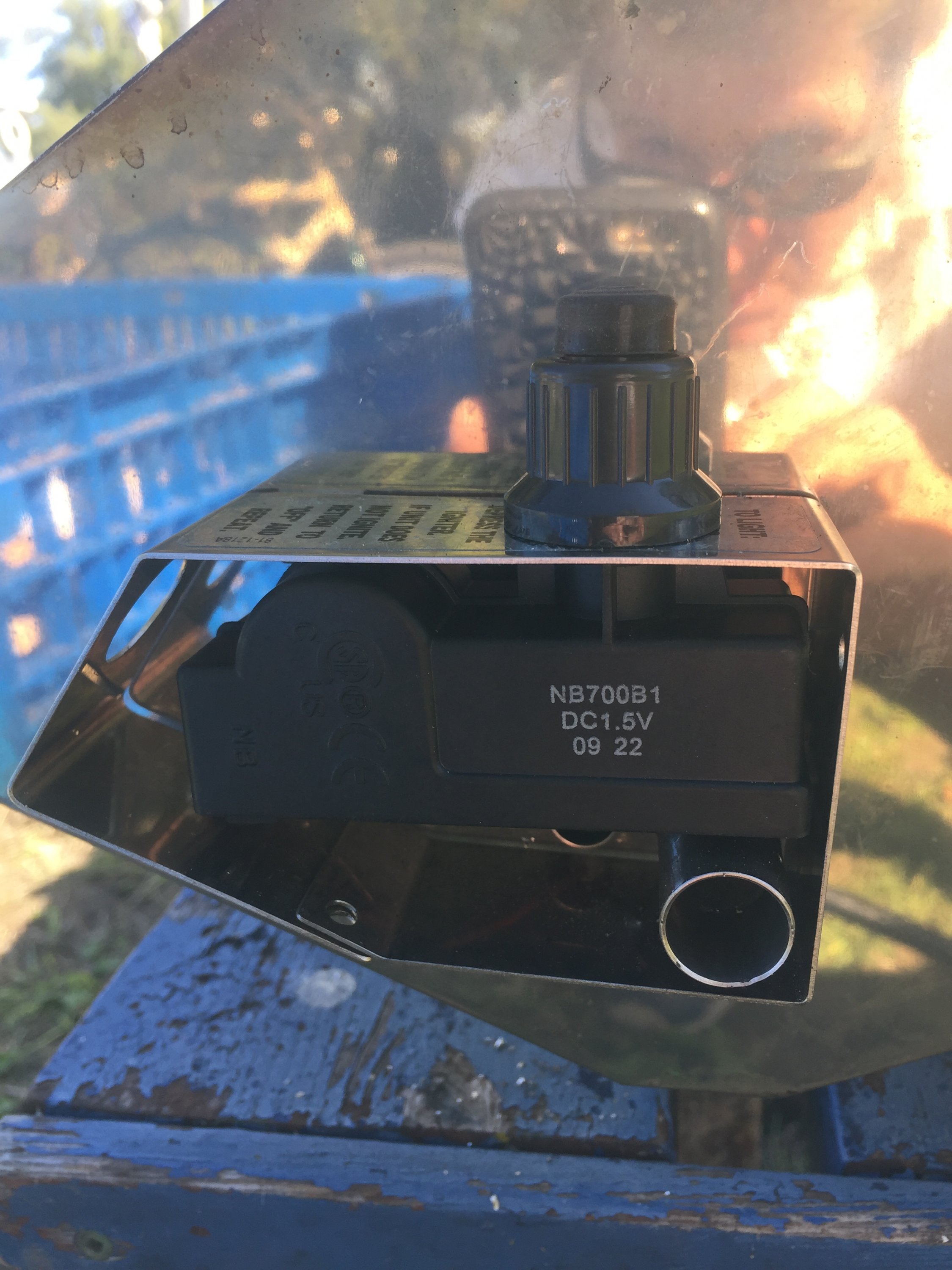

This time you will need a single output sparker.
This job was a little challenging, as I needed to drill a hole in the stainless side box where the original igniter was.
But, it all fit, and it lights in 1/2 second now instead of 20 frantic pushes of the "cursed red button"
These upgrades cost very little, but have huge benefit. Previously, we could only light our oven with a butane lighter, because the sparker was so frustrating. Now, you simply turn on the gas, press the electronic igniter, and it lights immediately.
This photo shows how I installed the igniter in the bbq.
The original sparker was on the front

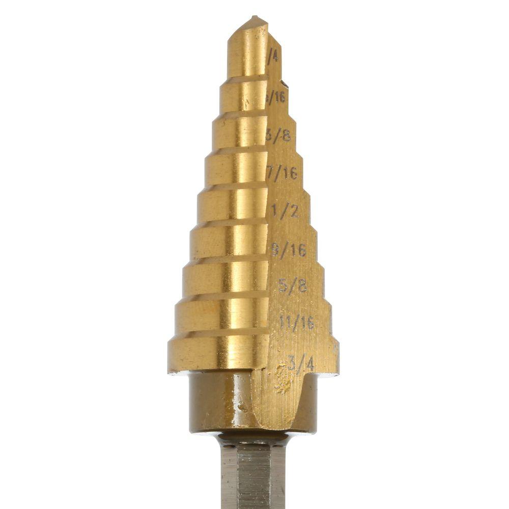

Carefully drill the hole in the top. You must use Xmas tree drill bits for this. DO NOT try to drill this with a large twist drill. You will destroy the stainless housing.
Once you have the new igniter installed, get a snap in plastic hole plug to close the original sparker hole.
Note: the dimensions on this are critical. Get the smallest single output igniter on eBay. You will want the one that uses AAA batteries.
