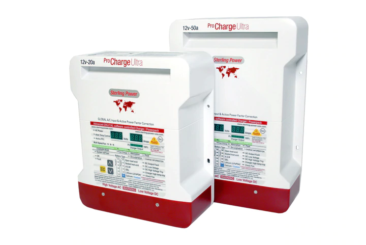

I like my Sterling 40 Amp smart charger. It is hardwired to the boat circuits through the AC panel.
The ProMariner line is similar.
There are many others, some good, many bad to your batteries.
Choose wisely.

As many others have already posted the Sterling ProCharge Ultra or the Promariner ProNautic P are both excellent and both feature a 5 year warranty.. As a veteran Marine electrician I would strongly steer you far away from Xantrex due to reliability issues..

The two chargers listed in post #2 can both be hard wired into a boat. They also can be wired to be plug in. I found the hard wired function to be better on my boat.
