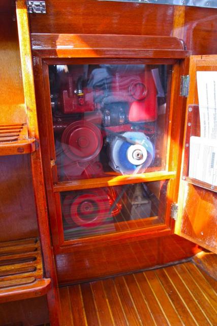

When I rebuilt the galley cabinetry around the engine, I installed 1/4" Lexan between the door and engine(I thought why not give it a try, I had a scrap anyway in the shop).
That too is working quite well. It does in fact cut down sound transmission(one quality of polycarbonate). As I like to constantly check the running engine, it's been working well for me.
Here's a photo of the engine ticking away.

Glad it is working out! You still have minimal belt wrap on the alt so you may still get some when the alt is tasked..
I love the lexan panel for the engine, a man after my own heart...

I agree, looks great. If you have an external regulator, you might be interested in the Small Engine Mode if you have that feature. I've linked it a number of times, do a search on that phrase with my name.
