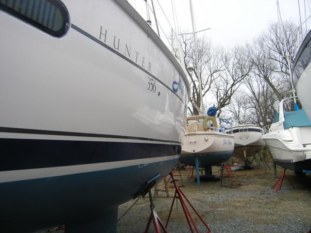

After using the 9277C
I can't hold my arms up after an all day of polishing and waxing. And I use scaffolding around the boat so I'm not reaching over my head.
Love it though - it does do the job...
