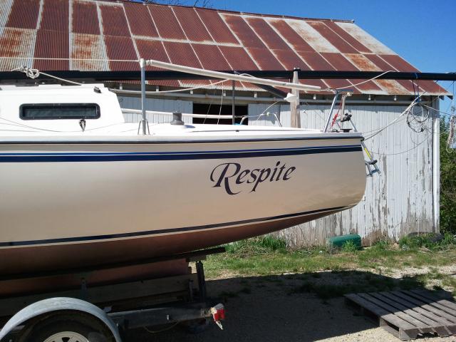

Earlier this year I had asked for some tips on removing old stripes and name from my new to me Starwind 223.
I ended up using the 3M stripe off wheel..found 'em at NAPA. Went through a couple but it did remove those 25 year old stripes in about an hour.

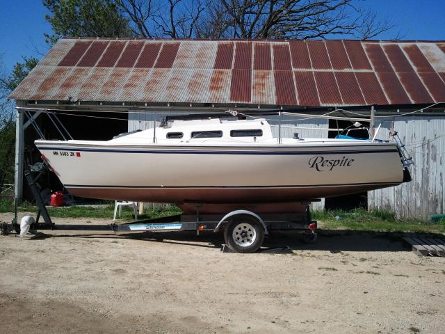

Here's the new striping and name...thanks to all for your help!

Nice! Also found the wheel to be the best for old stripes. Are the new ones vinyl or paint?

Vinyl...from BoatUS graphics. Great price and seems to be a solid product. Slowly pulling back the top cover paper to reveal the name now on the boat was cool.
