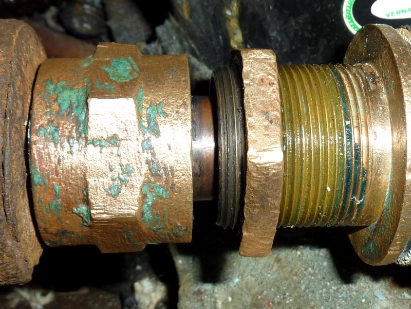

I was experiencing a badly leaking stuffing box on my 1982 Hunter 30 (It was a steady stream of incoming water, and my bilge pump was pumping about every 5 minutes). I visited MaineSails' site, and saw his illustrated, step-by-step instructions for the repair. After studying the detailed instructions, buying the proper tools (Irwin GrooveLock pliers) and materials (PB Blaster), I was finally able to loosen the locking nut, tighten the packing nut, and re-tighten the locking nut.
I can say that the success was based on about 25% skill and 75% persistence. The PB Blaster finally broke the nuts loose, but it took several days of straining and squeezing into a too-small space. (If you have ever done this yourself, on any boat, you know how tight the area is.) You have to realize that I am 6'4" and about 240 lbs. I asked my sailing neighbor for advice, and he suggested "Call a professional."

If you install your packing on the hard you MUST be prepared to adjust the stuffing box immediately once the boat is launched.
If you install your packing while in the water you WILL adjust the stuffing box so it does not leak excessively.

If you've done stuffing boxes before then sure go ahead and do it in the water but with certain boats I would strongly urge you to not do it in-water if you've never done it before. There are many boats out there that this job takes hours not minutes on.
This is one such boat. You are working one handed, it is physically impossible to get two hands in there, and the stuffing nut moves forward less than the diameter of the new or old packing making removal and insertion a feat for a magician. It takes about 45 minutes to an hour to dig all the old stuff out, even with custom bent/made tools, and without a geyser if water flooding your sight, and then another 30-45 minutes to get the new stuff in and properly seated.
Anyone who wants to attempt this re-pack, in the water, is asking for a lot of hassle, a very wet & salty gear box and a fair amount of water ingress while working..
