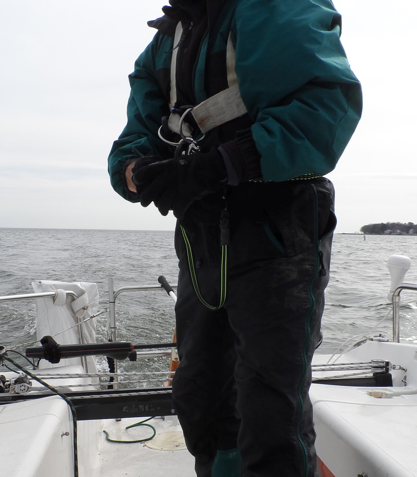

The tether typically has elastic and retracts. Wrap it around your waist, like a belt. Standard racer trick. Out of the way, not uncomfortable, and instant access. Much better than a pouch.
You can see the 2-meter tether around my waist, just below my elbow. Notice that it is NOT clipped to the harness but to the snap shackle. If a spare tether is clipped back to your harness on a two-leg tether, you no longer have quick-release.
I did it that way for a couple of years and found it to be annoying and it would snag on things. That's when I started just shoving it in my coat pocket - which is OK, but not quite big enough.
