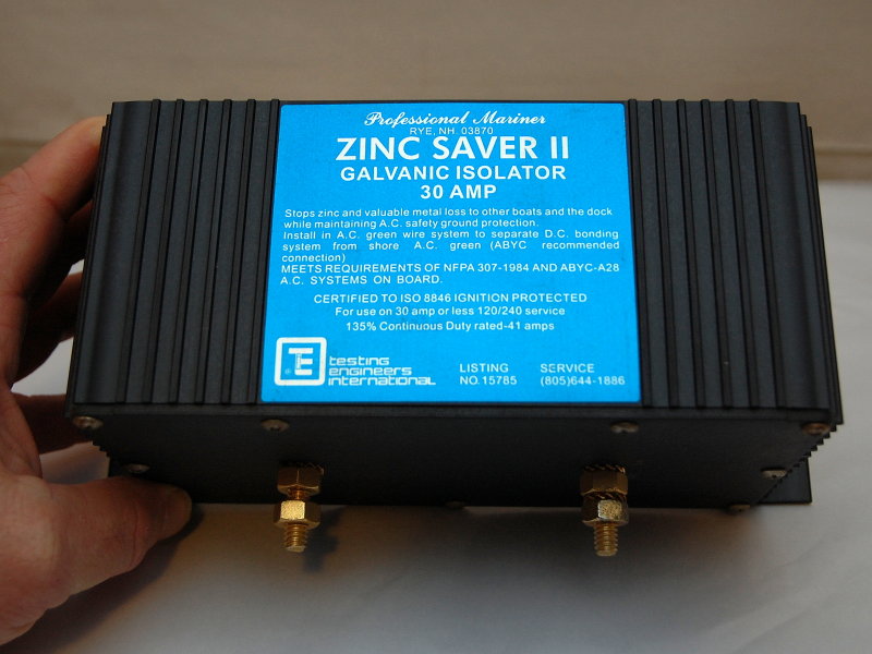

A 30A Galvanic Isolator
A Simple Device

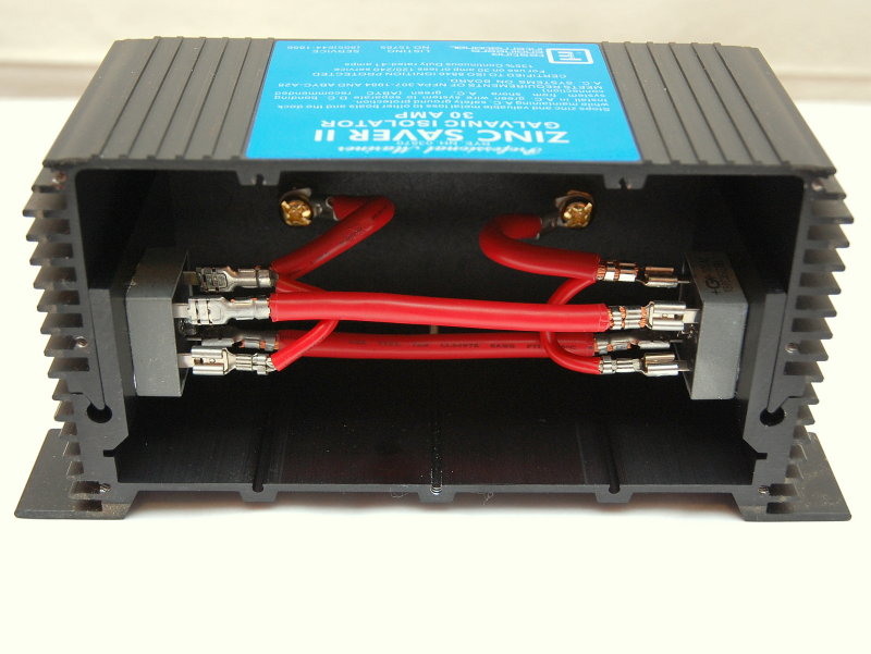

As I said above these are simple devices. When opened up you can see just how simple. Keep in mind that this particular model no longer meets the current ABYC safety standards and I will get to that in a moment. On the back wall we can see the two wires going to the gold plated studs. This is where your green grounding wire would be cut and connected to. Inside we can see the two diodes which allow current to flow in both directions but at the same time blocking voltages below 1.0 - 1.2V.

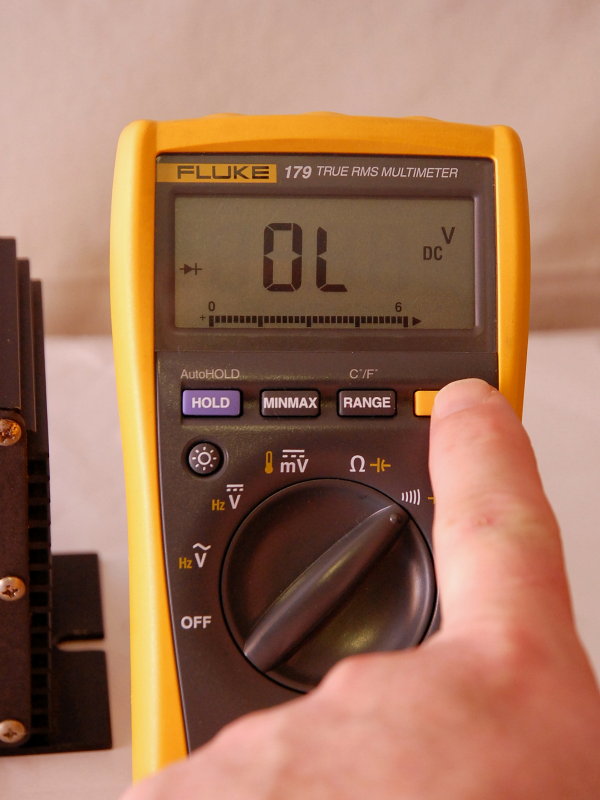

Switching To Diode Test
With this meter pressing the yellow button moves it from the Ω test to the diode test feature. The diode symbol can be seen on the left hand side of the meters screen.

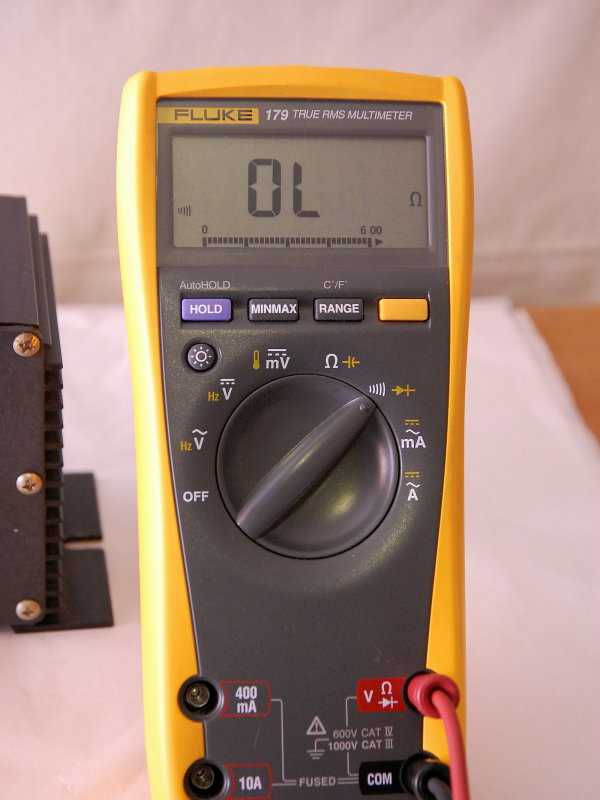

Connect Your Test Leads
First UNPLUG YOUR VESSEL FROM AC POWER !! With the AC power to the vessel OFF disconnect both green wires from the GI and connect your DVM leads to the studs.
If the diodes are working you should see a reading of .7 to 1.0. here the reading is .973..

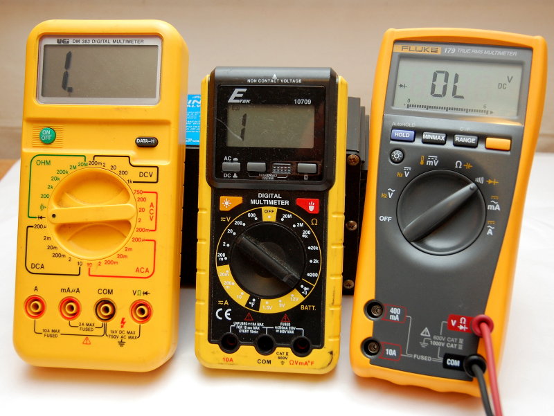

If the diodes are bad you will not get a reading or will get the OL message (open leads) if using a Fluke. Older style galvanic isolators like this usually fail "open"...

Despite being a relic, this isolator is still operable. If however you have an old isolator like this, and you keep your boat at a marina, I would strongly advise upgrading it to newer ABYC compliant unit. The other alternative is to regularly test your GI to ensure its operation.
My personal preference for GI's are the DEI isolators. I feel they are the most robustly built GI's on the market and you don't pay any more for them than you would another "fail safe" brand.. Again DEI has had ZERO GI failures that were not failed "safe" and this includes lighting strikes...

You Don't Need A Fancy Meter
I love my Fluke equipment, and you'd need to pry it from my dead fingers, but for work like this even an inexpensive meter will do, provided it has a diode test function, and many "cheapies" do.
In this photo each meter has been set to the diode test function.

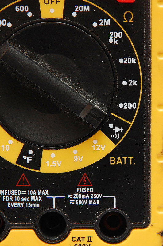

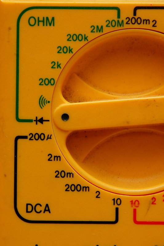

The Diode Symbol
The dial of this meter is pointing to the diode symbol. If a meter has the diode symbol it offers the diode test function.

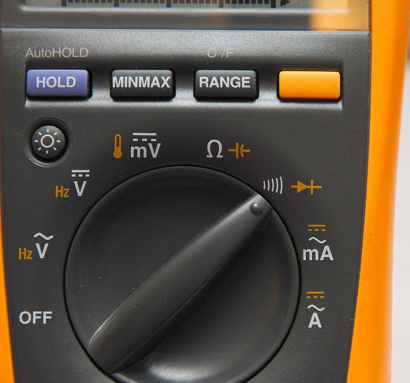

Set To Diode Test
On this meter the diode test function shares a dial position with the "audible" continuity test. This meter was about $20.00 at Wal*Mart. I bought it one day when I forgot my meter bag.....

Diode Test
On the Fluke 179 you simply toggle between the diode test and Ω with the yellow button.

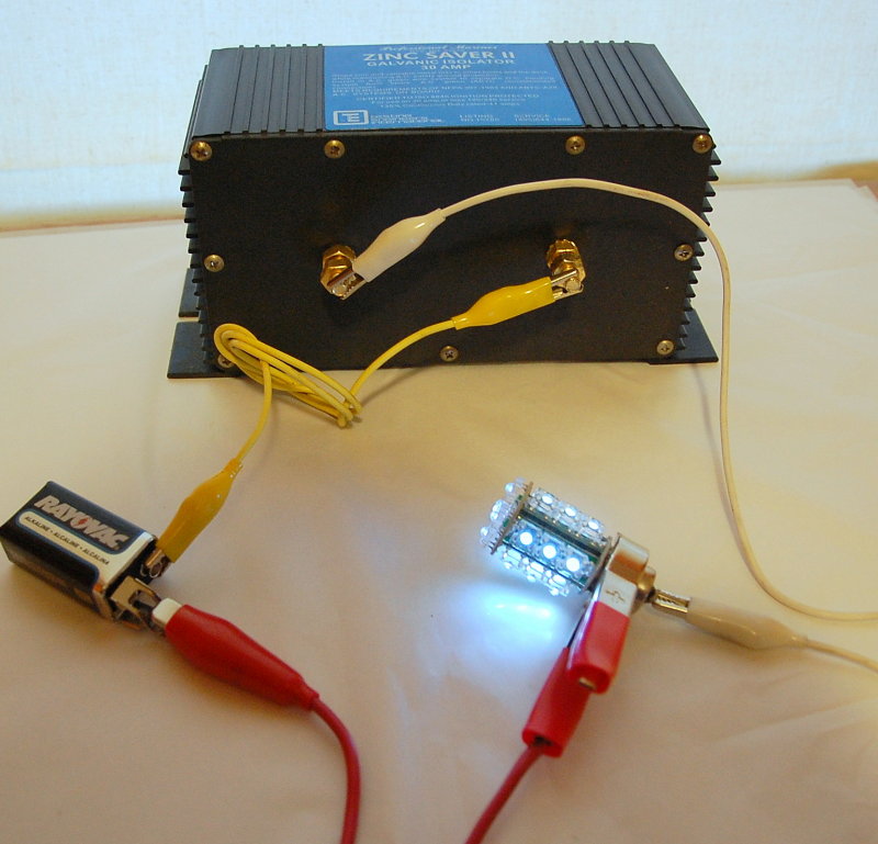

Alternative Test
While I prefer to use the diode test functionality of a DVM you can do a quick and dirty test with a 9V battery and a 12V light bulb. I grabbed an LED bulb but I won't guarantee all LED bulbs will fire at sub 9V. You will get a dimly lit 12V bulb with a 9V battery but the test works. I only used the LED because it showed up better with the picture.
If you first connect your bulb direct to the 9V battery then test it through the isolator you will notice a change in brightness. This is caused by the voltage drop across the diodes and is 100% normal and should be expected..
Wire the 9V battery and light bulb as shown and the bulb should light if the diodes are good..

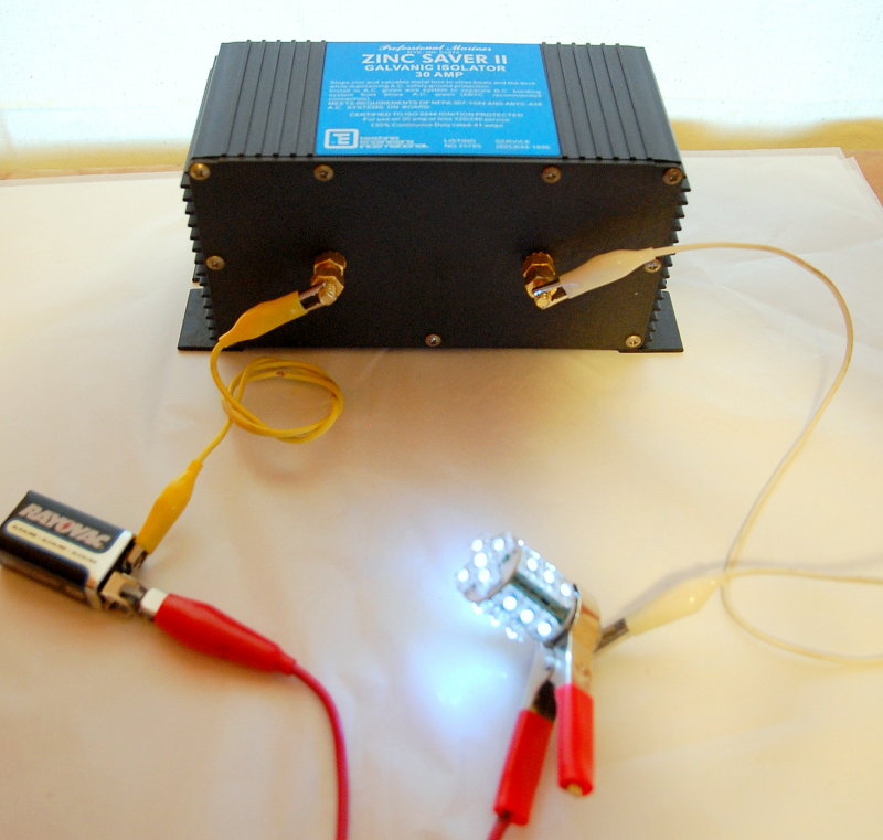

Reverse The Leads
Again, just like with the diode test function on the DVM you'll need to reverse the leads to check the flow in the opposite direction. The bulb should light.
Galvanic isolators are in the path of the safety ground for your vessel so it is critical that you know your GI is working. Newer GI's have either idiot lights that tell you it is on or are fail safe so there is much less need to worry about losing the safety ground.
This test is for older style GI's like the one pictured. There are still perhaps hundreds of thousands of boats with this style GI installed on them...

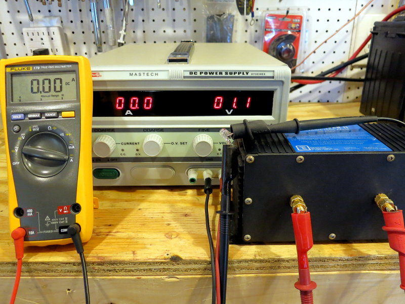

Blocking Current @ 1.1V
This is a test most won't be able to conduct unless you have an adjustable bench top DC power supply or a 1.5V battery and some diodes to drop the voltage below 1.1V.
In this photo I have set the power supply to 1.1V DC and am measuring the current with the Fluke meter. As you can see, based on the Fluke meter, the diodes in the Galvanic Isolator are doing what they are intended to do, block DC current when the voltage is below 1.1V - 1.2V.. The Fluke reads 0.00A DC and this is how it should perform.

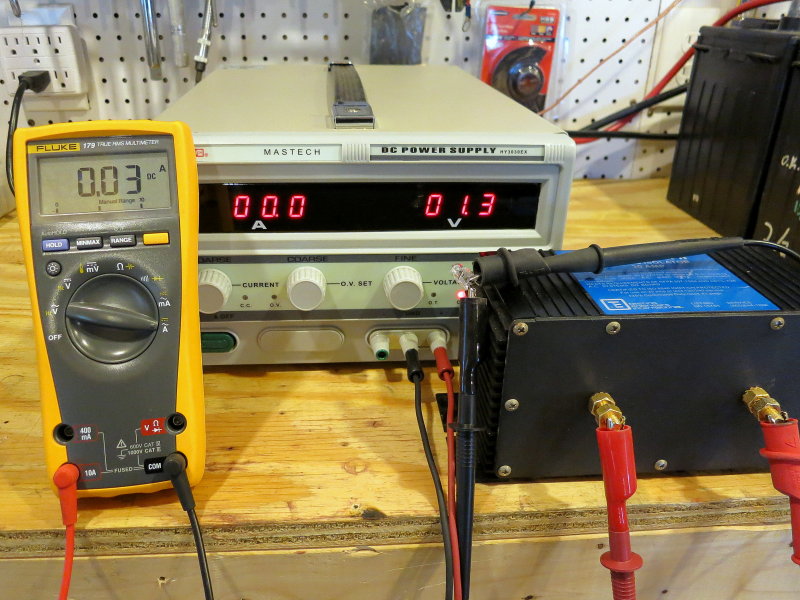

Current Flowing @ 1.3V
In this final image I turned up the DC voltage to 1.3V and we can now see the diodes beginning to allow current to flow. The Fluke is measuring 0.03A or three hundredths of an amp at 1.3V across the diodes. Galvanic voltages from connected dissimilar metals will rarely if ever approach 1.0V thus stray DC current is blocked.
This GI is doing what it should and will block dangerous DC galvanic current and allow AC fault current to flow when needed..
