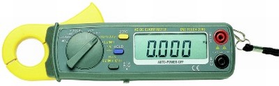

I have a Clamp on meter that measures DC and anything else electrical you would need on a boat Just clip over alternator wire to battery and measure amps. cost Aus$159 Details below AC/DC Current Clamp Meter http://www1.jaycar.com.au This small clamp meter will measure an amazing 200 Amps DC. It is ideal for car stereo installations and electrical trades people. It has a one touch zero adjustment for DC current measurement. Jaw opening is 23mm. There is a 10mA high resolution on 40A DC/AC range. Also measures DVC, ACV, Ohms, diodes, capacitors and continuity. It is supplied in a handy vinyl pouch, along with leads.
