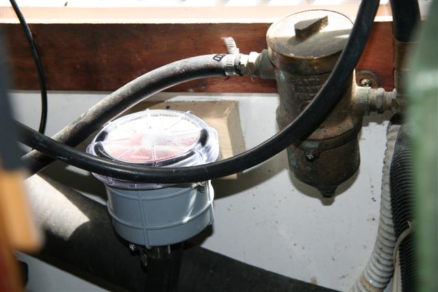

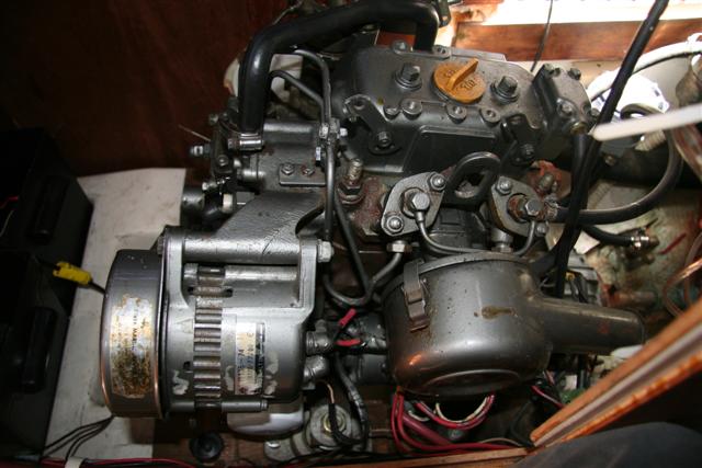

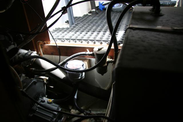

Running engine on the hard - water strainer
Hi all,
I recently became the proud owner of a 1982 Hunter 33. This is the first boat I've owned that has a diesel engine (original Yanmar 2GM). Being totally engine-challenged, I've started to study Calder's book on marine diesels.
This thread was interesting to me because I intend to start the engine while the boat is on her cradle, before launching in a couple of weeks. My plan is to disconnect the raw water hose from its seacock and put it in a bucket, then start the engine and let it run for no more than a couple of minutes. This way I'll be sure it runs and I'll be able to move from the dock to my slip after launching.
However, it ocurred to me that instead of disconnecting the water, I could just open the water strainer lid and feed it water as it's sucked. The water strainer is not original, it has a transparent lid that I can unscrew, and it's placed at a very convenient place. Is this silly? Am I missing something obvious that makes this technique impracticable?
Thanks for your opinions!
Feb 6, 1998
11,711
Feeding the strainer..
What you're missing is the speed at which a raw water pump can suck water. My Westerbeke can drain a five gallon bucket between 45 & 60 seconds depending upon RPM. You'd have a very tough time keeping your impeller from sucking air feeding the strainer.
The in/out bucket is the preferred method. As others have said NEVER, EVER connect pressurized water (garden hose) to your engine!
With a garden hose feeding your5 gal bucket, and using an adjustable hose nozzle, you can very easily balance the in/out flow of the bucket and allow the motor can run up to temp. If the bucket is draining too fast simply slow the engine RPM a little. If the bucket is climbing and about to over flow give it a little more RPM or adjust the hose nozzle.
