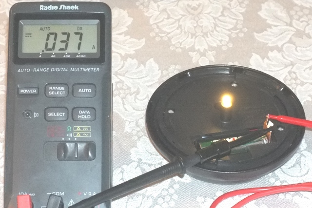

Well, that is going to be a trick. How to see the current with my meter without taking the whole solar light fixture apart. Got it!
I have some 1/2" wide copper adhesive tape. I cut off two pieces about 3/4" long. Put them together to cut out tabs. Then I took off the backing and fixed both pieces to an old business card. Trimmed all the edges.
Now that I have both sides with copper, I can insert this into the battery well between the battery (+) tab and the battery. I have to be careful because this could actually be used as a capacitor.
Once it is in the battery well, the voltage and current are blocked because of the insulator. So the light will not turn on. Now I can connect the meter.
As you can see, the light is drawing 37ma. With this setup, I can also check other things that use batteries as long as one side of the connection is accessible. For this test, the light stayed on for about 6 hours. The battery is 1350mah 1.2v NiMH. So there is something in the circuit that is drawing too much. By the time the light goes out, the battery is around .9v. Maybe a bigger battery. 300mah battery last only 4 hours.

I'm thinking corrosion in the battery box or the solar cells are not charging the batteries well. FWIW

Bill, this was more about developing a tool to test current flow, than the actual reason why the light was not working well. But the battery well is clean. The lights are not that old. I believe it to be something about the design or even the LED itself.

Could the battery simply be defective? I love your creative instrumentation. The capacitance consideration of your manufactured prob interface is interesting. By careful, I assume you mean to try and keep it from a static charge buildup? What is your solution? Would you need to ground it out just before connecting it, to discharge the static? Would the charge not build back up as it stayed connected through the test?
