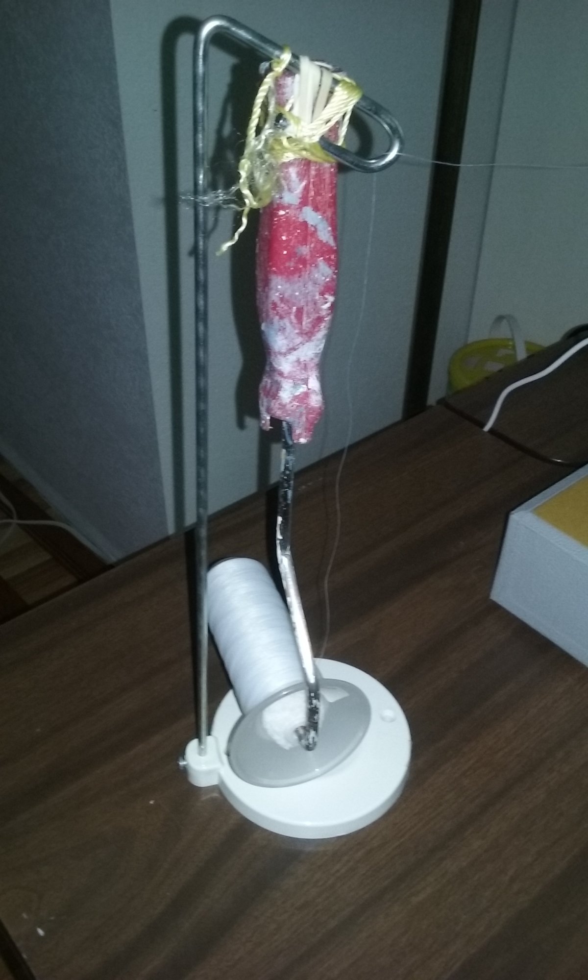

We have been using Tenara thread in our LSZ1 for all of our outdoor projects on our boat for about 10-years and will never go back to polyester thread when exposed to the sun. All of our Sunbrella has rot-free thread. That said, Sailrite recommends their PTFE Lifetime Thread over Tenara in the oscillating hook LSZ1 machines.
They say that it is easier to get good stiches with it. We have had problems with Tenara in our LSZ1 but for the most part have overcome them after a lot of messing around with tension top and bottom and building a TP roller thread holder.

I did all of the tricks that sailrite lists for getting Tenara to sew on the LSZ1 and have finally gotten it to work very well with only a few skipped stitches. The biggest possitive changes came from
  1. Makeing the TP roller cone holder so that the thread unrolled instead of twisting off the top
  2. Getting a second bobbin holder just for Tenara with the tension down a lot harder than normal.
Those two were game changers!
