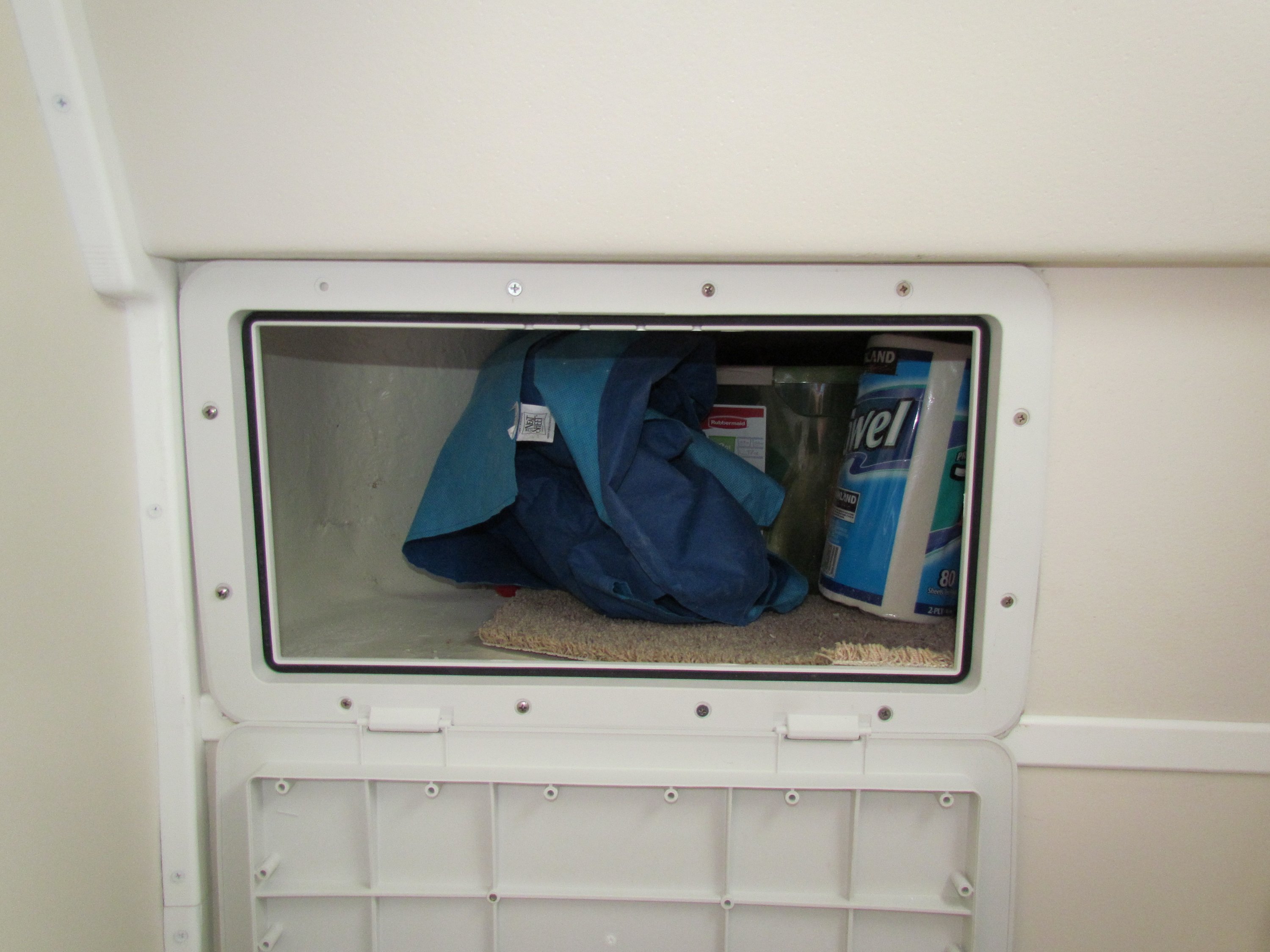

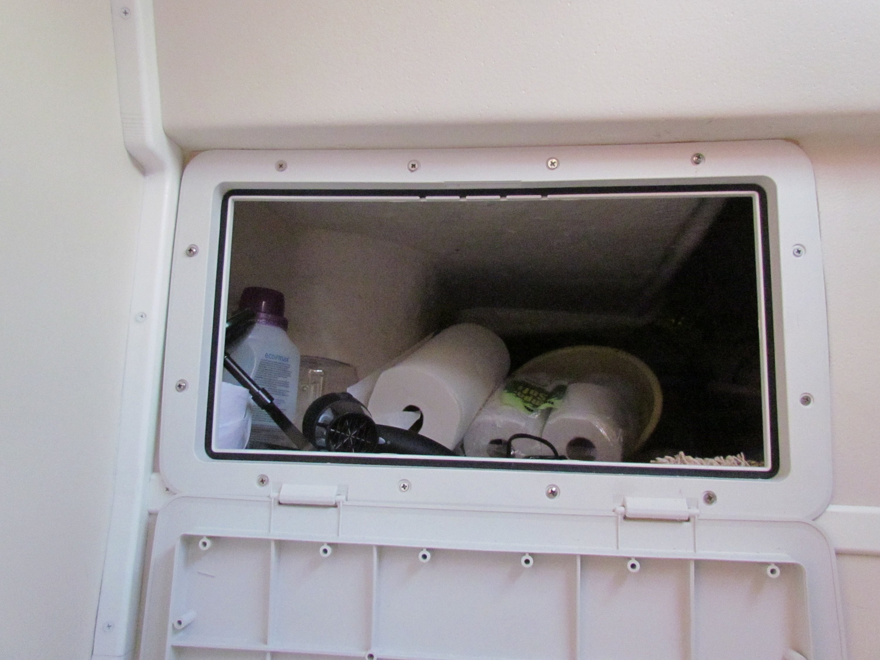

Back in 2011, there was a discussion about adding an access Hatch to the port side lazarette from the head , it was added to by Jesse, PaulJ, Rpwilla, and others. I want to know how this has worked out for you as we are contemplating adding this in the spring.
The hatch size is 13 X 23 to add more access/storage.
The current product is the IMTRA spa-40205
size is cut out 10 3/4 X 20 1/2
Is that about what size you used, I am not near the boat to measure so I would like to get this ordered to get the project done before launch.
Comments? would you do it again? how long did it take you?
Much Thanks

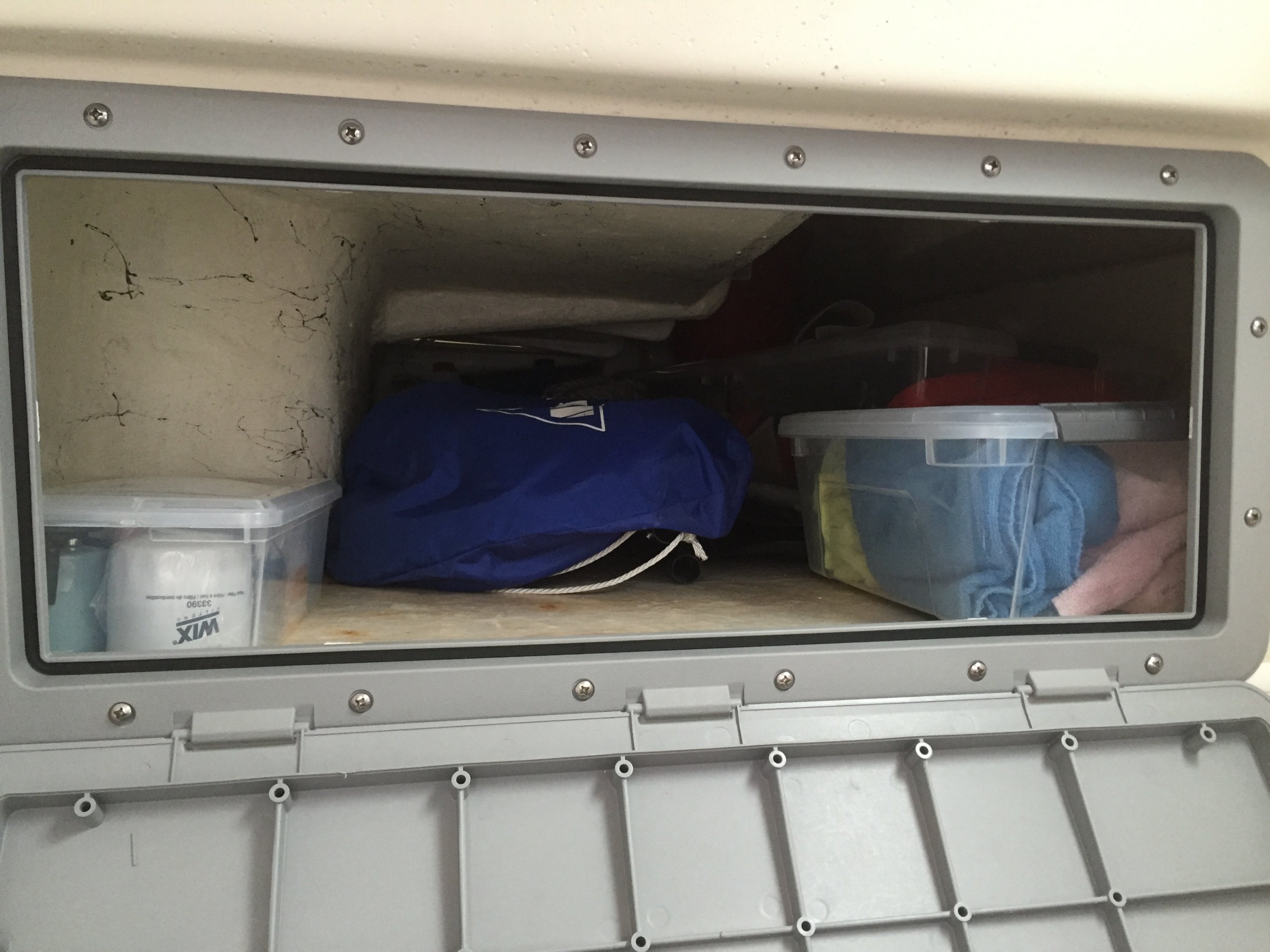

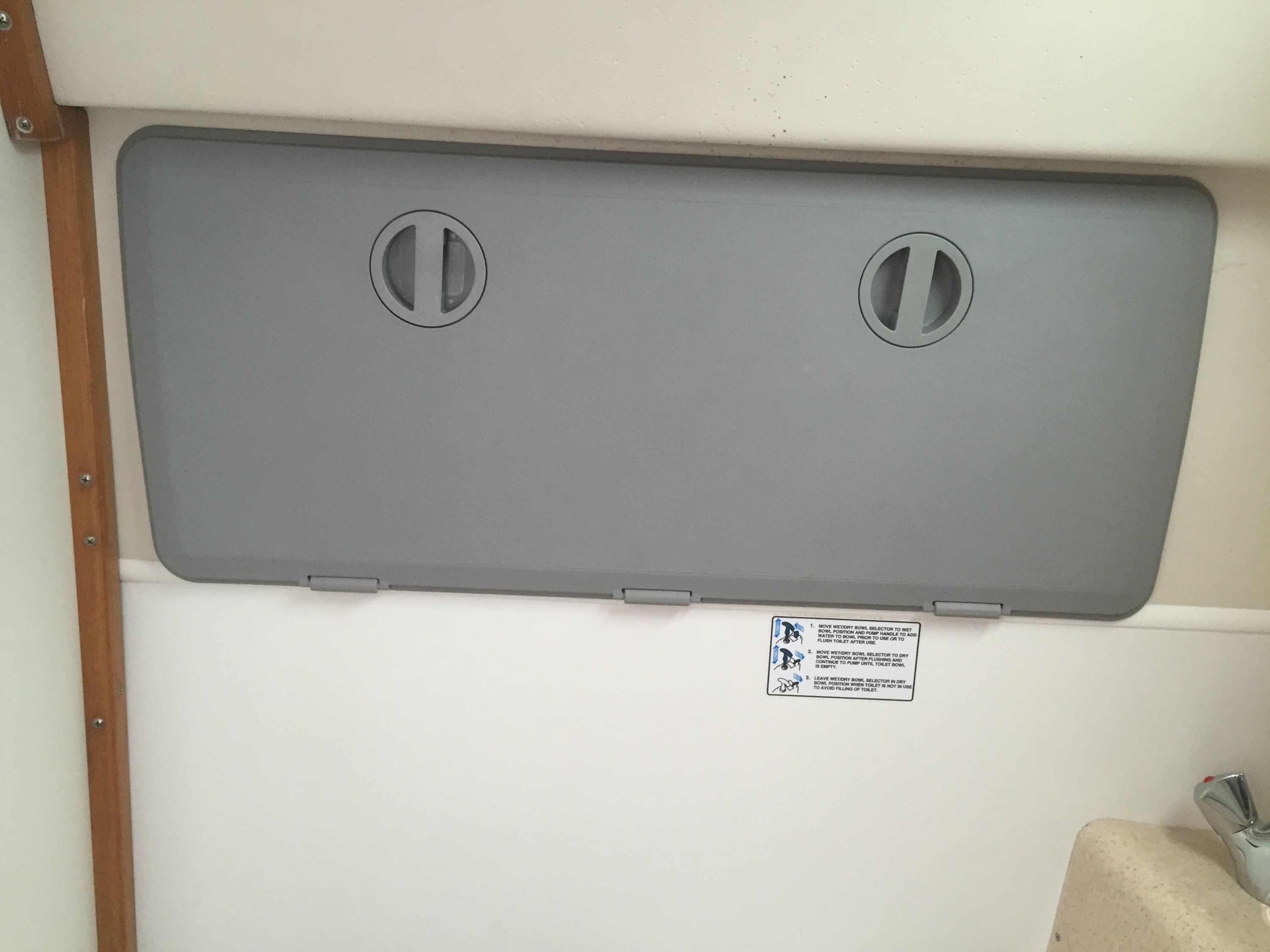

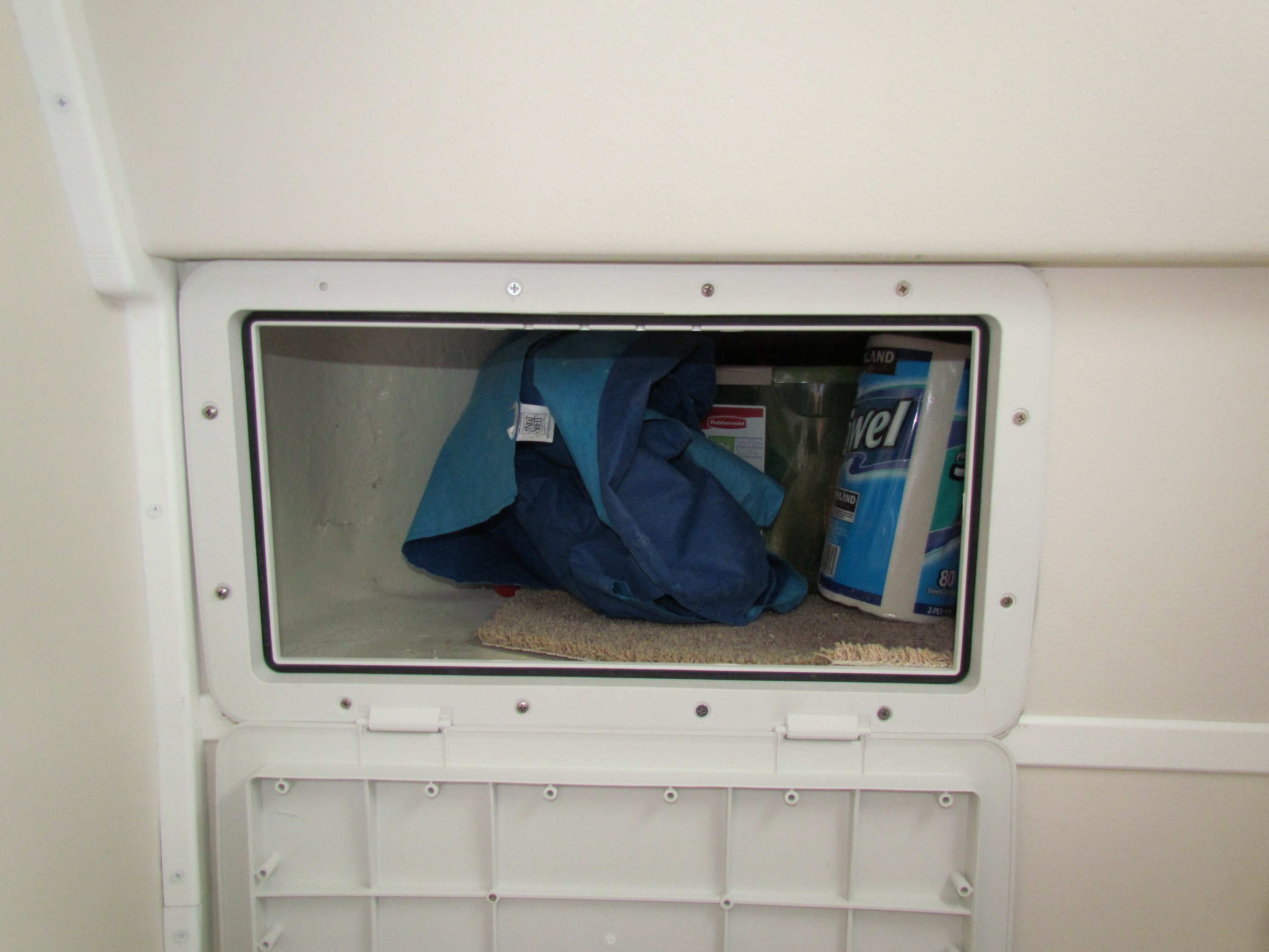

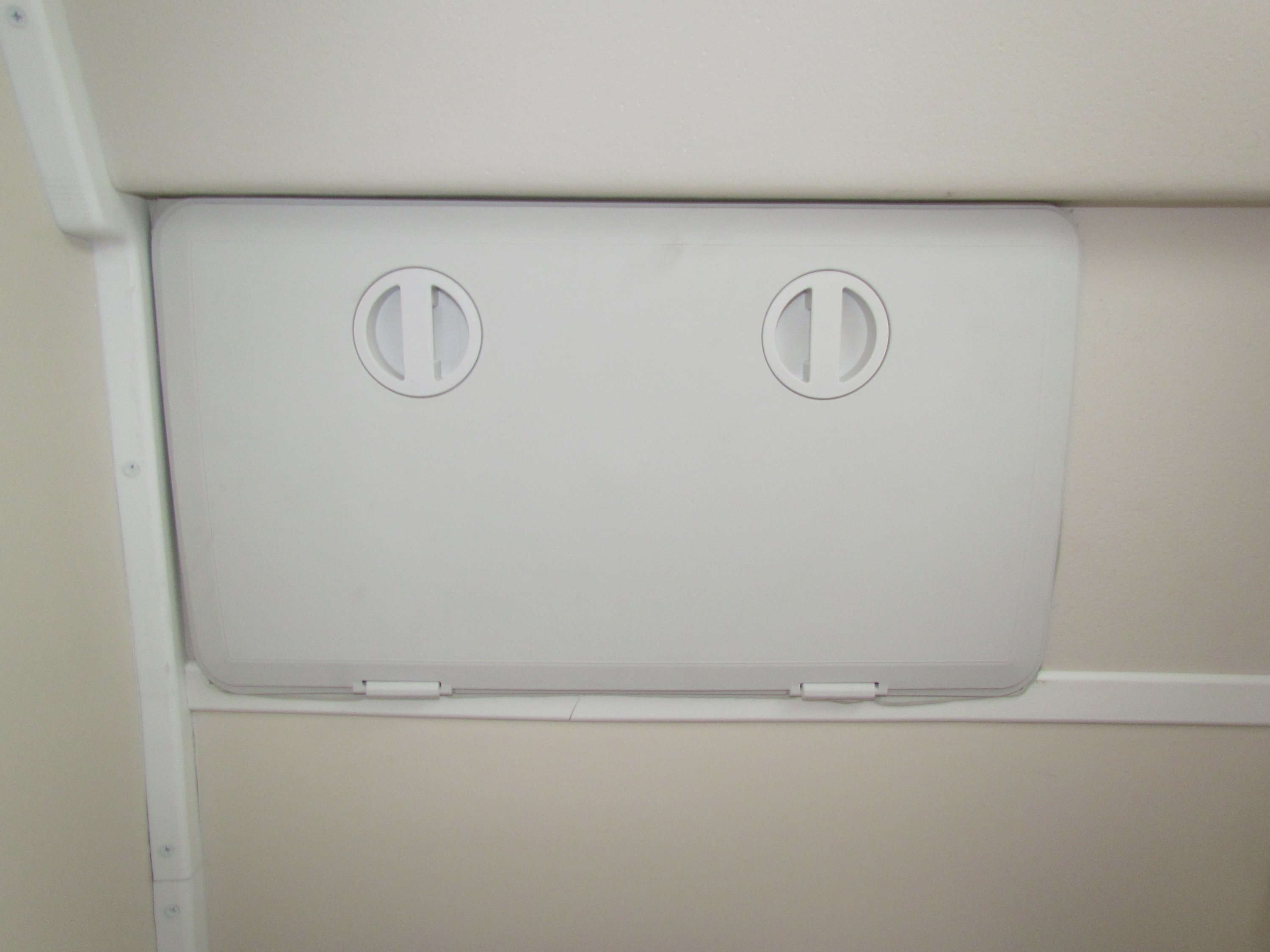

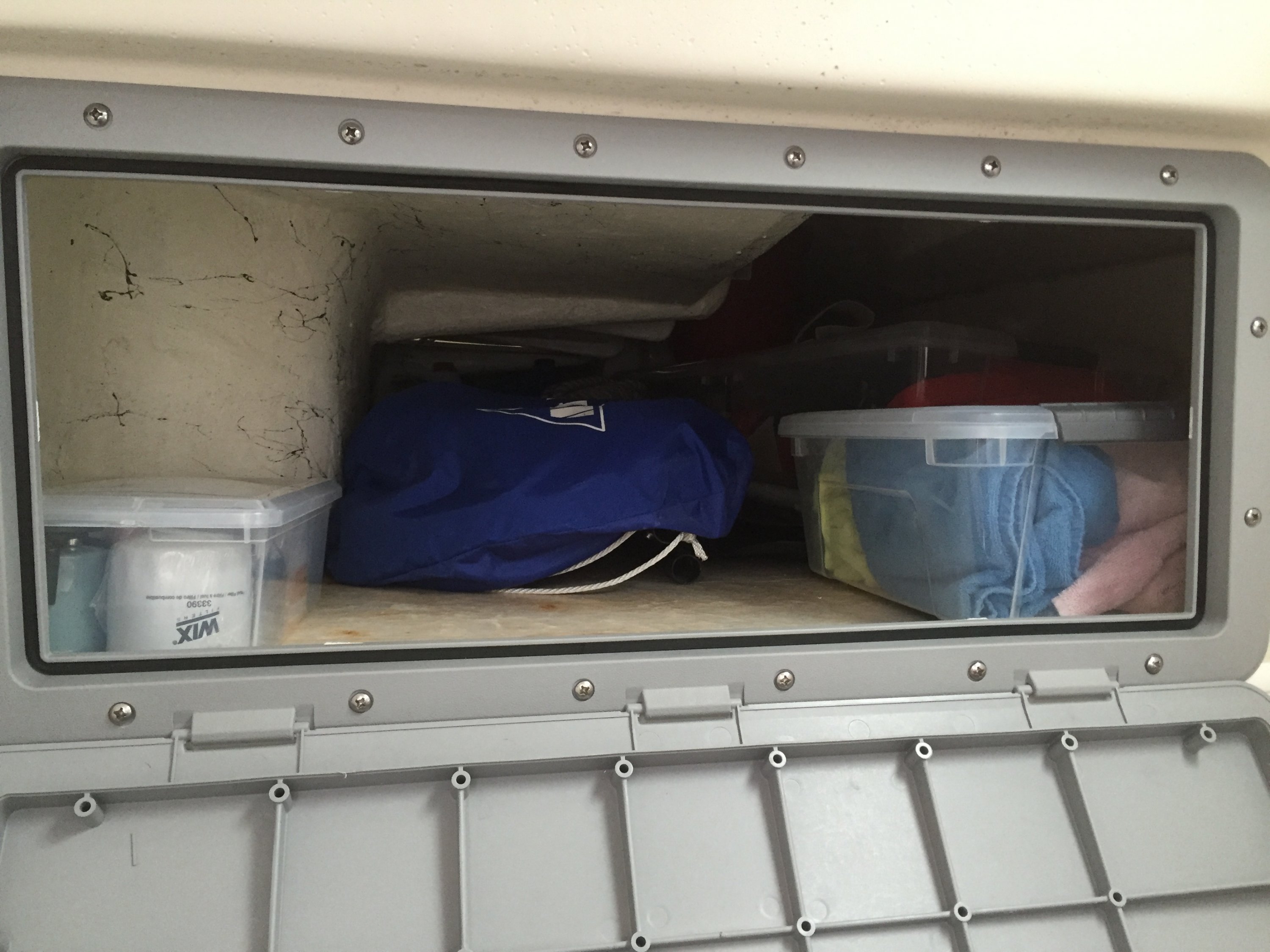

I don't remember the size, but it was the biggest one I could find at the time that would fit. Could not imagine life on the boat without it, really a great upgrade.

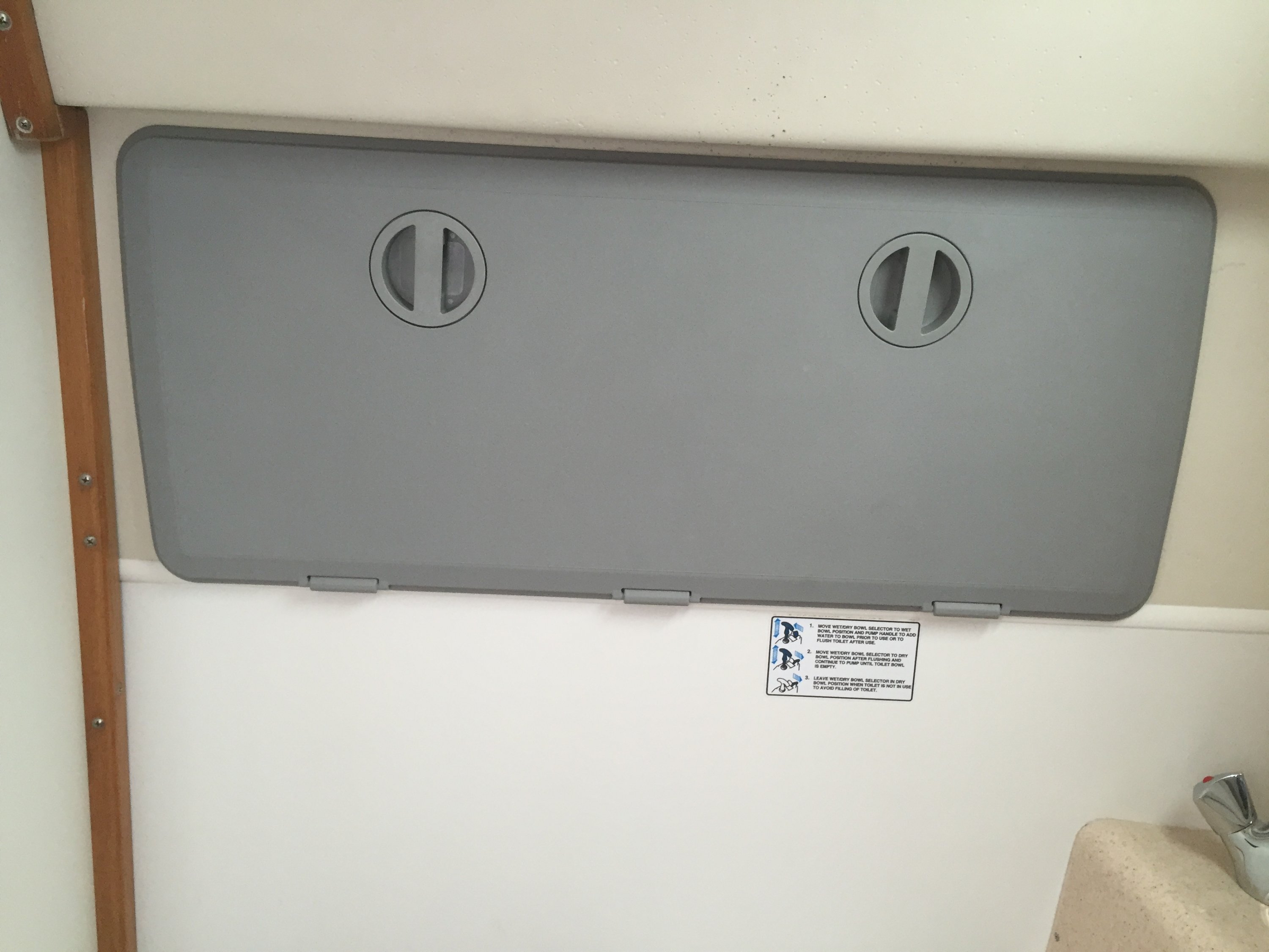

FYI: Amazon carries the Tempress 13x23" hatch for a reasonable price and Prime delivery. On my list of upgrades to do.

Pictures for sure. I'm interested in the horizontal location you pick for it.

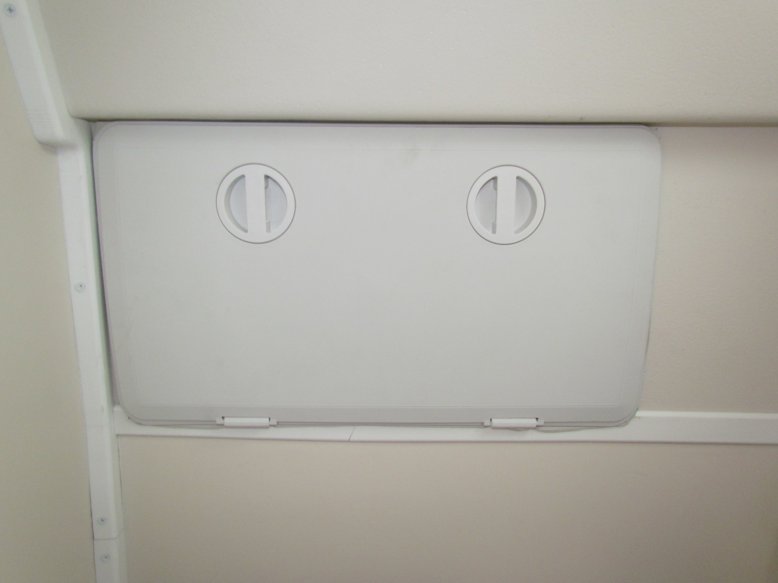

YEAH!, Yesterday was the day that the hatch was installed and it went well, we bought 3/4" screws for the install as we were going to use a backer but we did not as the fiberglass was thick enough to support without it. The area created an opening that was awesome, I am very glad I did the hatch project it will add More storage for sure. The project took about two hours to get done.
Thanks for all the information and guidance that was a big help!
