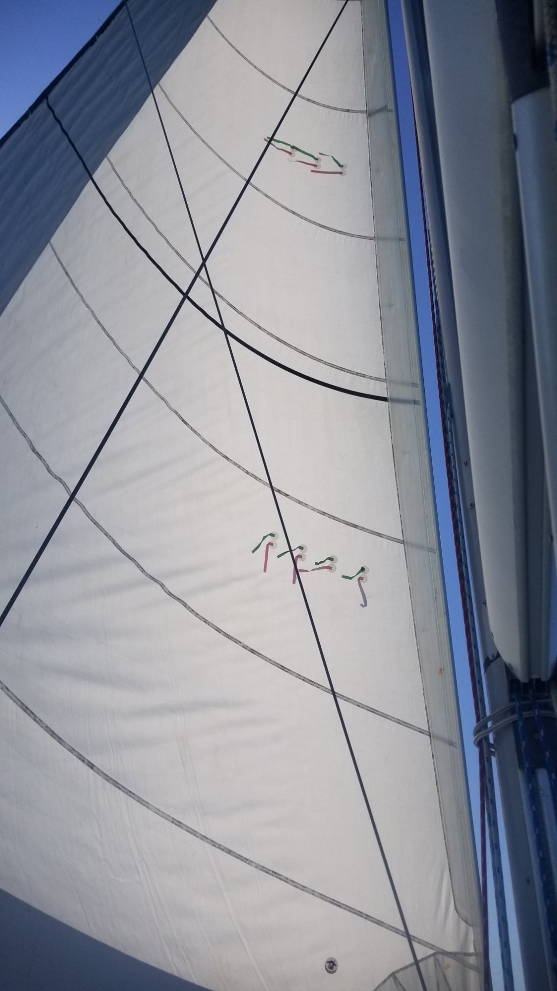

Here is a recent image I received from a fellow SBO member. It illustrates the visibility comments about telltales.
Apr 5, 2009
3,211
@jssailem I agree that on a day like that photo was taken they are completely uneeded but when it is overcast or worse, you are sailing along an hilly tree covered hillside, it is almost impossible to see the leeward tail.

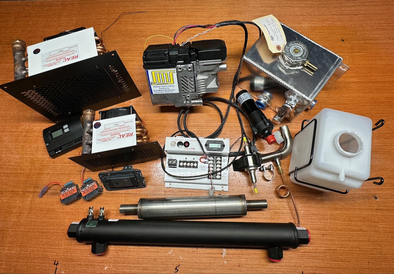

I did that upgrade several years ago and @jssailem was one of the first beneficiaries of the warm cabin on a chilly early May morning. I am glad to see that you are installing the muffler right from the beginning. He can also tell you what it is like without the muffler. :facepalm: Sounded like a 707 run-up. With the muffler, the burner cannot be heard at all and the only way that I know it is running is by the quiet whine from the water pump. Best heat in the world. I designed and installed my own system. I have a summer loop that bypasses the fan coils and only goes to the domestic water heater. I also have values that interconnect it to the engine so that I can use the espar to heat the engine or the engine to heat the water heater. I filled the whole system with a pet-safe Propylene glycol antifreeze in the engine and the hydronic.
