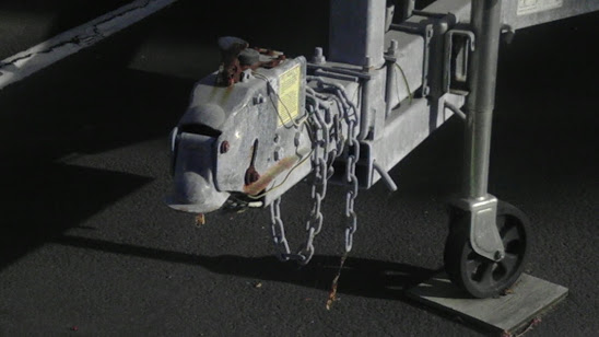

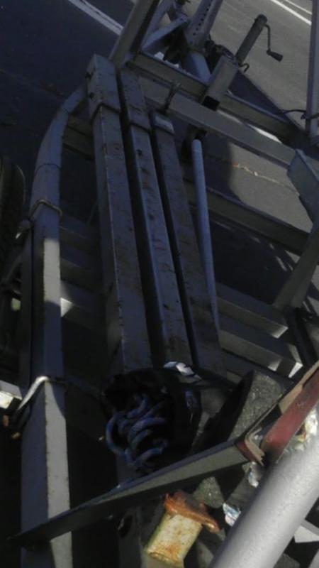

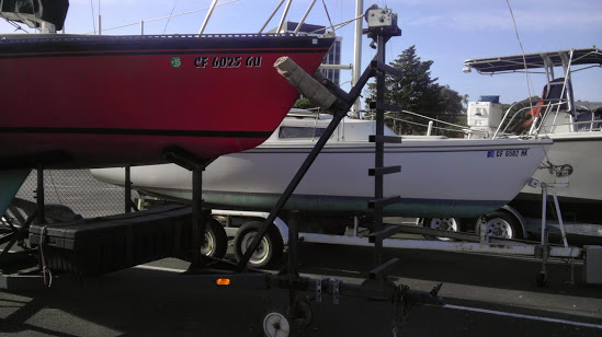

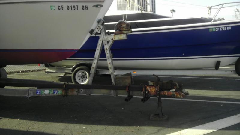

I took some pictures last Sunday of fin keel trailerable setups. Most used the square tubing that socks into a receiver and pinned. One had 3 12' extensions that when connected gave you 30'. Half of them used a larger swivel wheel mounted on a screw jack. To hers hat a 10"-12" swivel wheel mounted on mounted permanently on they extension.

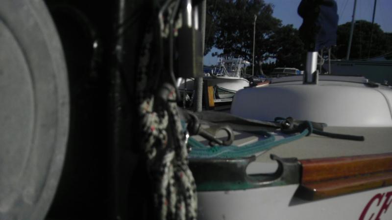

There were some really cool setups that extended the winch post level with the deck. I watched one retrieve his boat and he simply layer on the bow and cranked it in after attaching the winch strap to the anchor cleat.
I would have videoed it but I was busy trying to beat him to the wash station. He started before me but because he had to take time to disconnect the extension I won, Heh, heh, heh.
Here are some pictures including his.

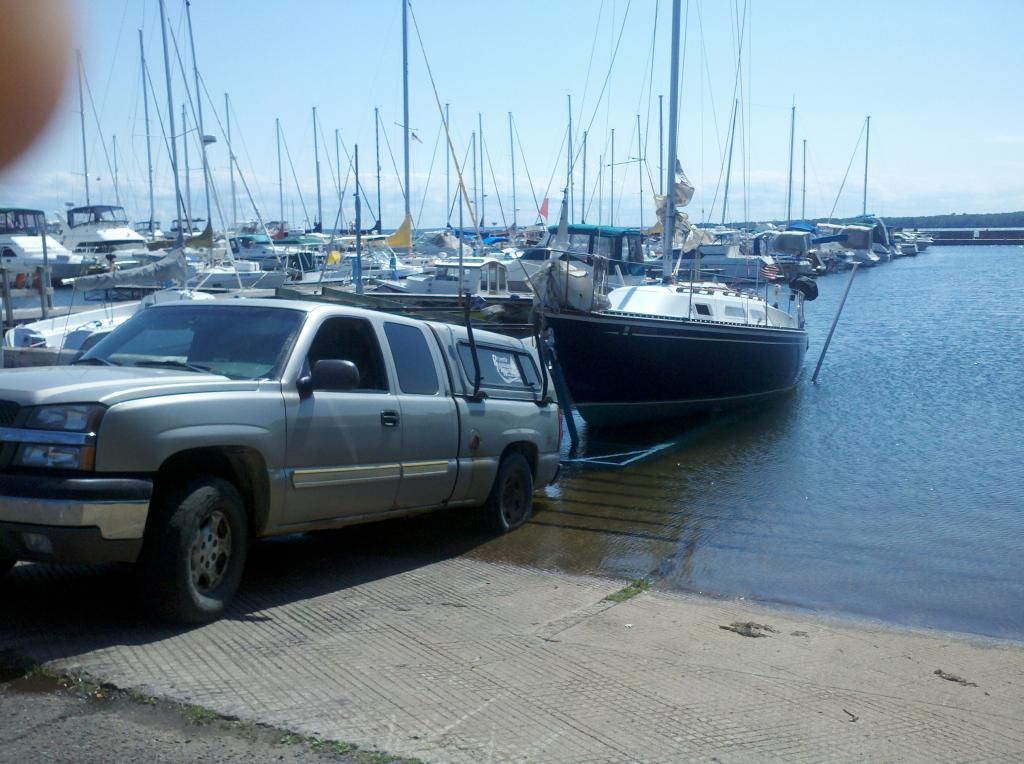

Strap launch, dolly wheels... I've reinforced those wheels since, and gone to dual 2x2" steel square bolted to the frame.

Regarding the above photo with strap, I would be extra cautious with that strap if it is the one rated for 3500 pounds. I would suggest the heavier version to avoid a possible potential accident should the 3500 test strap should break. I have seen it happen before.

Strap was a 5000lb tow strap... and I just upgraded to a 7000 as the 5000 broke (on a stump I was pulling out)... Backhoe/tractor got revenge for me.
Yeah I always use a strap rated to at least the weight of the boat, if not boat and trailer (not like you are picking it straight up, but sometimes its a lot of weight)... the extra $10 for the strap is well spent.
Was a bear finding hooks rated to the strap though.
Note that 6 feet or so extra of length made it so I didn't even wet the axle.
