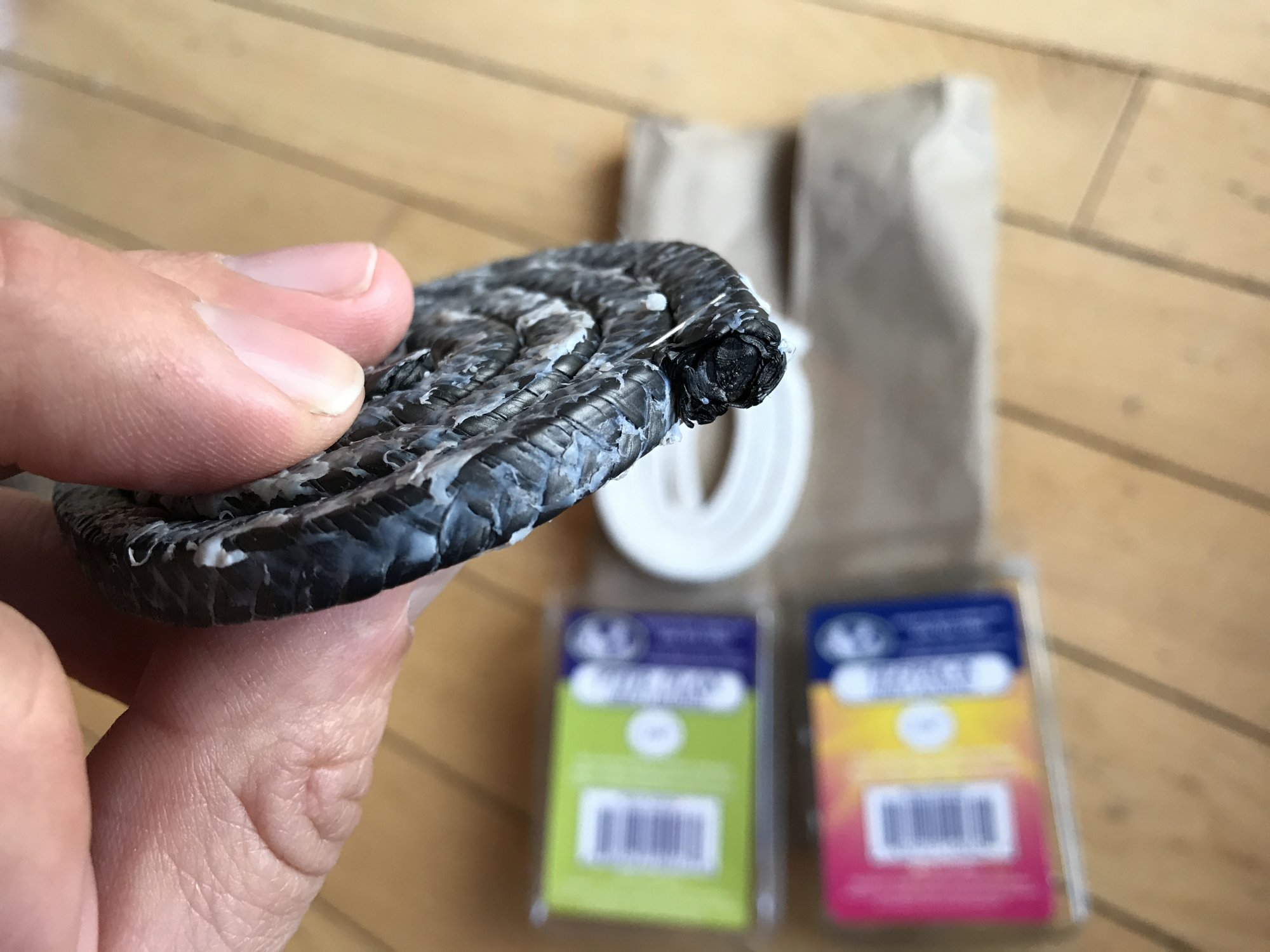

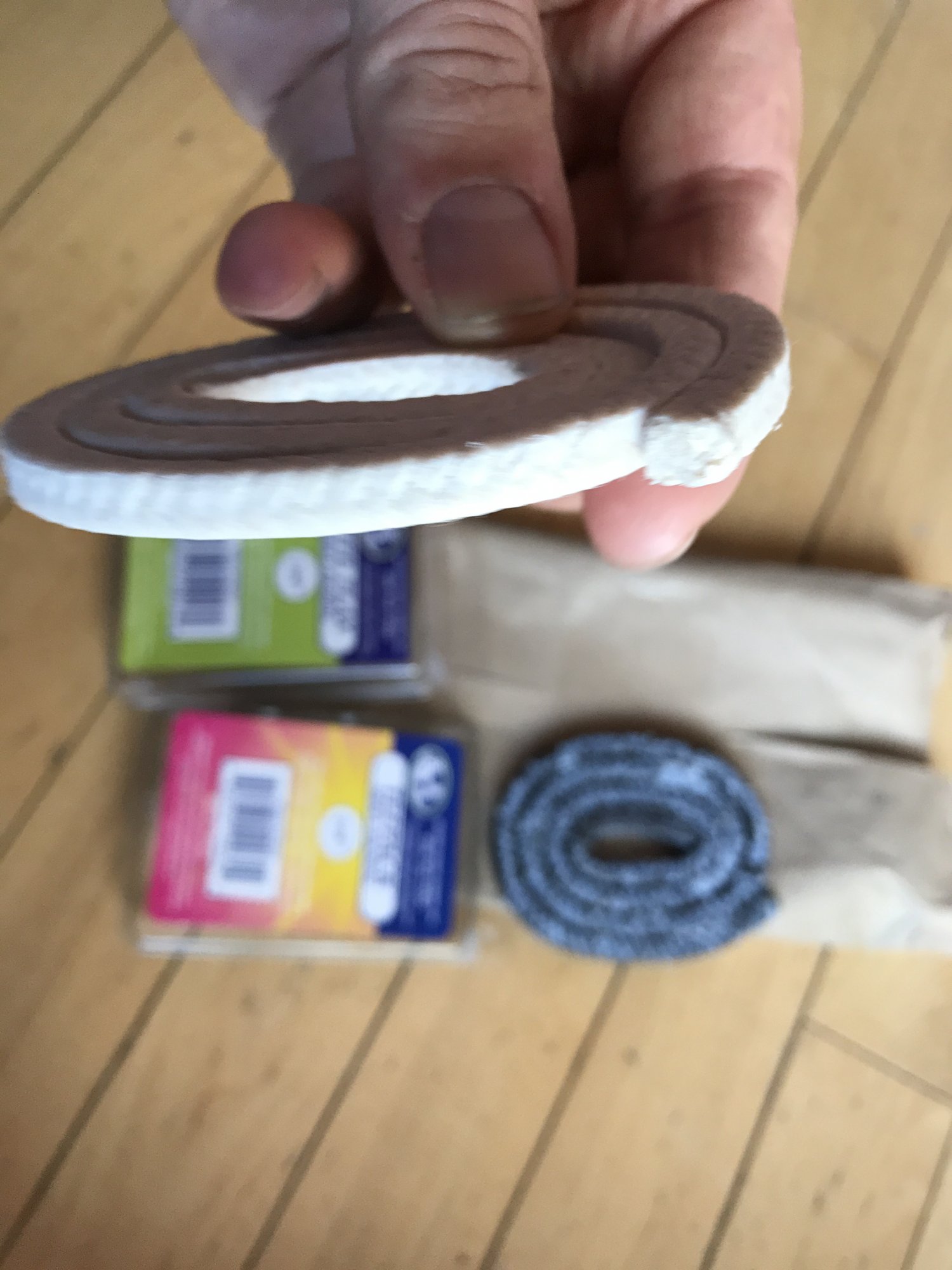

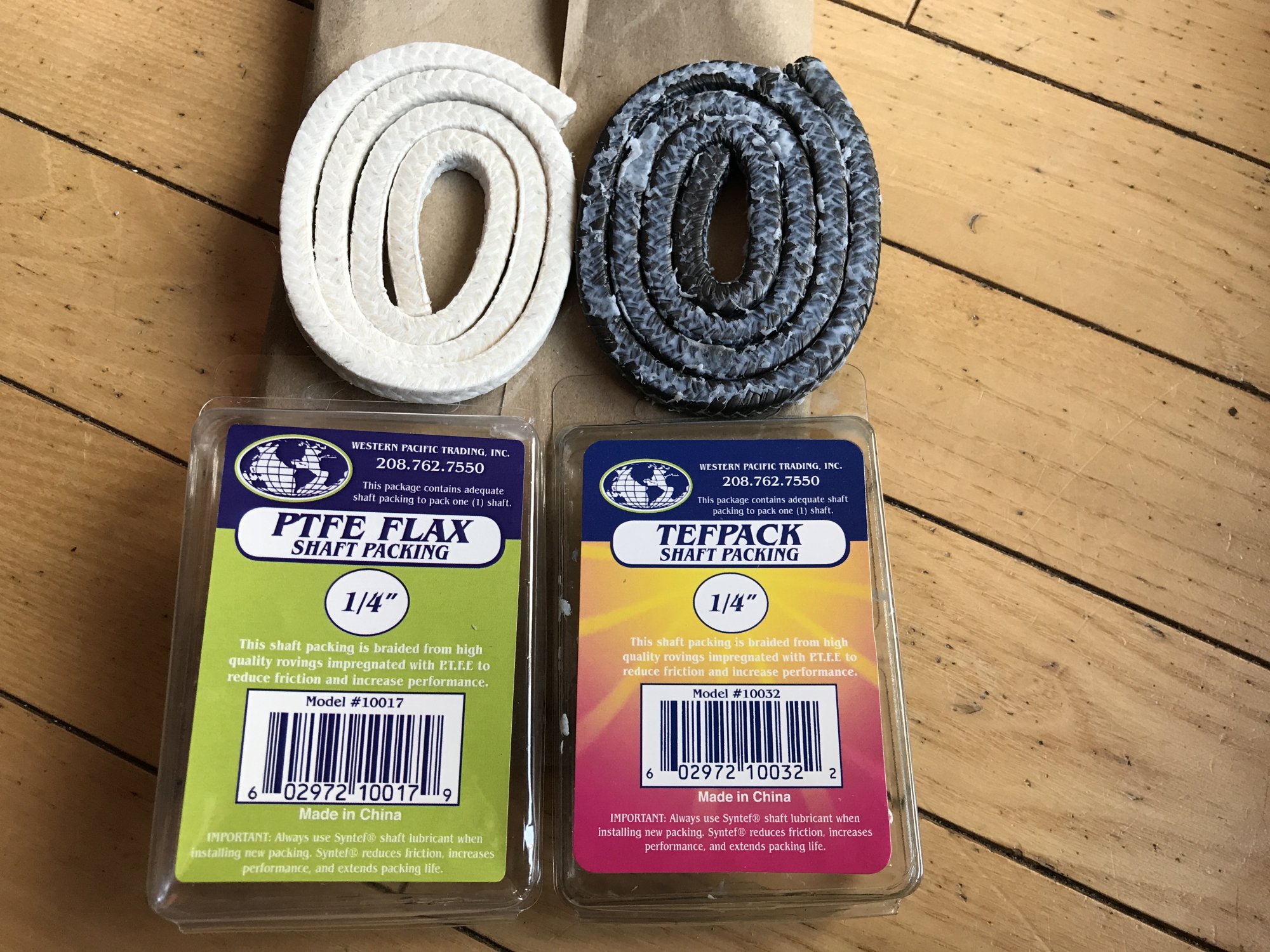

I went ahead and ordered both traditional flax / PTFE packing, as well as the TefPack synthetic so I could compare them, as neither is terribly expensive. Going by the adage I’ve seen posted in several places, that any packing that’s black/dark gray in color is graphite or graphite impregnated, it would seem the TefPack must be graphite based stuff?
It seems strange to me, since Western Pacific also has their GTU which they specifically note as having graphite, why would they also offer TefPack As a “synthetic braid” with no mention of graphite?
I’m probably over analyzing the whole mess and maybe shouldn’t be so worried about graphite with a stainless shaft and two brand new zinc anodes? I just want to make the right choice here and not cause myself more problems down the line!
I attached a couple photos of the packing for reference.
Thanks again for all the feedback so far!
-Paul
