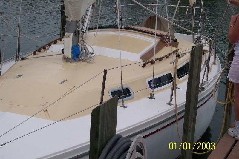

Has anybody replaced their teak trim that is about a 1/2" wide and runs over top of the cabin ports? Mine is starting to split. I was also thinking of removing the teak, epoxy the holes and putting a pin strip instead.
23,129
We call them the "eyebrows." And yes, some have replaced, some have added the stripes and some have completely removed all traces of them.

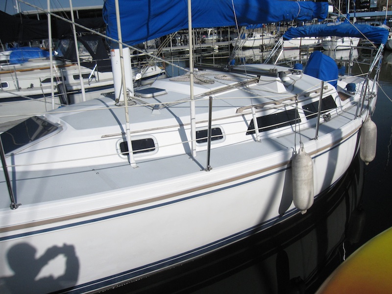

I removed mine. They are a PITA to keep looking nice. I simply put a new s.s. screw and trim washer in each of the screw holes. I think the boat looks a little cleaner w/out the "eyebrows".

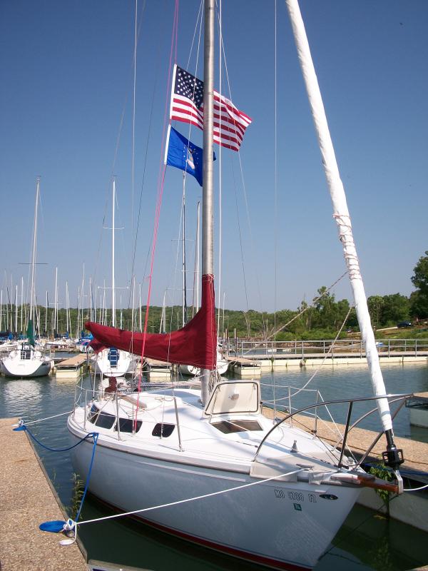

When I rehabbed my 1976, I left a LOT of the exterior teak off. The eye brow strips on each side of the forward cockpit, the piece on the sliding hatch, and even the external hand rails. The boat looks just fine without them, and I don't even miss the handrails when going forward!

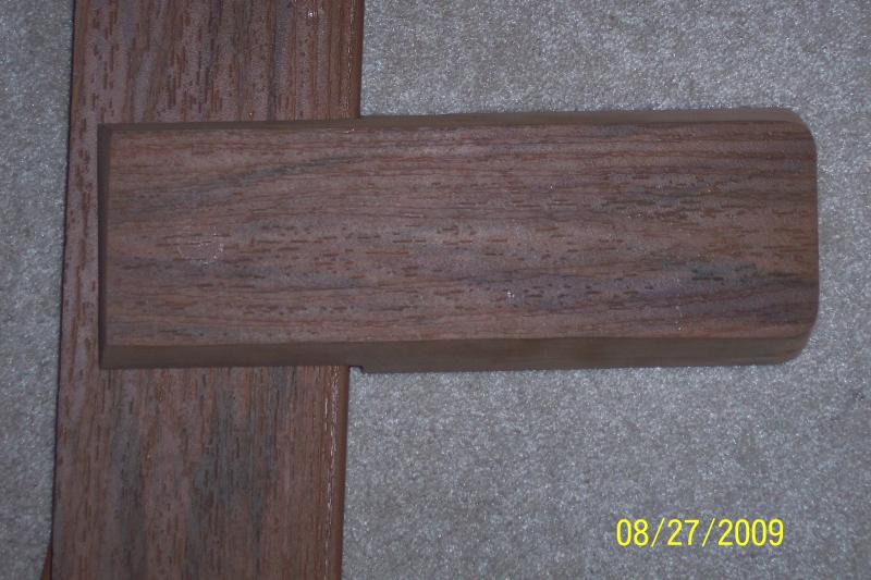

Years ago I got fed up with having to re-varnish my wood on top, especially the handrails on my 1980 C30. I also found for me and guests that the forward handrails at times caused tripping problems when doing work at the mast with sails lines boomvang etc.
I removed them about 10 years ago under a promise I made to myself, that if there ever came a time where I wished I'd had them, I would put them back on.
Two years ago, One of the summer thunderheads roared down on us. So on a wet deck, 35KTS w/seas building I had a helleva time getting my main down. All my guests had no sailing experience so I kept them seated in the cockpit.
Well, I slipped a bunch of times, once to the deck by the shrouds, almost going o'board. I remembered what I said and planned to reattach them, but with alittle modification.

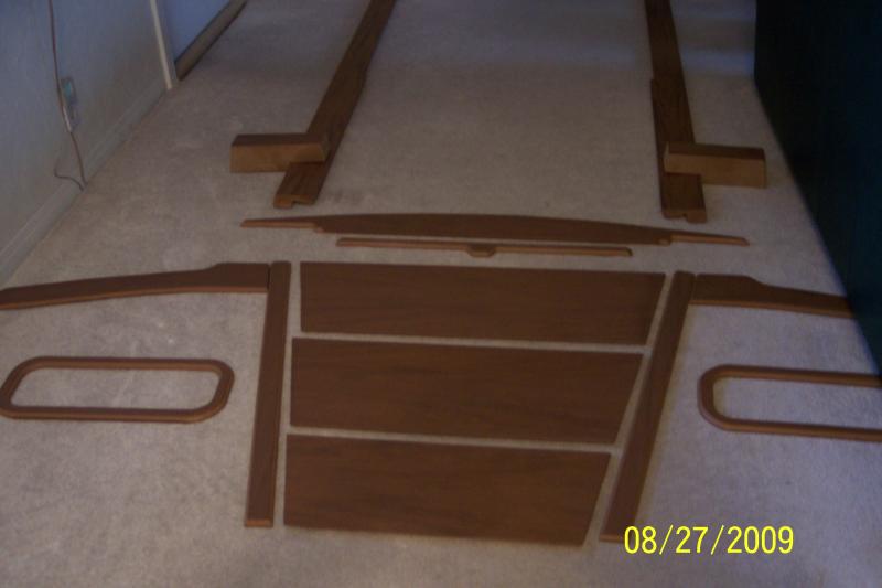

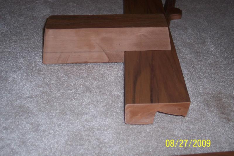

I always tell folks who have varnishing questions, that "Life is too short to having to redo your own teak constantly". I found a PVC material called Sensibuilt on the Fiberon site.
http://www.fiberondecking.com/products/decking
They make fachia & decking that look closer to teak than what I've seen out there. I removed all the wood and copied all. Easy to work with. Some are tricky, but you may find a good wood shop to make them. Fiberon makes a brush on finish for cut edges but as the product was new, I didn't like it Routered edges come out nice & smooth.
I used MEK for "melting" the edge cuts, but after awhile it got a little chaulky looking. Maybe Fiberon has a better solution nowadays. Other than that, it looks great & no more EXTERIOR varnishing, except the shortened handrails.
Here's pics on how this stuff looks......

I've worked a bit with Trex and found it can get "bendy" if left unsupported for a while.
I noticed you made your hatch boards out of Fiberon. How have they held up? Any warping?
BTW, stuff looks great in your pics.

I did have the same concern about bendyness.
I figured that if I made the slats & they were not ridged enough, that I would epoxy stiffeners on the inside. That was the plan.
I also wondered if direct sun/heat would cause a sag, but so far (2 years) I have not experienced a problem with rigidity at all pal.
Let me know if you will try this stuff....
