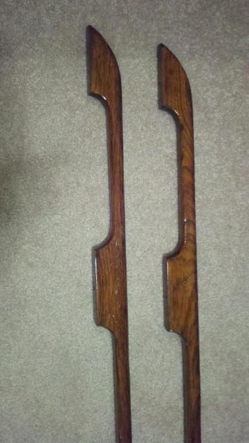

I wonder if my thirty-two year old rails would still be as strong had they been oiled instead of varnished? It is probably just preference but I like how my rails look after a couple of coats of varnish. Pictures don't do them justice. You have to see them sparkle in the sun.
Yeah guys, I know how I whined about the southern climate destroying my teak.
