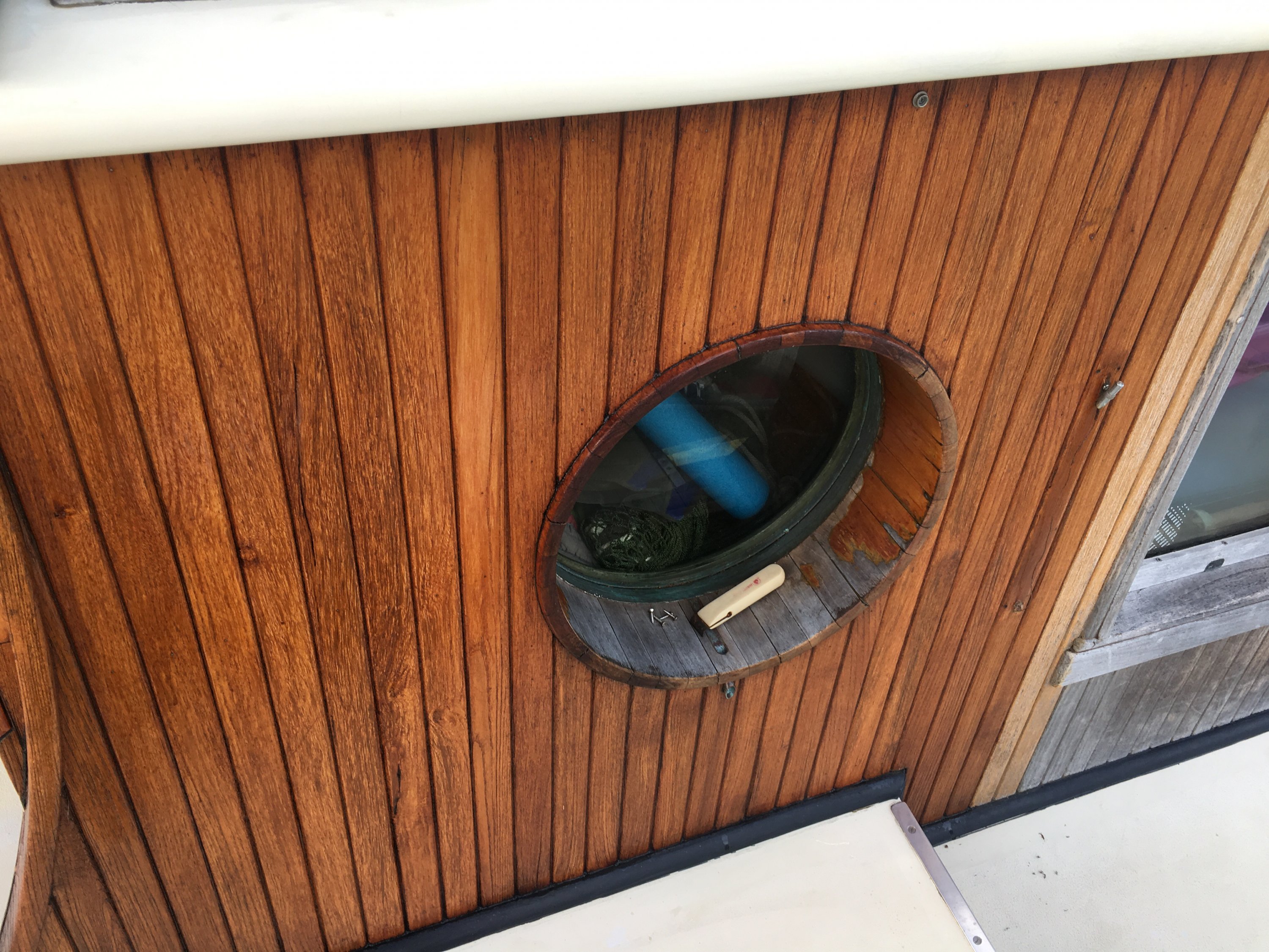

V, no "stain" is needed on teak. It you want to see what it will look like when varnished, just liberally moisten a cloth with mineral spirits and wipe it on your newly cleaned and sanded teak. You'll need to do this anyway to remove the dust prior to varnishing. While it is still wet with the mineral spirits it will show the color that the varnish will bring out. Below is a photo of our in-process teak. To the right you see the old finish, before cleaning and sanding (grey), then a strip of sanded but not yet varnished teak, then most of the picture is of the newly varnished teak, with just the first two coats on it. There will probably be 5-6 more coats before we are finished, but the varnishing is the easy part. Getting it to the point it can be varnished is the time consuming part, but it is the critical part!
