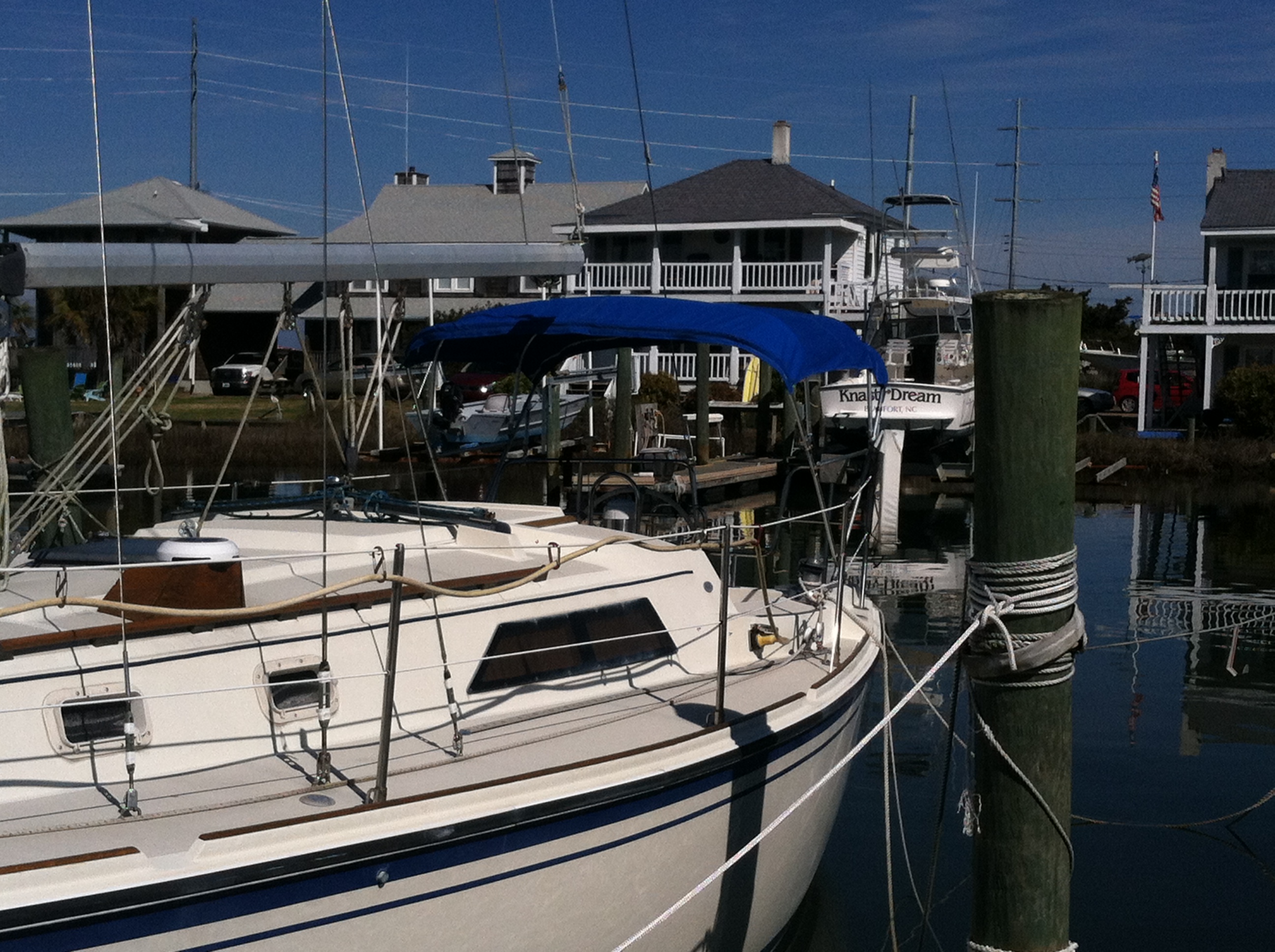

Sorry for the delay but I finally got a few pictures of the finished eye brows with ipe. They will get a few coats of cetoel this year. They have held up well but there has been some splintering at the area of greatest bend. It has sanded out smoothly but maybe the wood should be bent in this area when it is installed.
