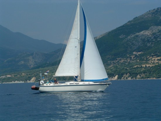

Hallo my dear friends, I've been brainstorming about the possebility of putting a teak deck on my Oday 37. Is there anybody who knows something about this. Is there anybody who ever done it. If there is somebody out there who can tell me anything about this subject, please give me a hint. Regards Martin Bosman

Just don't. Looking at your photo your boat is at least 22 years old. As is, it isn't worth the cost of a teak deck, which would add virtually nothing to its value. Yes, it would look great. But it adds weight high up and is the devil to maintain not to mention to install.
