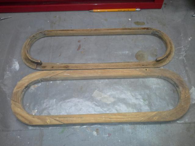

Gday guys. Doing the final touches on the reno of our '81 C22. Complete redo of topsides, new paint on deck and hull, finished re-upholstering the cabin and cockpit cushions. Got crazy (~ier) and pulled the topsides teak for strip down and and new Cetol application so everything looks like new. BUT the teak coamings in the cockpit are not look too flash. One almost disintergrated upon removal, the other I have restored pretty well (at least I think so). I may be able to restore it but in reality I think it's a big ask.
So to the question... does anyone know where I can get another set. I believe they are a standard size. Perhaps someone is parking out a boat or knows of someone, or if there is a company that sells them. CD has only thecwhite vinyl. Good price but I am on a mission to have this boat back tonits classic trim so teak preferred. 1 would be ok but 2 better so the trim matches.

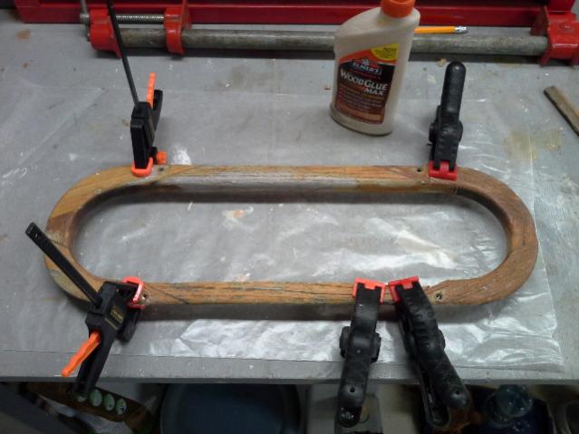

Cheers Don. That sounds like a great plan, if I can re-assemble the starboard coaming from its many current pieces. Port side would be an ideal candidate for your technique as it is now glued back together and looks almost new. Will give your idea a shot if I can get the Starboard coaming to any appreciable state.

Cheers guys. CD has discontinued the teak coaming trims. The factory that made them, (out of a single solid piece of teak !!) went bust (i wonder why). CD now only offers the vinyl version. Not my cup of tea as I want this boat to be looking like the classic she is. So, I have taken y'all's advice and recontructing the old ones. Thus far, I have pieced the bits back together with wood glue for now, then sanded them smooth. Waiting on delivery of my WM epoxy resin then will soak in resin and resin then finish with cetol. Amazed how well they have come along so far, given their state when I pulled them off. Pics of progress attached, more to come. Appreciate the tips guys !
Cheers
