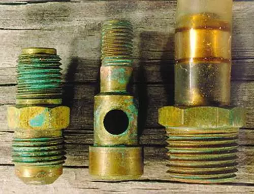

Anyone know what type of corrosion this is? And how best to get rid of it?
It is slightly more green than is shown in the picture. It is quite spongy, and almost feels as if it could be brushed off the chain farily easily.

It seems the green stuff is algae and the black swirl could be dead bacteria. Old diesel fuel is prone to having biological growth. Can you access the fuel pick up tube? There is a mesh filter at the bottom and it could have gotten partially clogged. That engine cut off is likely an indication that at some point in the fuel system there is a partial clog. If you can remove the pick up tube, inspect it an clean it, Inspect and replace both the primary (water separator) and secondary fuel filters. If the replaced filters looked OK and like you say the bottom of the tank looks clear then you may add a diesel fuel stabilizer. The ideal preventive measure would be to have the fuel polished. Have no idea how easy or costly would be to engage this service at your location. In any instance add a fuel additive, keep spare filters on hand and continue to be attentive to any fuel system related issues. Bad fuel can be gotten rid off but a dirty tank is something that can cause many problems. A dirty tank will usually manifest itself when you hit some rough waters causing bottom sediments to mix with the fuel and be pulled into the fuel lines.

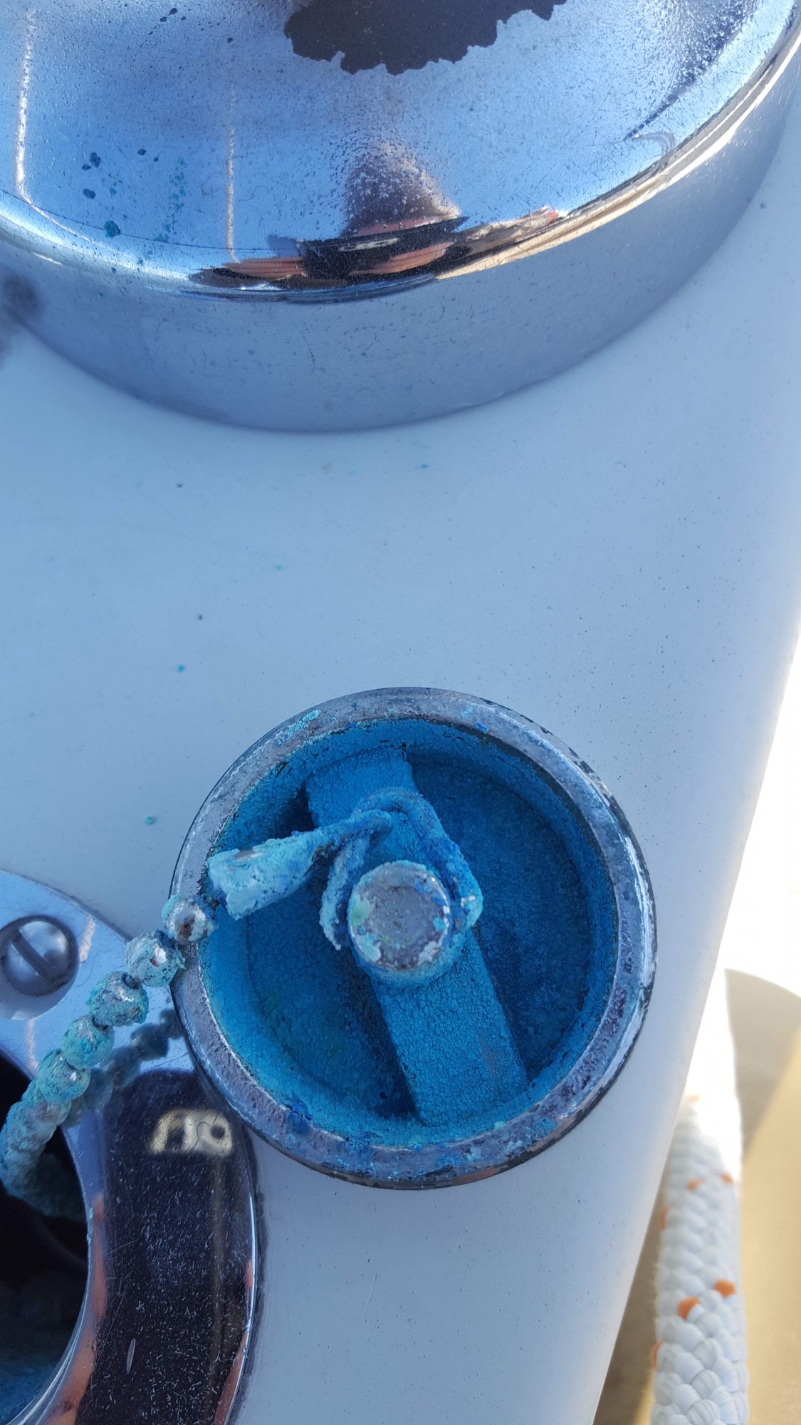

The corrosion looks like a copper sulfate corrosion. It occurs on boats when marine salt filled moisture connects with copper in a boats metal parts.
On my boat is it shows up a little more greenish blue then the pure blue of CuSO4 Likely a result of other impurities in the process
Clean it up and be sure you have a good seal on your fuel cap. Perhaps the O ring is worn or missing.

Jsailem - thanks v. much for the info. That corrosion looks very similar to ours. I found it could be removed fairly easily with a rag dipped in diesel. We inspected the tank (not bad for its age), put an additive into the fuel and and changed the fuel filters. We have an old CAV 296 filter at the moment, but Racor does seem the way to go. Another job to add to the list...
