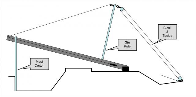

Let me try to answer based on my 2002 H260. There may be slight differences with your boat.
1. If there is a secondary jib halyard, use that. Otherwise use the main sail halyard. It will have to wrap around the mast, but that won’t cause a problem. The pelican hook at the end of the halyard clips into one of the loops on the outer end of the gin pole. Clip the upper end of the main sheet block and tackle to the other loop on the gin pole. When the gin pole is inserted into the hole in the base of the mast there is plenty of play, so cleat off the halyard to set the gin pole at 90° to the mast. Cleat the halyard where you normally would. (on the cabin top for me)

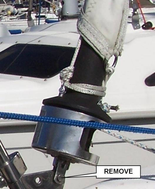

2. There is a clevis pin and retaining ring or cotter pin at the very bottom of the roller furler where it attaches to the bow. Remove these when you are ready to lower.
3. The gin pole is a slip fit into the mast. No pins.

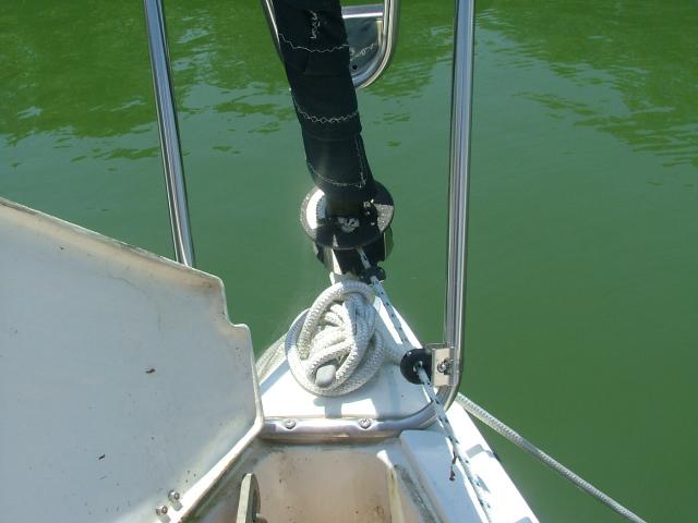

Checked the boat out today and it appears that it has everything but jib helyard. Look at this picture to see what I am talking about. Also I have two lines going into the mast from cockpit. I know one is for the main sail, but what is the other one for. thanks, david
Apr 1, 2004
178
Diller-Schwill DS-16 Belle River
Looks like your jib halyard is being used at the top of the jib. You will have to remove your jib to use the halyard. Just like on the big boats. A picture of the furler at the stem head will confirm this.

thanks for input. that is my main concern about the where is the jib halyard. Is the schaefer roller different from other fuelers? It looks like to me that the jib is attached with two things at the mast. I think the the halyard is one. Does the halyard go all the way through the roller to near the bow? thanks, david

troutsmustang,
I went back and gave your pictures a closer look. I does appear your RF is connect to the mast and the jib halyard is holding the sail up. That's different from my RF (there's a halyard integral to the RF). I'm a belt and suspenders type of guy when it comes to my boat, so bear with me.
You might go ahead and secure the main halyard as I discussed in my earlier post (this is probably just a precaution, but...hey...beats the alternative). Just hook the main halyard to the anchor locker, then run to a cleat (midship cleat should work). This will ensure the mast doesn't fall regards of the rigging.
Once you've done that, unfurl your jib. With someone holding the sail, slowly lower the jib halyard. If things work right, the mast will not move and the tension on the RF will remain the same. If the sail comes down, you'll have access to the jib halyard. Unhank the sail from the furler. Then proceed with the instructions above for lowering the mast (don't forget to release, slowly, the main halyard).
You might have someone look at your RF to see if it has the provisions for an internal halyard, thus freeing up your jib halyard. Or, you might try running a gib halyard (should be provisions for two halyard blocks up there). Either way, you don't want to have to constantly unhank your sail to lower the mast. I'll try to take some pictures of my RF for comparison.

Primary steps to prevent mast from falling.
1. Remove jib.
2. Rig gin pole with jib halyard and main sheet. Tension rig.
3. Release roller furler.
