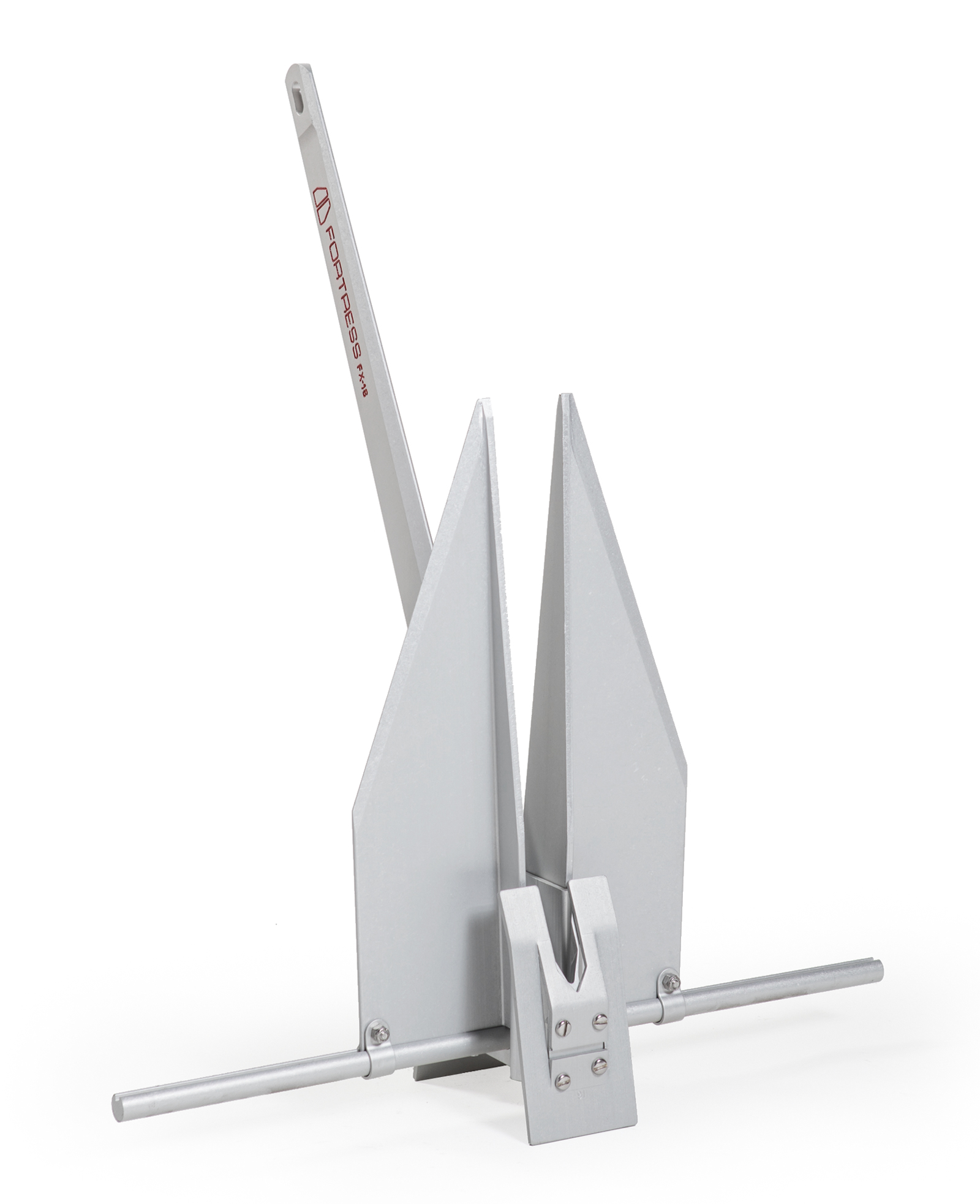

I have a 36' Hunter monohull with a 30lb bruce for my primary anchor. I just purchased a Fortress FX-23 for my secondary anchor, and I need get chain and rode. Any suggestions for what would be appropriate? I'm in the Salish Sea. I was thinking ~40' 3/16 chain and 150' 3/8 rode.

Fortress recommends 6 feet of chain for every 25 feet of water. Excess chain weight will interfere with the anchor setting as the weight of the chain will bury the shaft.

You probably only need an FX-16, but a 23 is good for very soft mud. The 23 will be hard to set in firm bottoms.
You need 1/4-inch G4 chain. 3/16 is not enough. Used as a secondary anchor (kedging or as a V) you really don't need chain for chafe, since the boat is not swinging. 10-15 feet is enough, or even less.
3/8-inch rope (not rode--the rode is the entire rope-chain combination--calling the rope portion "rode" is confusing and is a pointless nautical flourish) is too small for an FX-23. 1/2-inch nylon. Length depends on where you will anchor. 150 may be a little short, because you need long scope for kedging and when using minimal chain.

Perhaps the FX23 was overkill, but I got a killer deal on it and figured 36'7" LOA was close enough to its rated 39'. A bit more rope shouldn't be a problem.
