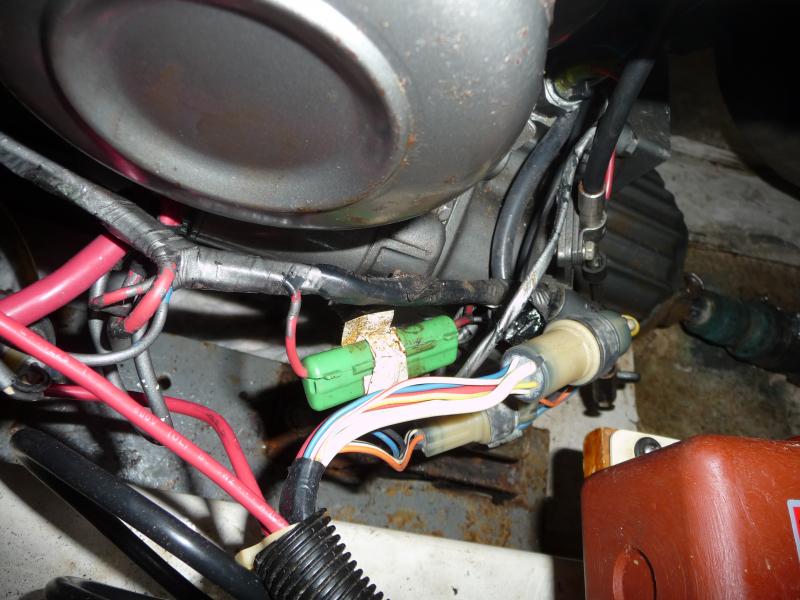

Tacho Connectors
Claude is right ! There are a couple of multi-pin connectors in the tachometer circuit. These get a bit loose and corroded.. I have cleaned 'em with rolled up fine sandpaper and some spray cleaner.. Check all of them from the engine sender back to the instrument.. Picture shows the multi-pin connector at the engine .. The sender is at top right next to the edge of the air cleaner housing .. Picture is looking down and a little aft on port side of engine. There is another multi-pin connector close to the instrument panel.
