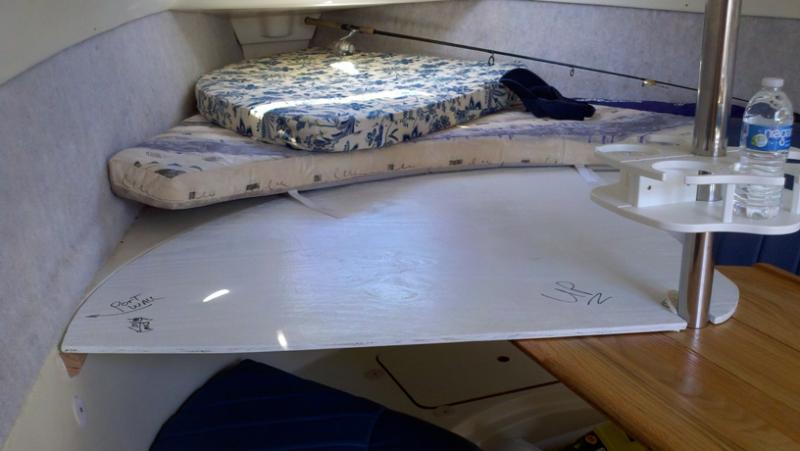

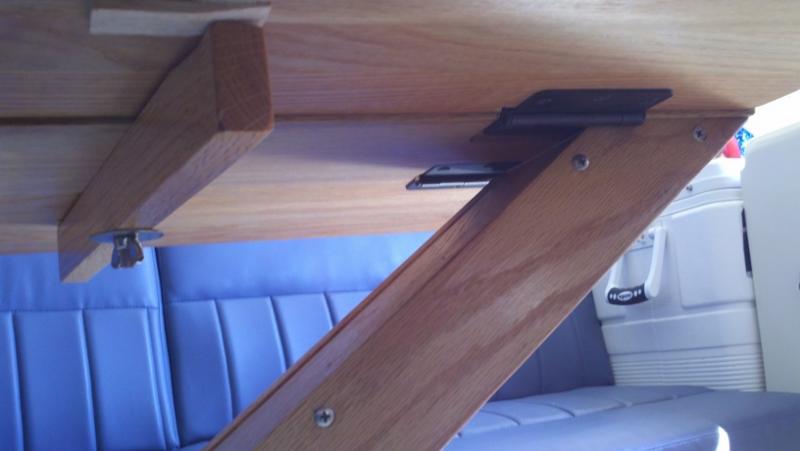

Here you go. My cabin remodel job. Good luck.

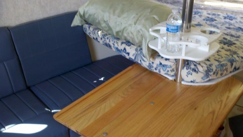

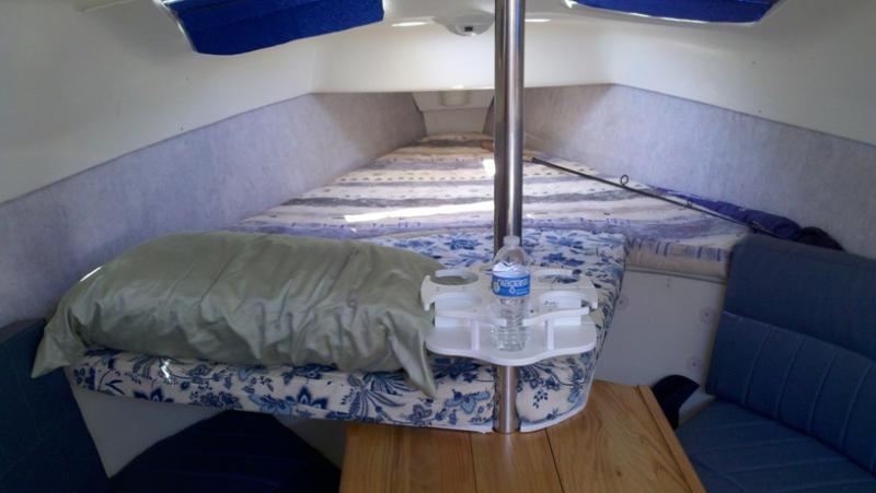

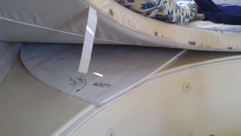

When I finally replaced the banquet table in our 260 with a reasonably sized oak table with leaves it changed the whole interior space of our boat. I set the table at the perfect height needed to align with a new insert that fills the gap from the v-berth groove, back to the compression post and over to the port wall.
This was my solution to the often discussed table issue and it now allows for two friendly adults to sleep very comfortably in what amounts to a full sized, 3/4 bed when the easily stored filler piece is in place. The pillows are set between the port wall and the compression post so 75% of the guests weight is on or right at the V-berth section or the compression post.
The insert is 1/2" 4ply which can span the gap without any bracing as long as our fwd bunk guests aren't porkers. Because there is no bracing I can simply slide the whole section under the v-berth padding and slide the 4" foam that fits the added section up on top too. This allows for utilizing the whole couch-like salon seating.

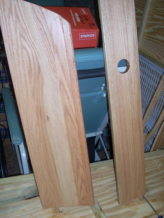

The table leaves are oak stair treads from lowes with a little hardware and some other 1x6" oak boards. It bolts in 3 spots, strong as an ox and comes right out if needed. pretty basic. The comp post drink holder solved a constant spill problem and frees up table space. There was also a short(18") section of foam that fills the port side seating back rest that we made too.
It was a summer project in 2010 but it was a fantastic improvement for sleeping and cabin roominess.

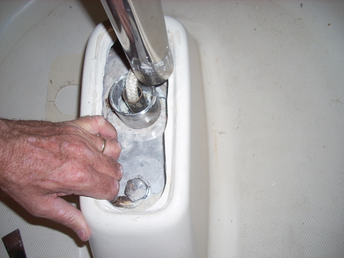

You certainly don't HAVE to remove the post but it seemed easier than working around it and figuring how to patch a piece in the table to fit around it. Any patch would be plenty strong but That's just how I went after it to save the original table too(who knows why).

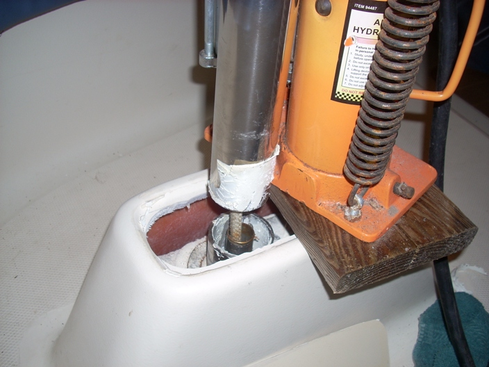

Once I looked at it I simply removed a few screws up top in the mast base and put a small jack on the post from the inside to ease it up. It was so easy that I wouldn't hesitate to do it again, really. My '04 was a caulked fitting at the base plate with no set screw but some older ver had a set screw so just check for that and go for it. Just getting started was my biggest foe on this job. It went very easy once I got past the indecision.
The post doesn't have to come out for the CB line replacement by any means. It sounds like your lowered CB scenario is simply forgetting to pull the CB up after a long day instead of the unlikely slip of a rope clutch. I've done it a dozen times.

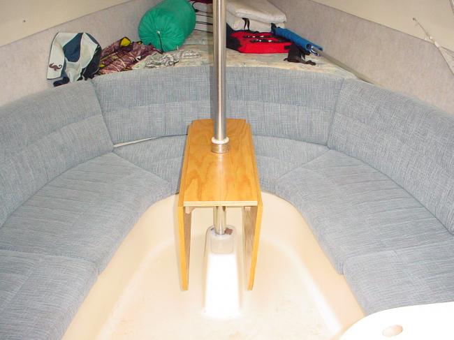

Here's a couple more pics to encourage you and one of a table mod from someone else that got me motivated. I don't know whose it was but I give him all the credit for helping me see what was needed. The leaves still seemed a bit long so finding the replacement oak stair treads at lowes with a built in edge cinched the deal for my width. Adding the V-berth insert seemed appropriate while I was setting the table height so a proto type got thrown into the project and ended up being a very successful permanent fix. Sometimes I get lucky.

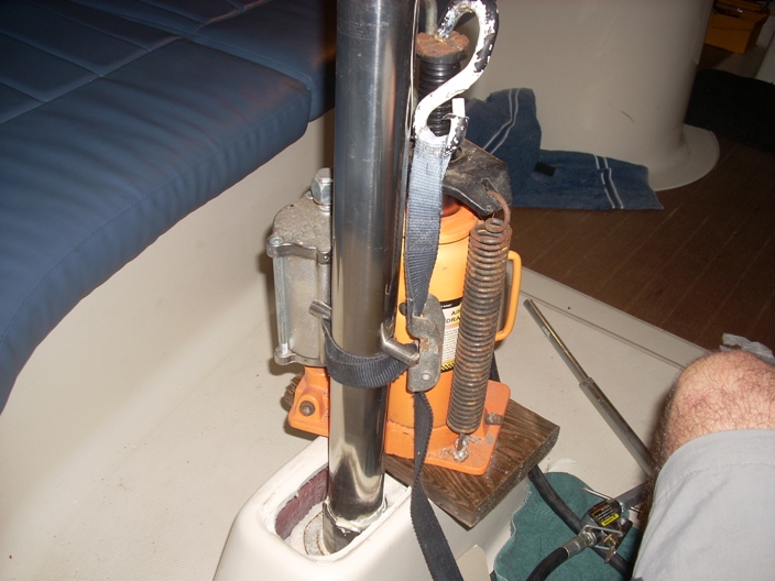

OK, dumb question time. What is the jack lifting and how is it rigged?
Aug 9, 2005
825
Hunter 260 Sarasota,FL
To apply a nice easy pressure I blocked the base of the jack down to the CP base plate(not shown in the staged pic), wrapped a stout tie down strap around the post at the old table pin and applied upward pressure. Obviously make sure that all the screws are removed at the tabernacle and that the CB line is released, and it'll come right out.
A hydraulic jack is probably over kill but why struggle. Just be aware if there is an abnormal amount of pressure required, then you may have missed a screw or whatever.
