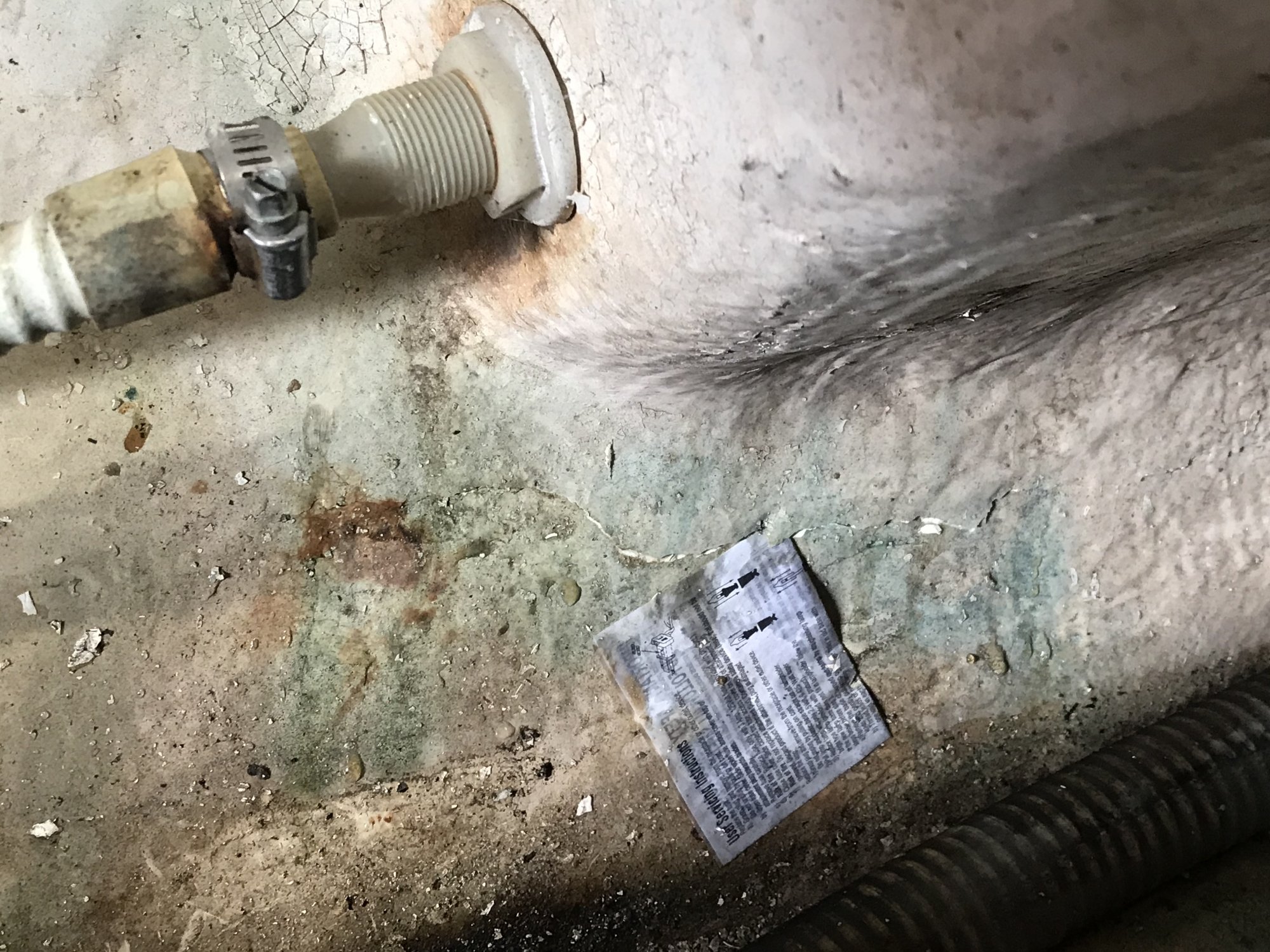

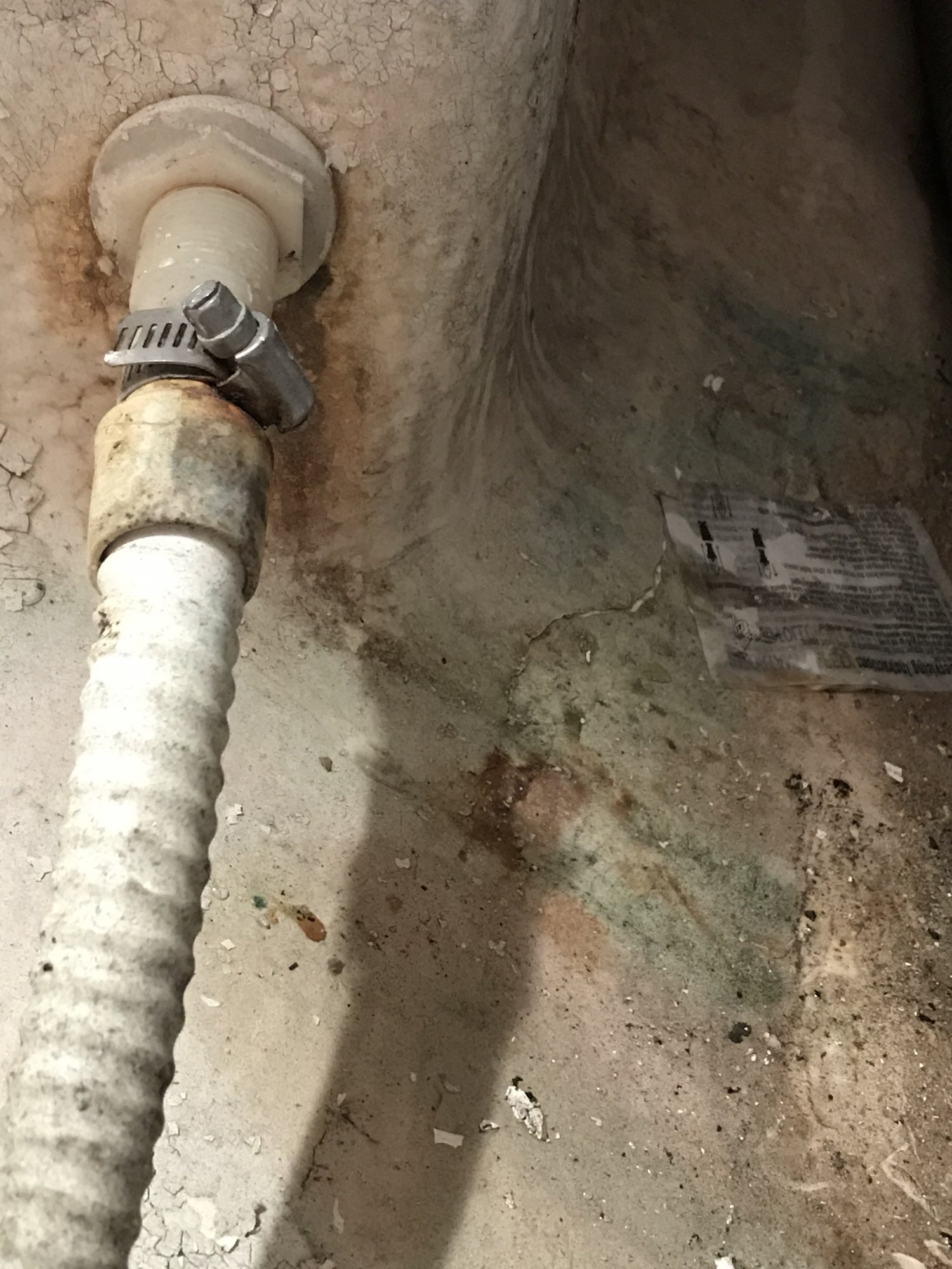

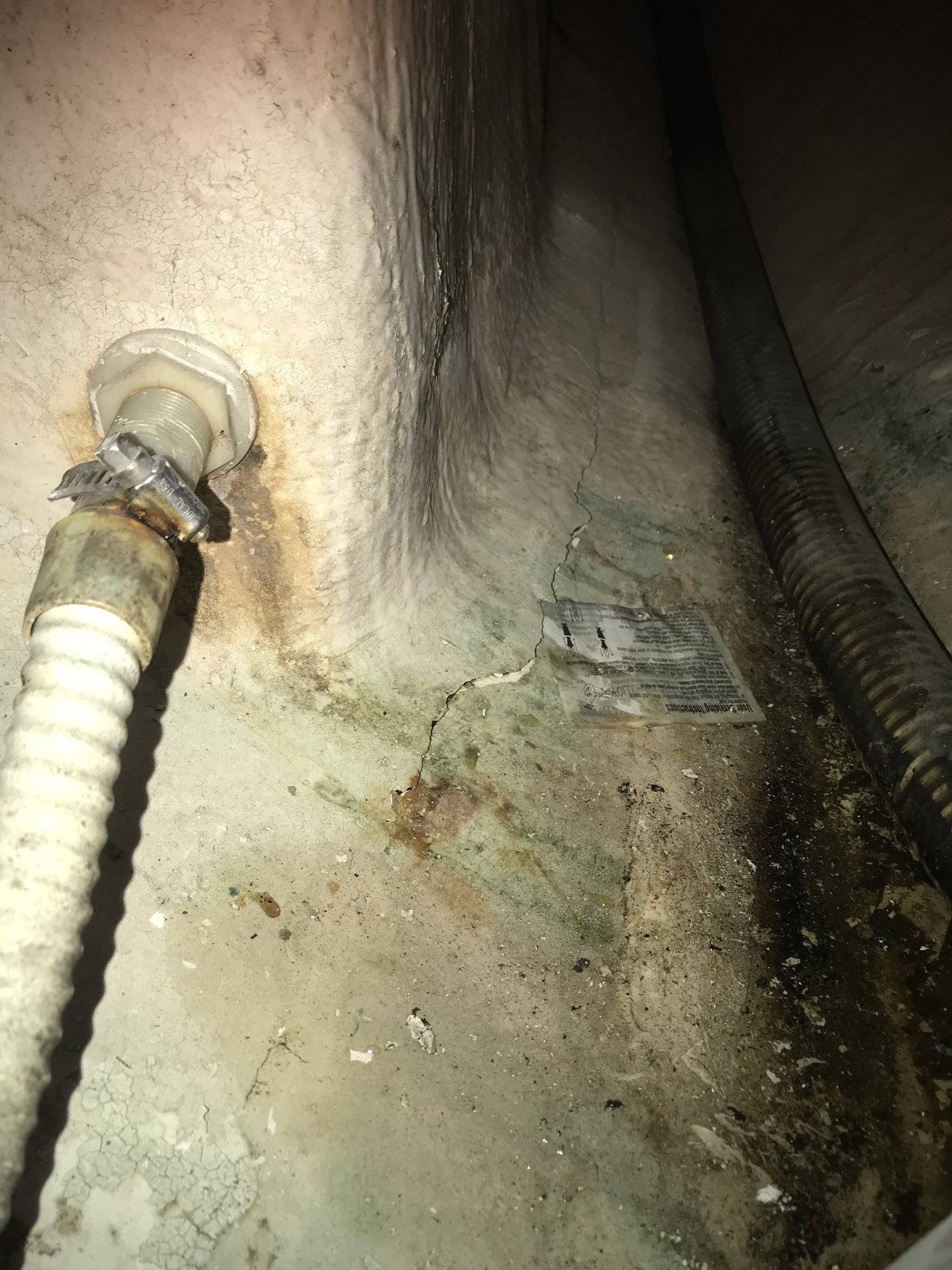

Hey all--
Hunter 27; it's the tabbing on the water tank port side v berth.
Doesn't look structural (but concern it might be?) I went to the office and let them know. GM is going to take a look.
Back in stands the crack is now closed up.
Launch? Get them to fix?
13,061
Tabbing is usually structural, it keeps the parts tied together. Is this the model with water ballast? If so is this the ballast tank?
Fixing it would be a goo idea.
Its the fresh water tank, that I don't use; a triangle that that makes the v berth bed

That area of a boat is a relatively high stress area. Think about the times you crashed over a wave. It should be fixed.
Yep thanks for the reply. I made a no-go a little while ago, I'd much rather keep my crew today safe.

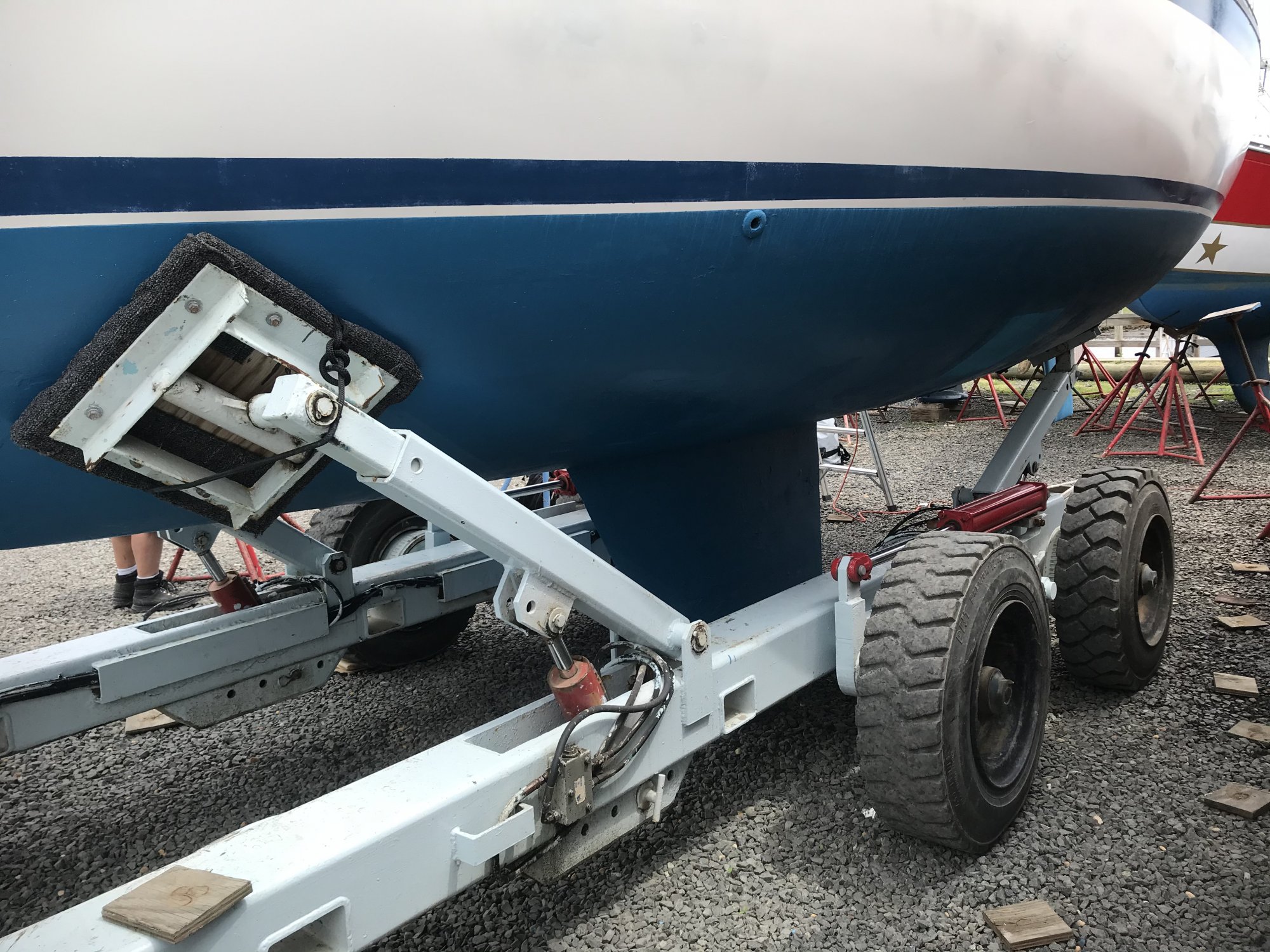

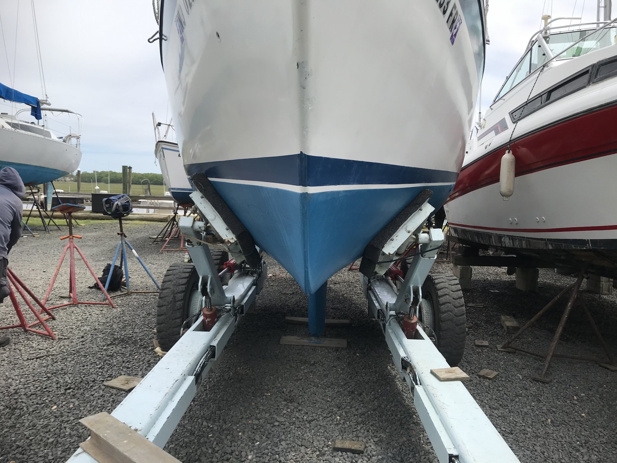

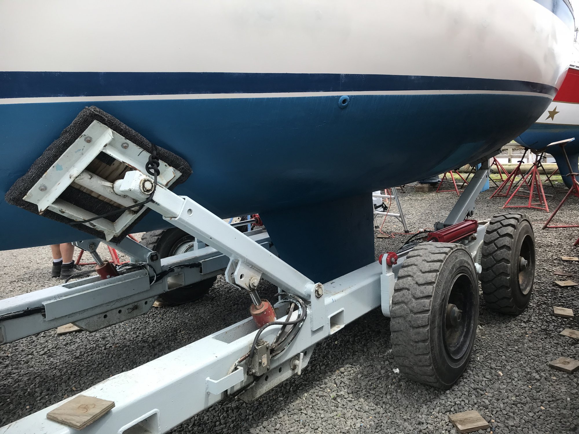

Port side is where it cracked, the boats off kilter and it's low. I was on the boat when they picked her up.
This pad is forward of the bulkhead and directly ahead of the athwartship aft wall of the tank
13,061
The pads aren't perfect, but they are close enough. It is always best to pick boats up at the strongest points which is under the bulkheads.
I suspect the tabbing had a weak bond from the get go, and it is only now that it finally showed up.
Many marinas have stickers placed on boats that show the lift points. You might want to consider putting them on your boat.
Good luck. Hope things work out OK between you and the marina.

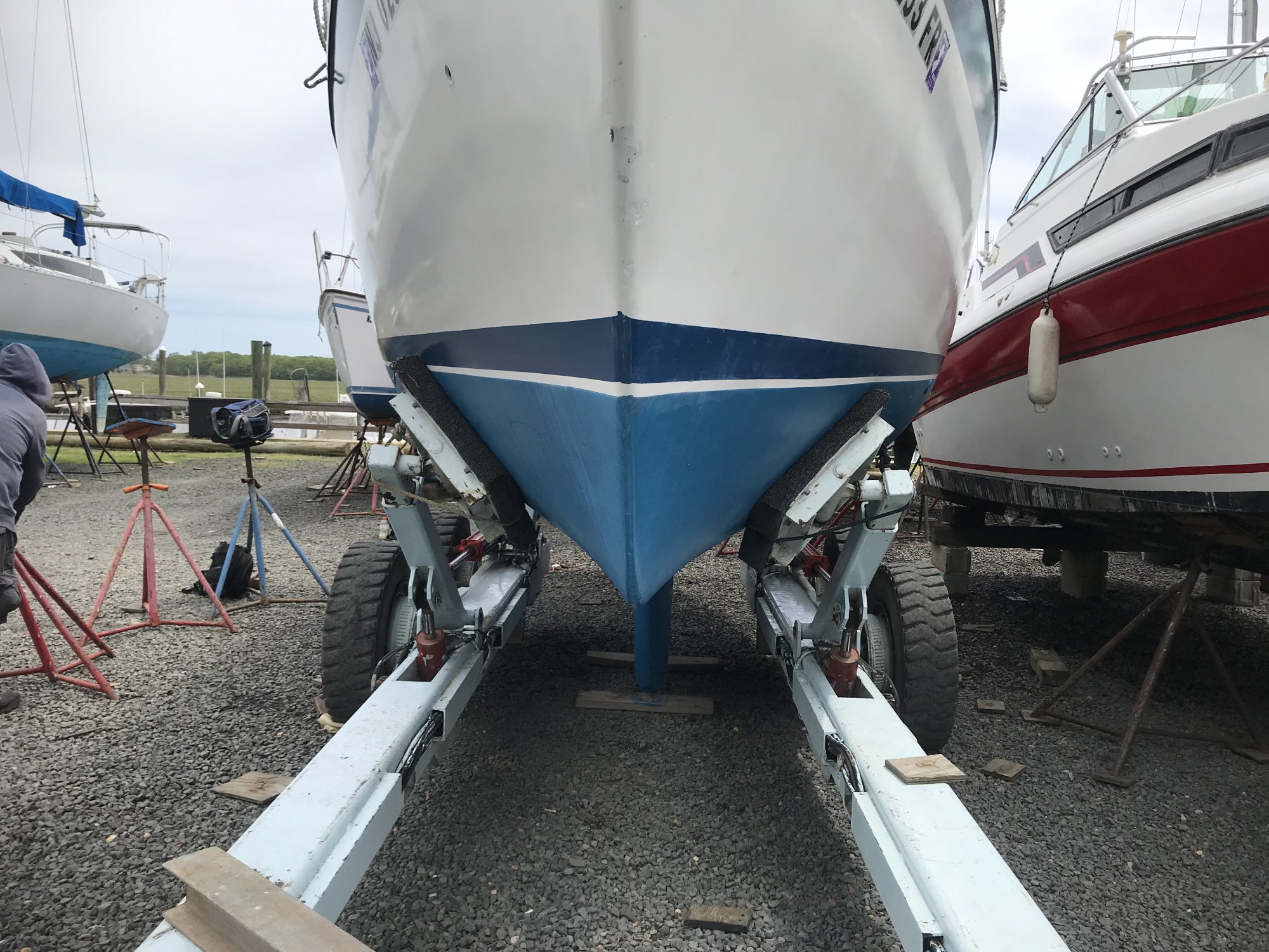

Where is the keel support? There should be a strap under the keel that is pinned to the trailer frame to take the weight of the boat. The pads only stabilize the boat and don't lift it. You can see the holes in the frame of the trailer for the beams that would support the keel of a power boat, or the wing keel of a boat like mine, but I don't see the pins that should be on the top of the frame to accept a strap.

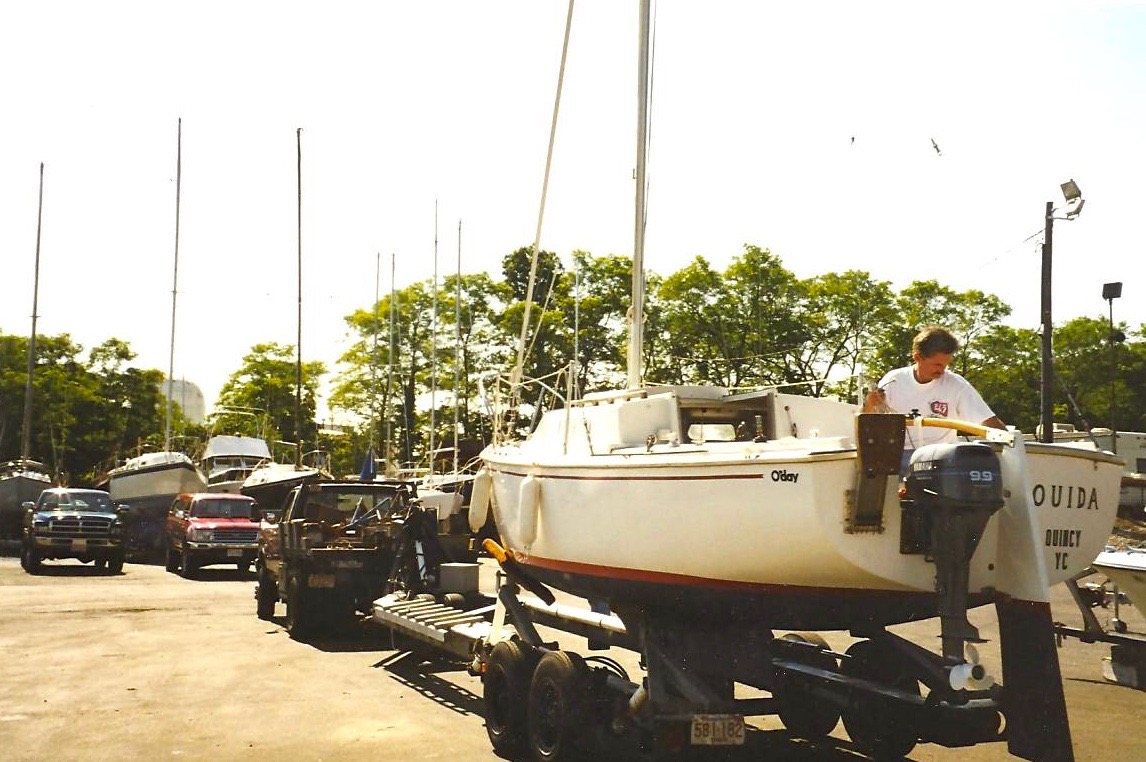

You can see in this old picture of my first sail boat, an O'Day 23, that there is a beam supporting the keel, and the pads barely touch the hull.
