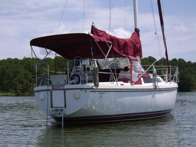

Congradulations on the new boat, she looks great. I see you have the walk out transom. Very nice!
