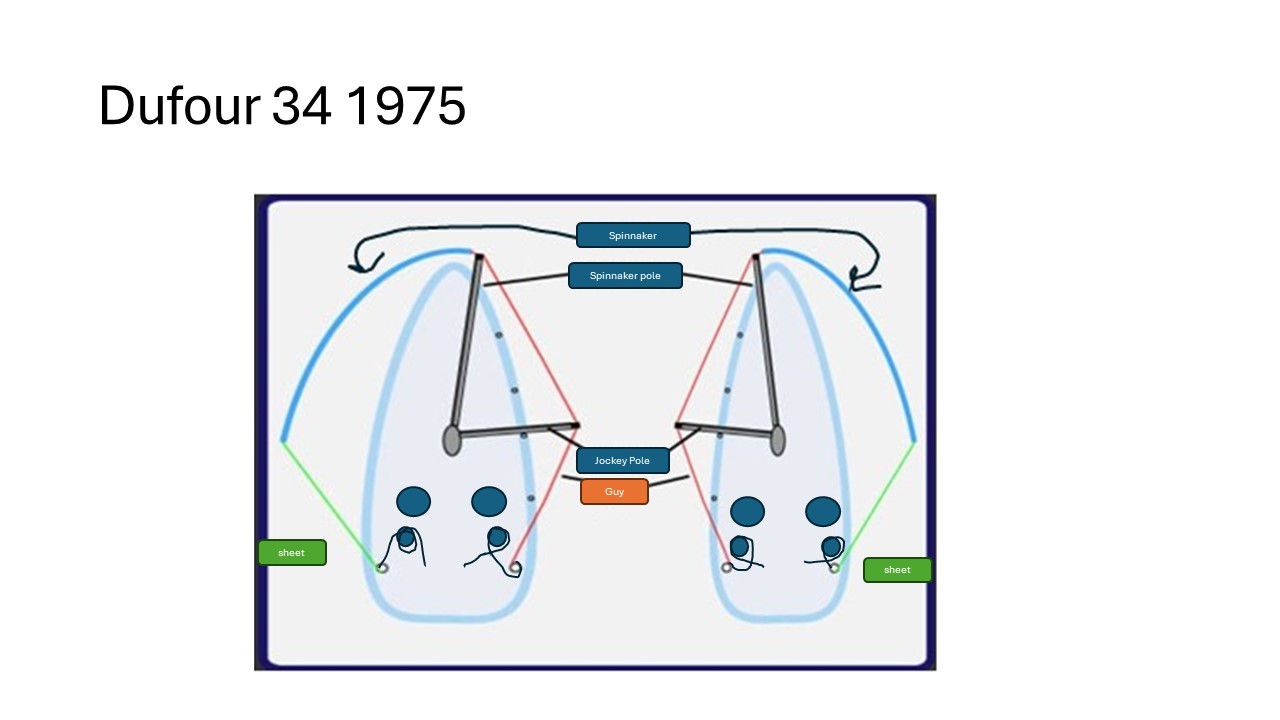

So can I gybe safely with the setup in the image attached.
When I want to gybe,
1. I pull the main sheet in to center.
2. I turn from a broad reach to more of a run
3. This releases pressure on the jockey pole, I remove it from one side and place it on "ready".
4. I detach jockey pole and remove it from the guy to the sheet in prep.
4. I gybe
4. I attach the pole back to the mast.
5. I deal with the main sheet.
6. I now attach the jockey pole to the guy on the "new" guy line.
7. I sail to victory and the loud chants of the crowd!!!

You’ve got essentially the right steps listed. You will probably need to deal with the jockey pole less than you expect. That pole’s purpose is to hold out the guy when you’re on a close reach so the guy has a better angle to the spin pole. When you’re on a broad reach or a run (as you would be if you’re gybing) the jockey pole isn’t really necessary.
Pulling the main in first can work in light air, but in a heavier breeze or when you want to be more efficient it’s not optimal. Often the helmsman will work the mainsheet through the gybe, pulling the boom across while the crew switches the spin pole.
