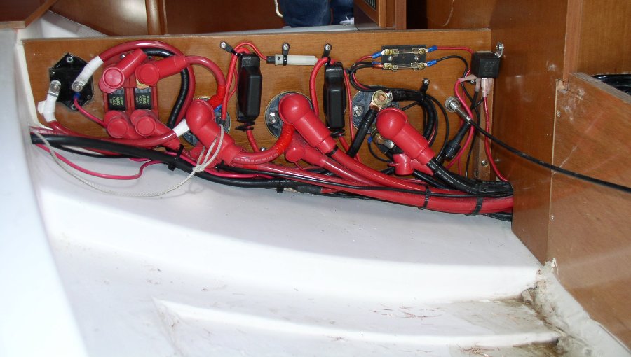

This is probably what your switch panel looks like. By the way, the stringer behind the switch panel is maybe 6 inches wide athwartships? At the aft side of that stringer you can custom fit a little bulkhead to keep things in the cubby behind it from hitting your switches. I used that added panel to mount the battery/Victron monitor. I believe the windlass breaker/switch is on the left.
