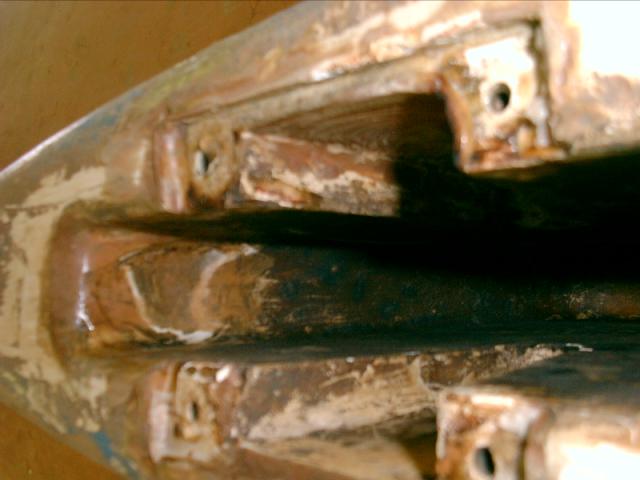

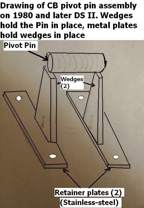

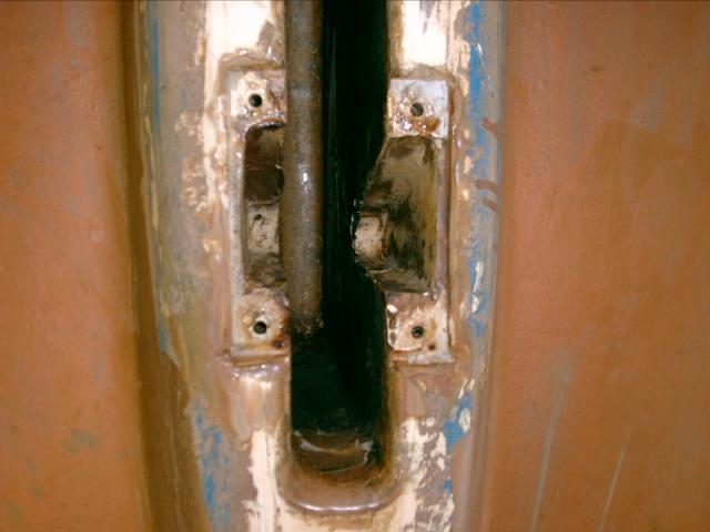

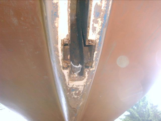

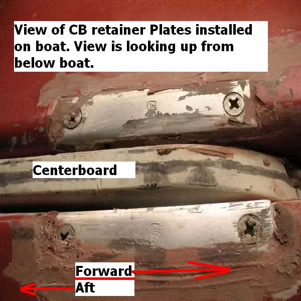

O'Day used an assembly of PIN, WEDGE, and PLATE accessible from the BOTTOM of the keel. The plate is held in by two screws on each side.
If you crawl under your boat, you will see the plates at the forward part of the centerboard slot.
The most difficult part is making sure you take your time to properly clean the phillips head screw slots so the screwdriver has a good grip. Some additional cleaning might be needed to have the parts slide out. Hopefully no one used any "permanent" adhesive in a past rebuild. There may be "some" adhesive/filler that needs just a slight amount of leverage to loosen.
The centerboard is basically fiberglass. (My O'Day 19 centerboard is 52 lbs.) So much nicer than those iron centerboards of most other makes. But it does need to be supported when you take it out so it doesn't drop on you!
While it is out, it is a good time to replace the centerboard pendant unless the pendant is known to be new.
