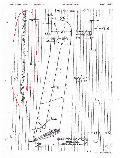

According to this 1983 dated factory print, the keel is 600 pounds. Short of calling Roger himself, I'd go with this information as accurate.
