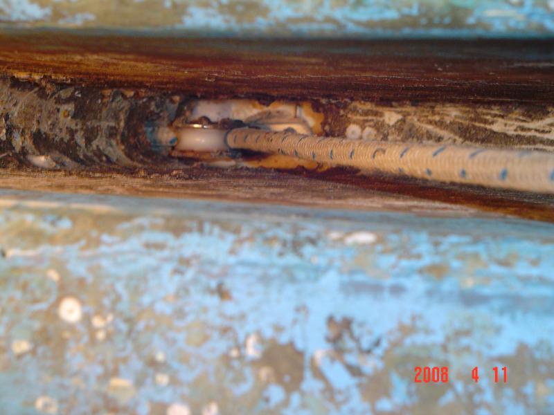

I've seen this sheave/U bolt assembly close up at D&R Marine in Assonet Ma. It resembles a bow eye with a sheave attached to it. This sheave assembly was inserted into the bottom of the keel with a long tool. Then a small stainless steel backing plate with two nuts were installed from inside the cabin under the sole plate.

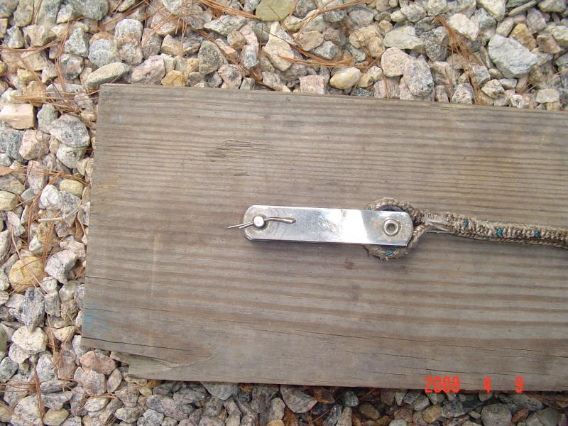

My pendant line is braid with an eye splice for a long shackle. The shackle pin connects to a 1/4" hole in the trailing edge of my Centerboard. My friend Ray has this same set up on his 1986 O'Day 26.
The sheave assembly fits into a small pocket way up in the keel slot. My 222 has a removable sole plate board in the cabin to gain access to the pocket where the pendant line pipe is connected and it resembles a hump which is actually the outside of the molded fiberglass pocket. You can see the strap and two nuts on top of the hump.
I can only guess that when they installed this sheave assembly at he O'Day factory, they may have run a strong twine into the pendant line pipe, then inserted the tag line into the sheave and used a long tool to get it up into the pocket after caulking the welded strap on the U bolt.
The sheave is kind of hard to see without a flashlight but you may be able to apply enough pressure on the pulley with the twine in order to turn it and make sure that it isn't broken.

If your pendant line is made up of wire and braid line, I would change that configuration to all braid with an eye splice for a shackle. The pdf that I have attached with the pictures shows that the hole for the shackle pin is 52" from the top of Ray's centerboard which is probably in the same area as the existing hole in your board.
I've never heard of the O'Day 26 having a wire/braid centerboard pendant line but I guess that anything is possible. As long as there is a small pocket up in the keel slot for the sheave U bolt assembly, there should be room for the shackle also.
If you need to change it over to a shackle, it is advisable to drill a larger hole and fill it in with epoxy and filler, and then drill a small hole in the center of the epoxy for the shackle pin which would be about 1/4".
