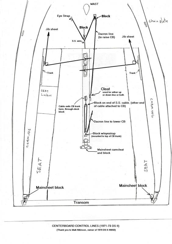

I have a customer who is rebuilding his 1970 O'Day Daysailer.
His swing keel rigging has been removed. I am trying to help him get it back together bust have not been able to find any diagrams on how the cables run. There is a pully system on the top of the trunk and a hole for the cable on the bow side of the trunk. If anyone can help me I would appreciate it.

Check the archives on this forum and you'll find the centerboard diagrams of the O'Day Daysailer. The guys have been posting them here for quite a few years.
If you're unable to find it in the archives, just Google O'Day Daysailer centerboard diagram and it will probably take you to a thread on this forum that contains a diagram.

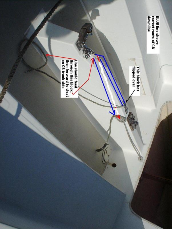

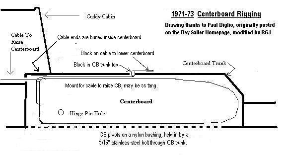

A few points;
1) if she has lines to control the CB (that's correct, Centerboard , NOT swing-keel) then this is not a 1970 model, must be 1971 or later (line-control CB is on The DS II and they were introduced as a 1971 model) Your description sounds like a 1971-73 model.
2) I have the diagrams! These are out of the Owners Manual that I have created for the DS II (1971-85).
