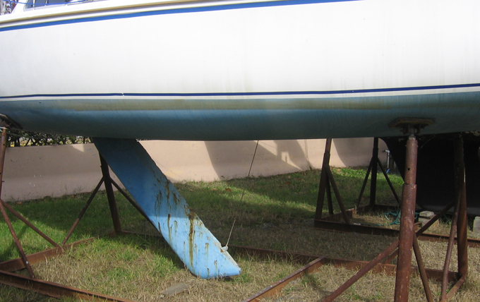

Keep a little tension on the keel cable, by letting the cable go slack you allow the top of the keel to stop against fiber glass. At this point you only have a couple points holding the keel in place, the keel bolts and the keel weight resting against the glass hull. A little tension on the cable will eliminate the metal up against the keel trunk and some of the weight will be carried by the cable, turing ball and winch. In this position I believe the cable will absorb much of the keel shock by it stretching rather than the keel bolts and keel trunk carrying the whole load.
The keel hangs back about 30 degrees from vertical by measuring one of Catalina’s own technical drawings of the keel. If the keel hung vertical the keel would react as a pendulum as you stated, oscillation would occur. Sailing up the face of a wave to an angle of 30 degrees the keel would become totally un-weighted and swing in the vertical, this is where the lock would help in adding a little friction to the weightless keel. 30 degrees is steep and 40 degrees is?
My boat off the trailer and elevated to a height high enough too allow the keel to drop the whole way down to this 30 degree angle the keel creates so much downward force that I can not physically budge the bottom of the keel backwards and I consider myself a little stronger than the average 160 lb. guy.
Sep 19, 2010
525
Catalina 22 home
<<The keel hangs back about 30 degrees from vertical>>
Ah ha, a key point. Some smart engineer did that on purpose! By resting the keel at that angle, it is always pre-loaded with probably about 200 pounds of its weight for stability. I should not have to worry in the moderate weather I encounter. If I ever experience 40 degree pitch I still won't have to worry, I will have died of fright prior to the keel breaking off!
