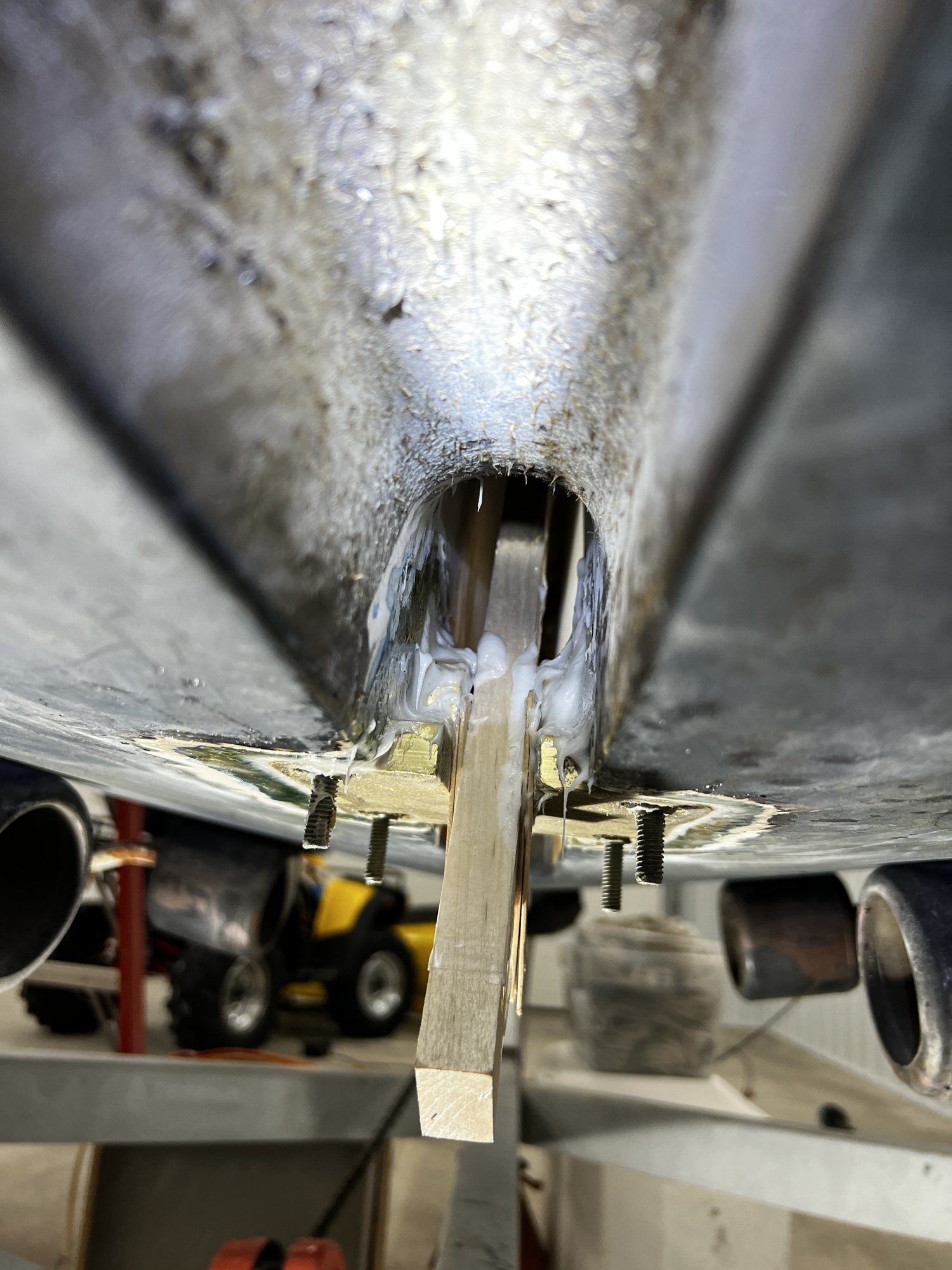

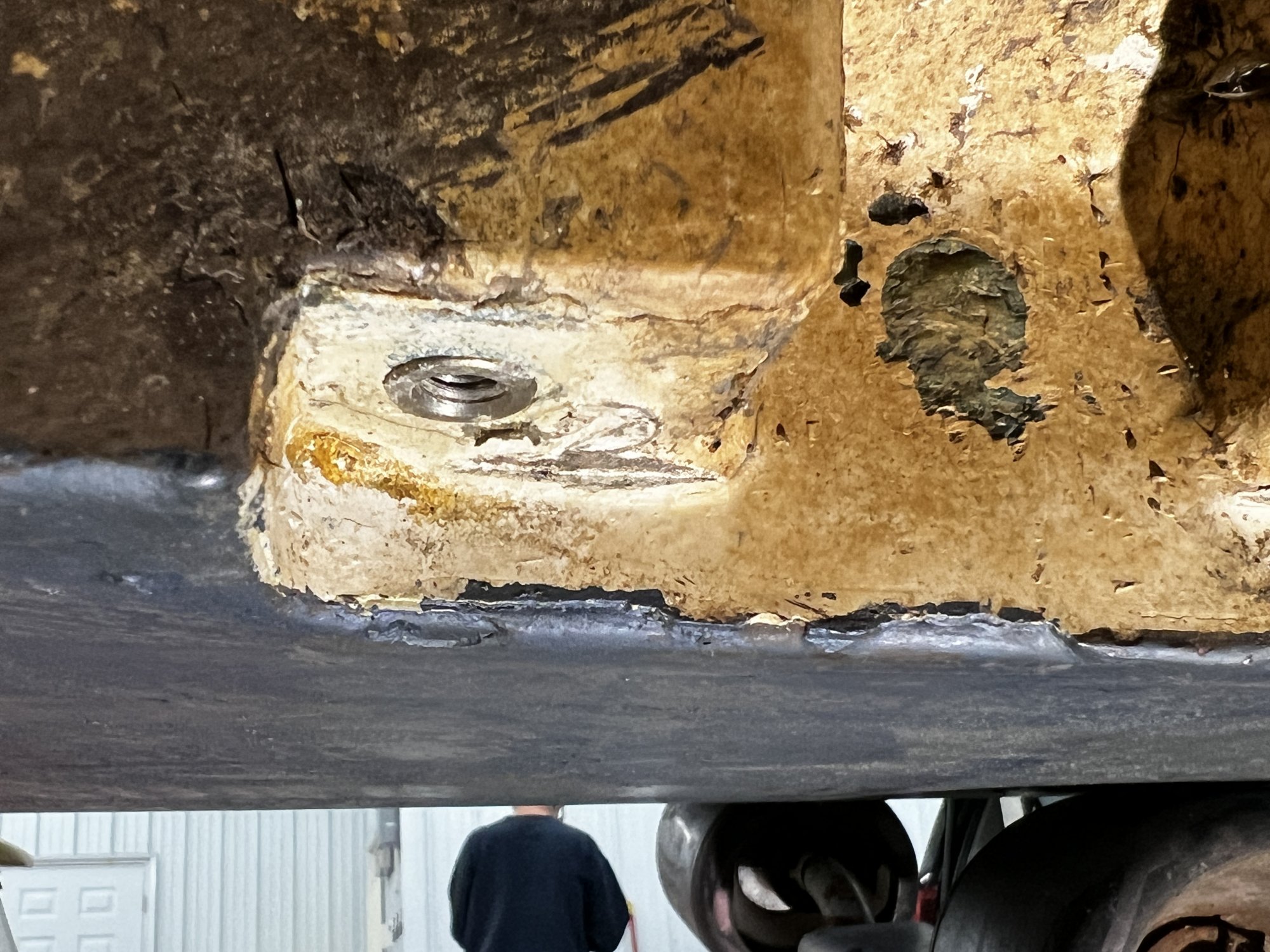

Anyone run into swing keel fittings not seating completely? Boat had fitting installed upside down (pin below the boat) so the counter bore would provide relief for the weldments that protrude slightly from the fiberglass. Installing the fitting right side up would cause them to touch the weldment before seating to the fiberglass.

Thinking to lay in a layer of thickened epoxy to create solid base for fitting to clamp to.

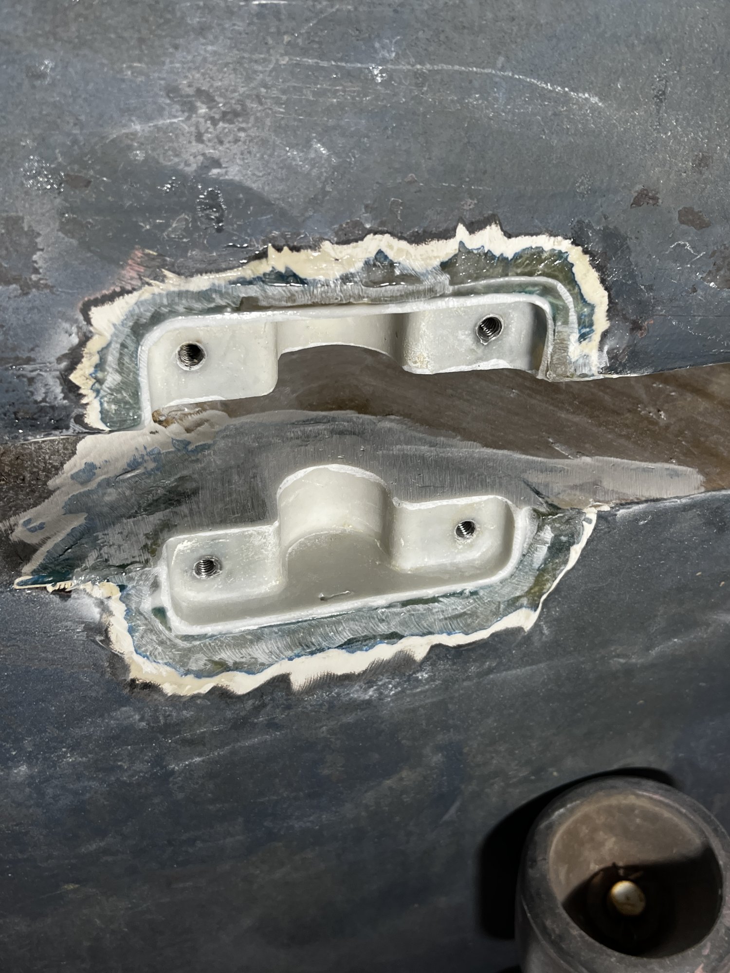

I called CD Tech line. They weren’t able to offer any suggestions. I’m going grind hanger pads down to clean fiberglass then build new pad surface with thickened epoxy. New hanger fittings will provide a true and solid ‘mold’ when bolted on place while epoxy cures. Challenge will be to get a good release.

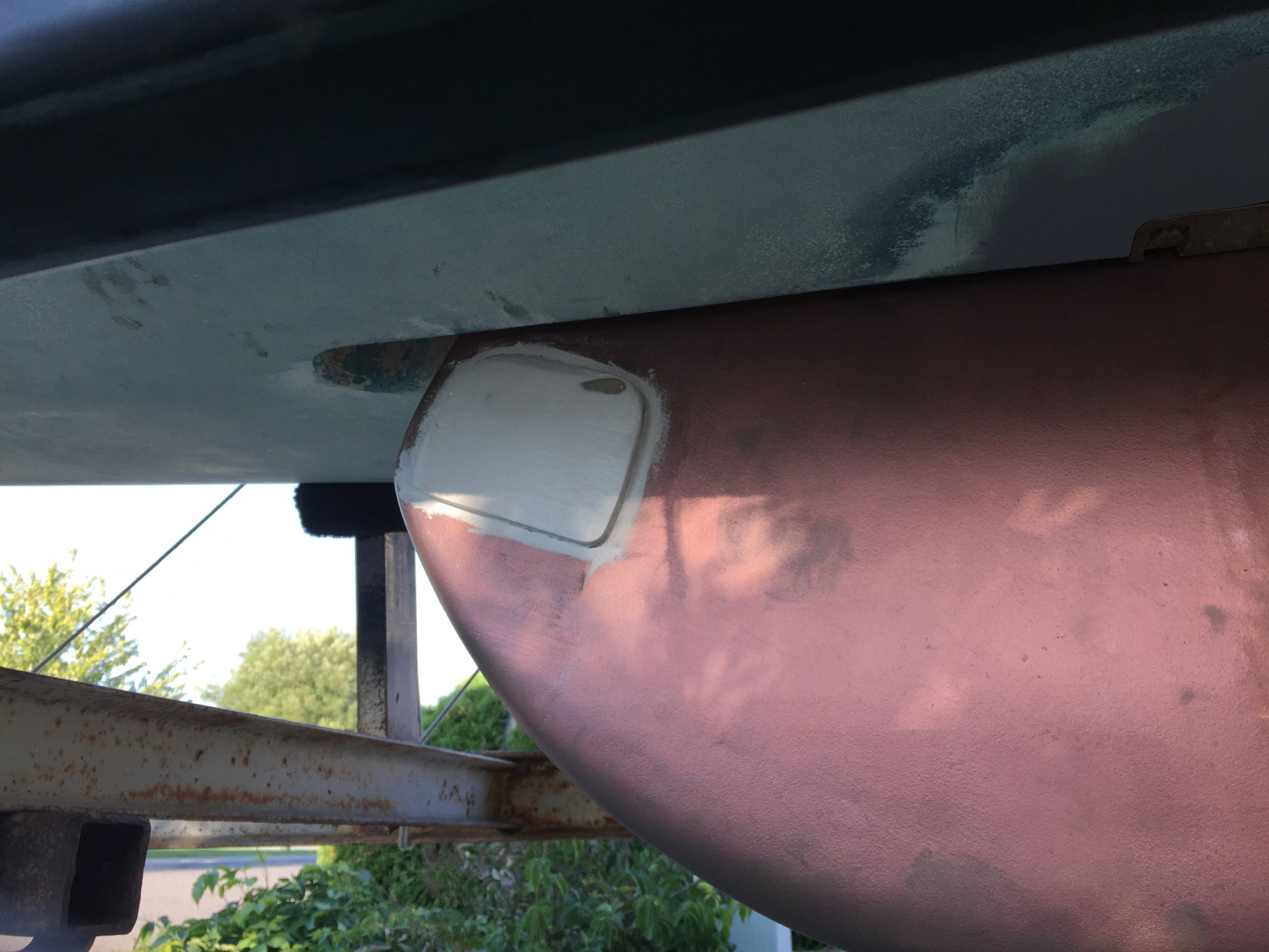

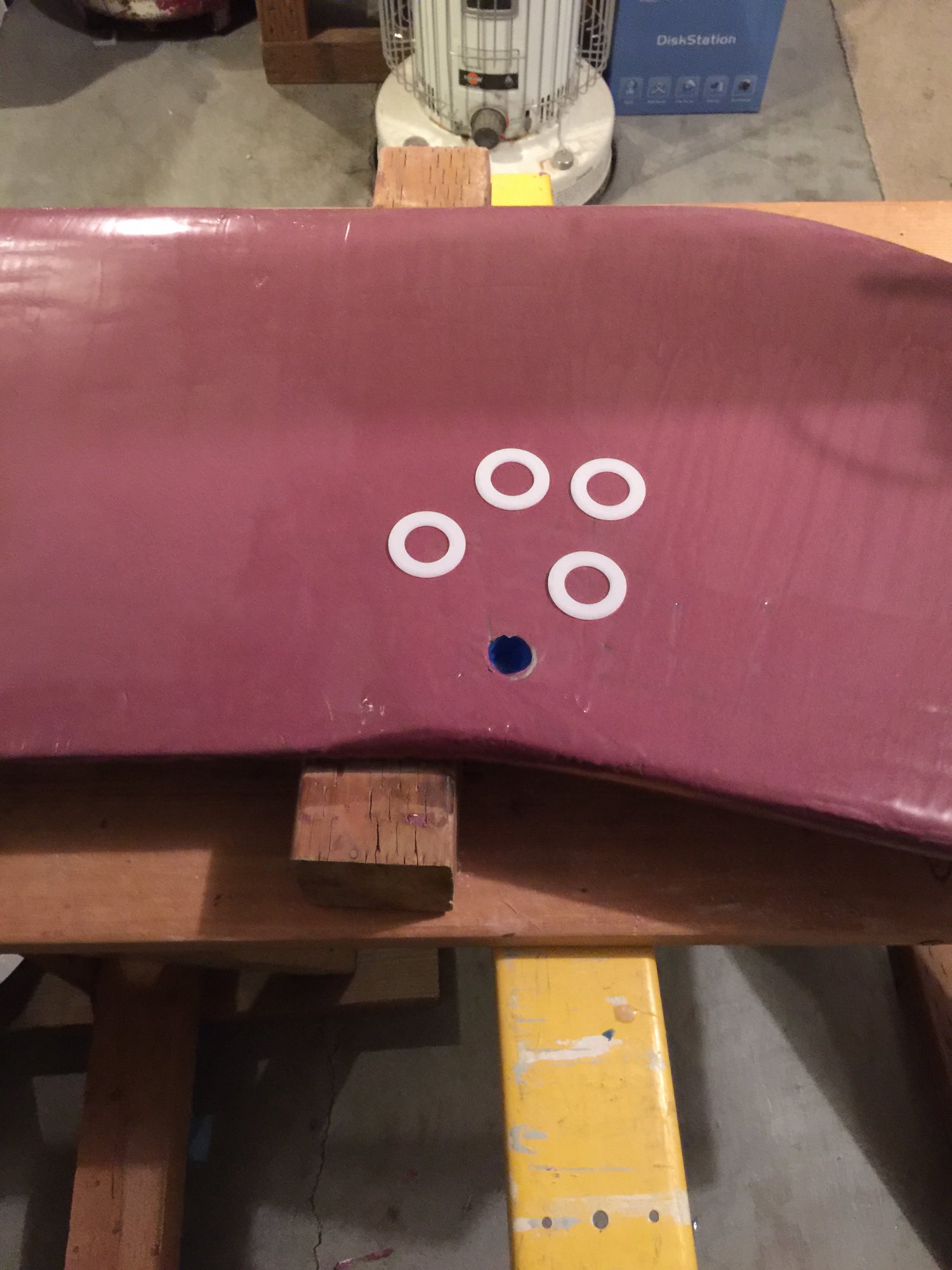

Have had zero reason to revisit since installed — rock solid and wouldn’t change a thing. PITA but worth it — like others I shimmed the pin with 1/8 Delrin and used homemade spacers for the head of the keel —no-centering issues , I dry fit the head spacers carefully — just snug but not tight
added some pics for the spacers-- you can see the primer rub: white to bare glass. Each side custom depth for the gap.

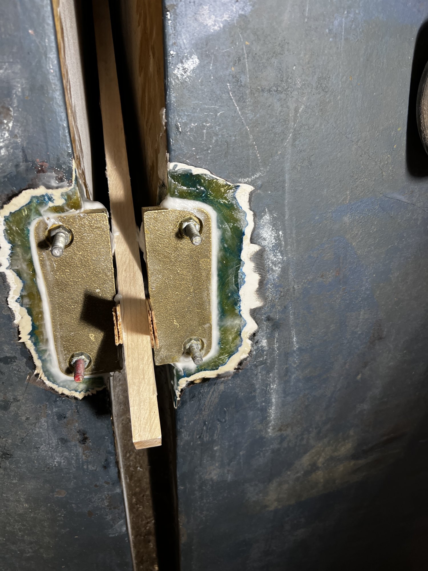

Ground out the gel oat, found some voids and loose polyester. New hanger fitting were cleaned up, polished and waxed this mold release. West 105, 206, 404 mixed to fat free peanut butter consistency. Bolted up fittings, centered, and set flush to bottom of boat + 1/4 turn on the nuts. Letting cure for 3 days before attempting to pop the fittings out.

Looking good — what’s your ambient temps? 24 hours should be plenty— I hope that 404 doesn’t cause you any grief — it may be a bear to sand in tight places. No doubt it will be stronger than the boat ;)

It’s in a temp controlled shop. Fittings are about 75F. It will be fun to clean up. But at least got it glued up and didn’t epoxy falling on me.
