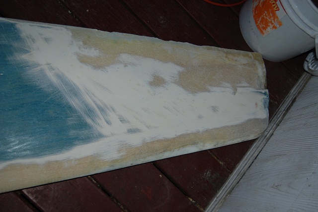

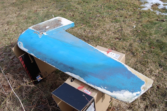

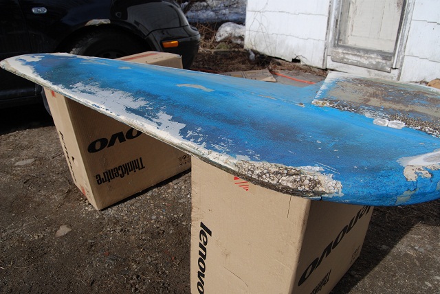

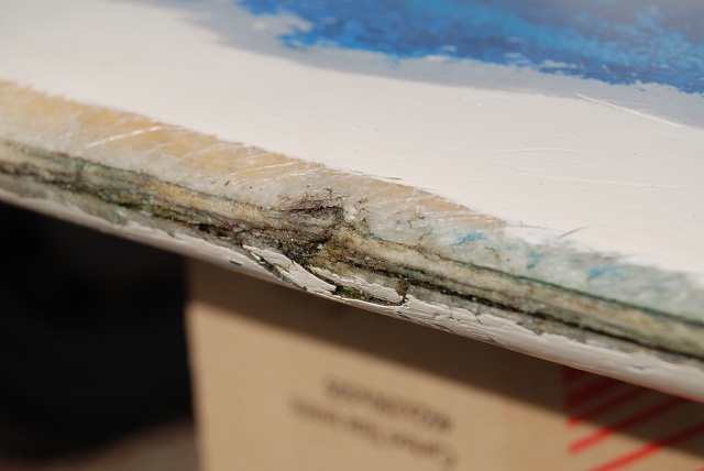

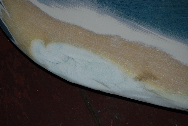

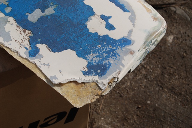

With the nice weather this weekend, I got to the marina and pulled the keel off my 1983 Hunter 22. It was really loose so I figured that the nylon bushing had worn and will need replacement.
Removal was straightforward since the boat is on blocks & stands in the yard and not on the trailer yet. Better to do it now than this summer when I am keeping it on the single-axle new trailer.
So I've taken a bunch of photos of the keel and I'm thinking about how to proceed. It looks to me like the bushing may have already been removed and replaced. I just bought this boat in November, and the previous owner said that she had a total refit in 2003. So it's possible that the person also replaced the nylon bushing at that time. The reason that I suspect this is because one of the sides of the bushing hole looks like it has broken resin in it. I am thinking that when the keel was new that the bushing was fiberglassed in on both sides and that no resin would have been used unless a repair had been done. Maybe I am wrong on this. I'm attaching a photo here that shows the resin.
