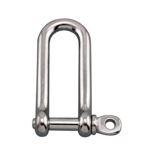

On my clipper, I was able to swim below (although it was thanksgiving on the Potomac and about 55 degrees). What I ended up doing was getting a stainless steel winch cable from I think bass pro (it's a 1/4" stainless that was designed for a trailer winch) it had an eye on it. I found a long D stainless shackle and fed the cable up from the bottom to a friend and I hooked the eye to shackle and made the connection to the cast iron swing keel. I don't know how that would work on the Mac keel.
Just don't drop the shackle pin when swimming below. Have a spare.
I'll need a few spares. <grin>
