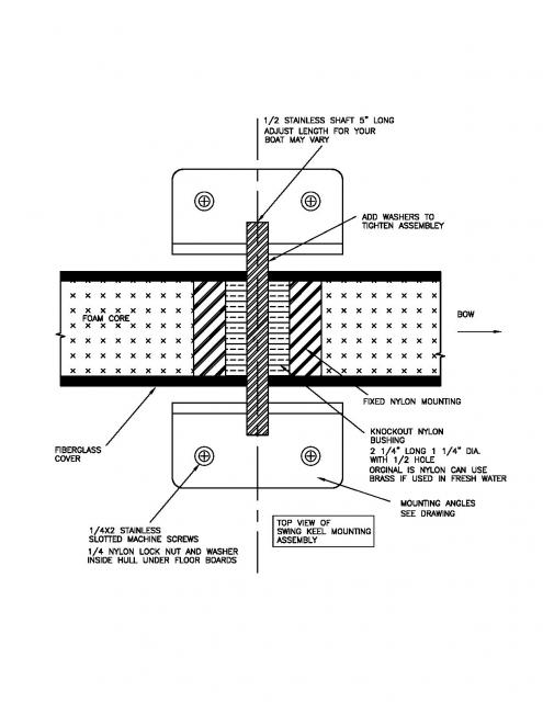

L Larry D Calander . May 2, 2014 76 Hunter 26 Home port Cape Coral Dec 5, 2014 #1 Need a bracket for Hunter h26.unbelievable that mine is gone. Swing keel bracket that is. Thanks in advance Larry
Merlin Clark . Oct 26, 2005 2,057 - - Satellite Beach, FL. Dec 7, 2014 #2 Larry D Calander said: Need a bracket for Hunter h26.unbelievable that mine is gone. Swing keel bracket that is. Thanks in advance Larry Click to expand If you can't find them you could have them fabricated. These drawings are for a H22 and would probably need to be adjusted to fit: Attachments Hunter 22 -- swing keel 01.jpg 23.3 KB Views: 157 Hunter 22 -- swing keel 02.jpg 36.7 KB Views: 143
